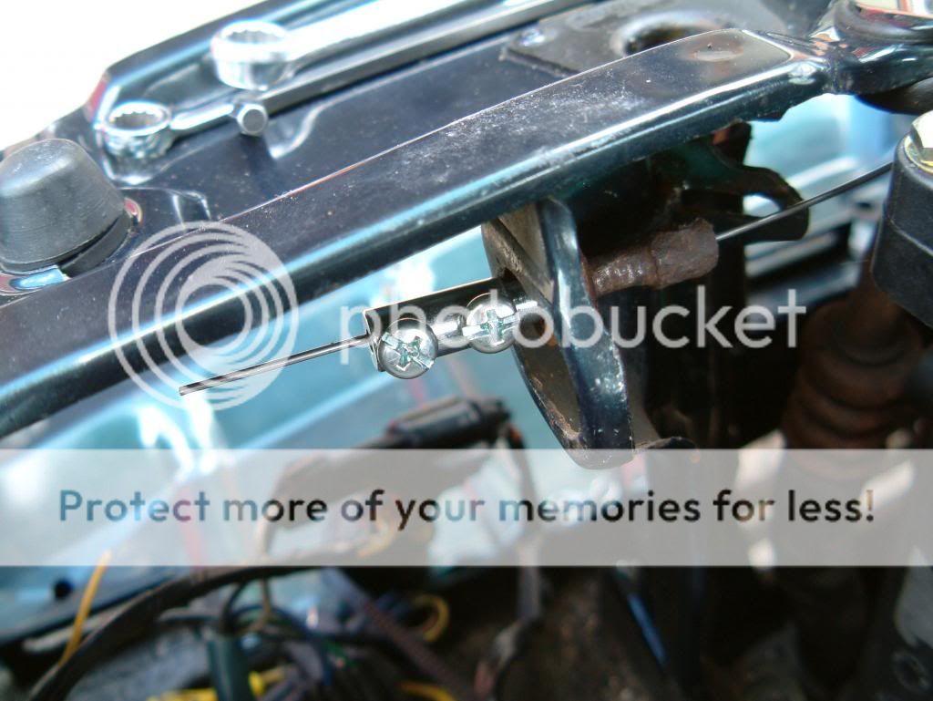

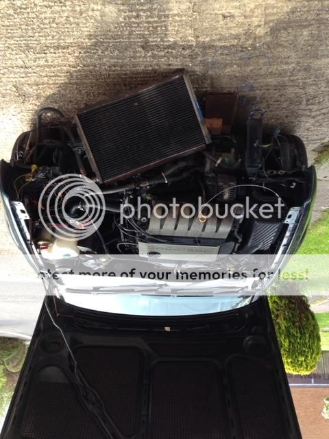

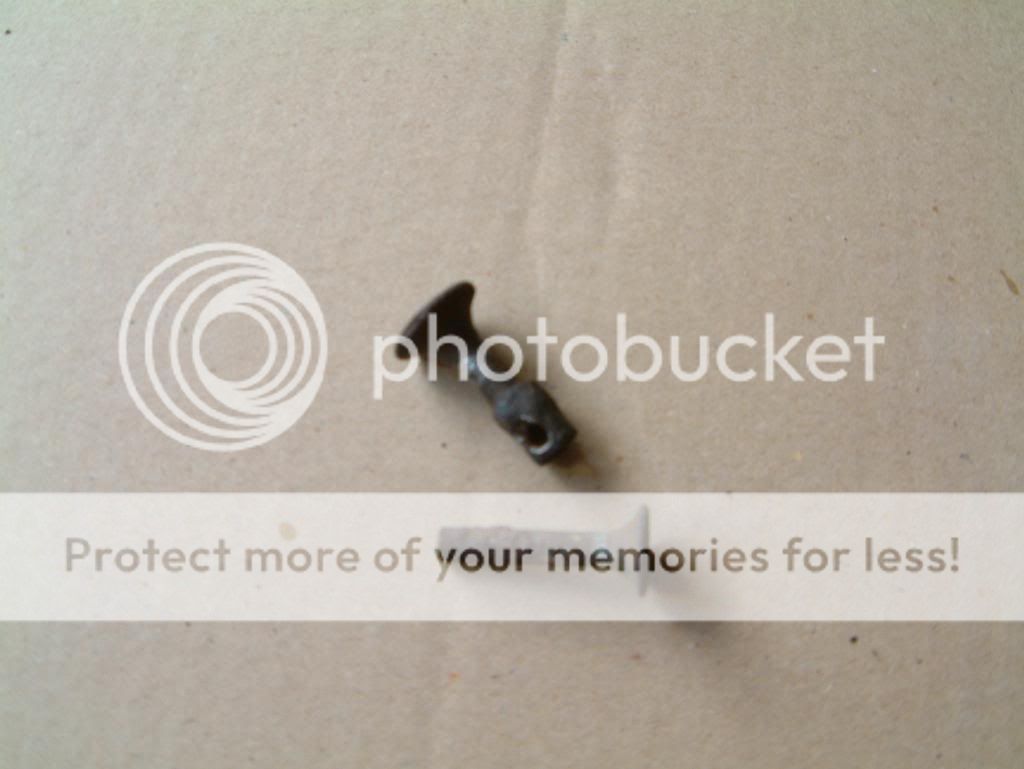

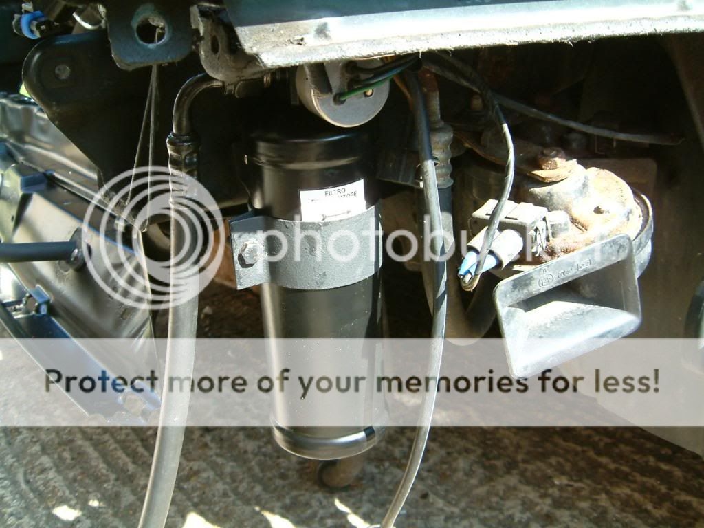

Dan_Storm 0 Posted August 4, 2013 I got the 2 new oil cooler hoses, so drained the coolant, removed the radiator for better access and swapped them over. The old ones weren't too bad, but there were a couple of tiny splits that must have been the cause of the leak when the system got some pressure in it. I set about putting the front end back on. My bonnet release trumpet with the bolt had sheared, meaning I had to drill it out: So, to hold the cable in place I improvised with a cable stop, which works really well: Once the front end was on I started up and let the temperature build. Thankfully there were no more leaks :) I got stuck in a traffic jam last night for 20 minutes and temperatures didn't go over 100. Overall, the running temperature seems to be lower than it was before, it now sits at or below 90 on the motorway now. Quote Share this post Link to post Share on other sites

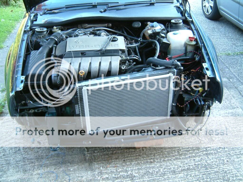

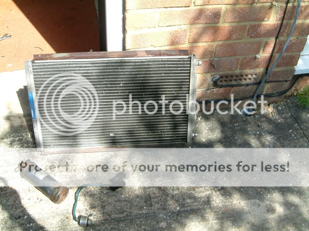

Dan_Storm 0 Posted May 5, 2014 I got a mobile AC guy round to check for any gas in the system - there was none. He then put pressure in the system, it held the pressure so there are no big leaks. I suspect a slow leak from a duff o-ring caused the loss of gas. So, old condenser and dryer are now off. I am looking for new replacements and will fit with new o-rings all round. My oil cooler wasn't looking too healthy, so I have ordered a new one. I have the Roose Motorsport hoses on, they fit very nicely. I still have a few bits to sort out, but hope to start putting the rest of the car back together next weekend. Looking forward to getting it running again :) Quote Share this post Link to post Share on other sites

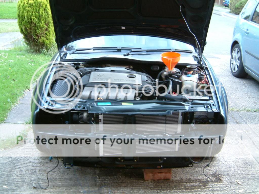

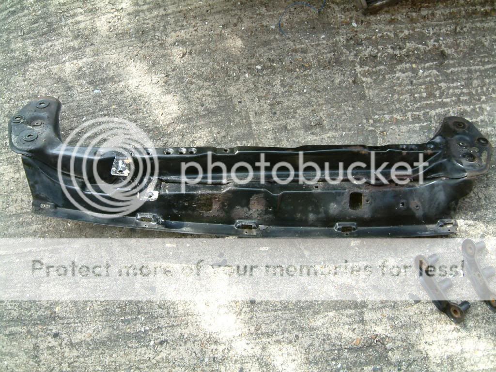

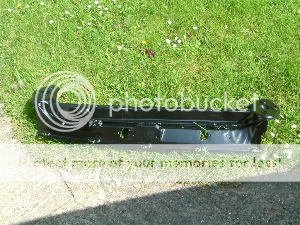

Dan_Storm 0 Posted May 18, 2014 I got the parts back from the powder coaters. I am pretty pleased with the results, here is the radiator support before: and after: I've now fitted the following: New sump gasket New oil cooler Oil pressure senders RooseMotorSport hoses and new clips all round New thermostat housing and new black/green sensor (the rest were new last year) New condenser and dryer. I also repalced all o-rings for the AC system I could access. New plastic fan guides on the fan support Loads more I can't remember and loads of new screws, bolts and nuts. I also rubbed down the rusty spots on the slam panel and re-sprayed. It's not a perfect finish, but not a problem as it's not visible. I did the same to the bonnet stay, again it isn't a perfect finish, but better than the rust that was there before. I managed to source the exact same condenser part number from ReaderAir, so fitting was nice and easy. I couldn't find a dryer with the same part number, but got one with the same dimensions and fittings. It looks identical to the old dryer. New AC Dryer: I ran out of time today, but nearly have it back together. I am hoping to have it running again tomorrow. Quote Share this post Link to post Share on other sites

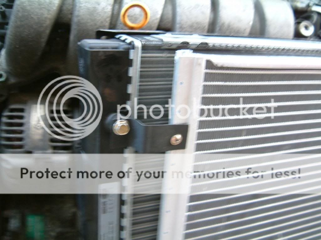

fla 9 Posted May 18, 2014 good progress there. The rad support looks excellent. Did you use the same frame for the aircon condenser - with the rivets onto the rad? I've replaced the rivets with two shim plates and bolts as there was some galvanic corrosion on the rad, but as yours is all fresh i would be keen to see how you have fixed it on. Quote Share this post Link to post Share on other sites

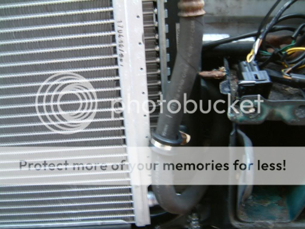

Dan_Storm 0 Posted May 19, 2014 Hasan, Sounds like your's is fixed a bit differently to mine (guess it depends on which dealer fitted it). Mine has a strip of metal that screws into the bottom of the condenser. The strip of metal has 2 lugs that sit into the holes on the radiator support. The only thing holding it at the top is a p-clip, so I am going to try and make up a bracket for a bit of extra support. I can get some more photos if it helps. The metal was pretty badly corroded, so I rubbed it down, treated it to some Kurust and coverd it in stonechip. Quote Share this post Link to post Share on other sites
fla 9 Posted May 19, 2014 thanks Dan, that would be great. Mine also has the lugs at the bottom but the top is/was rivetted into the radiator. Quote Share this post Link to post Share on other sites

Dan_Storm 0 Posted May 23, 2014 Hasan, On one side of the condenser I have a P-clip that holds the condenser in place. Looks a bit flimsey, but it held it in place on its own: I made a bracket for the other side for a bit of extra support and to stop the condenser/radiator vibrating against each other. Doesn't look too pretty, but works fine. Obviously, I have the lugs at the bottom of the condenser that sit in the radiator support panel (sorry the photo's are blurry). I've got everthing back together and been using the Corrado for the last couple of days. All seems good, temperatures are good and no water leaks. I still have a bit of an oil leak though :( I need to take a proper look, but think it is coming from the oil filer to block housing. Annoyingly that was one of the few seals I didn't replace. The leak isn't too bad, so it can probably wait until the next oil change. Next step is to get the aircon gassed to see if it works. I'm enjoying having it on the road again :) Quote Share this post Link to post Share on other sites

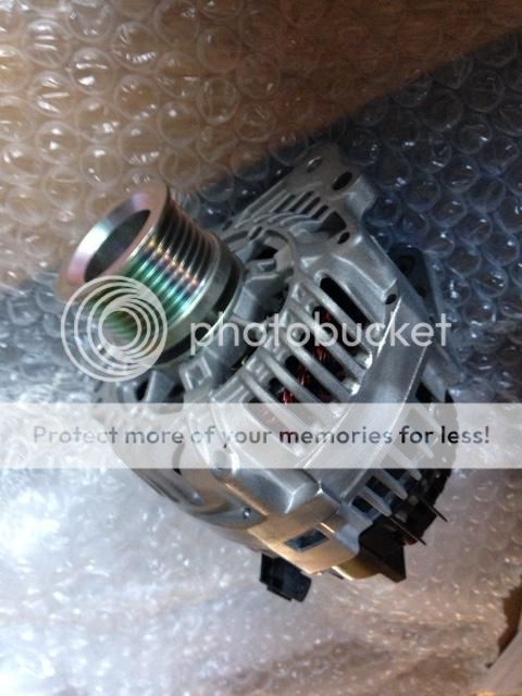

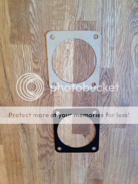

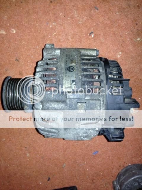

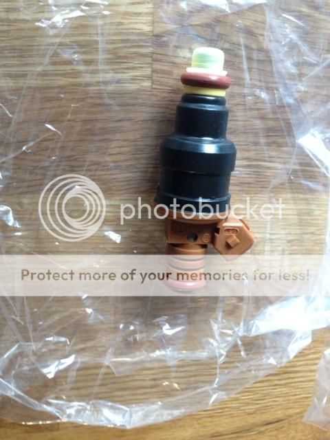

Dan_Storm 0 Posted January 21, 2015 Progress has been slow, but I now have the new starter motor and radiator sensor fitted. As the project was dragging on and because I had easy access I decided to get the alternator refurbished. The alternator came off looking like this: And came back from being refurbished looking like new: The injectors also came back looking great: It appears that the throttle body to intake manifold gasket is no longer available, so I made up a new one from gasket paper: I went to fit the new fuel hoses, but found out I had been sent 7.5mm hose not 8mm as I had ordered :( Demon Tweeks wouldn't replace the hose because I ordered it back in November. I have since ordered 8mm elsewhere, I am just waiting for it to be delivered. I hope to make more progress this weekend if the weather improves. Quote Share this post Link to post Share on other sites

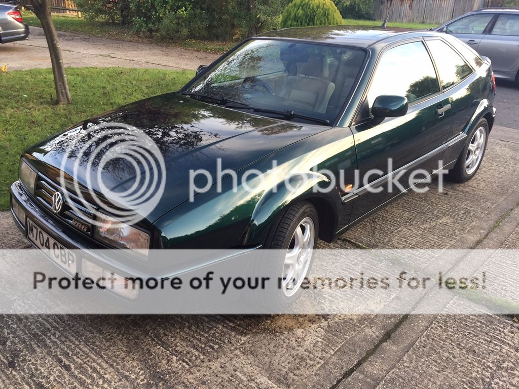

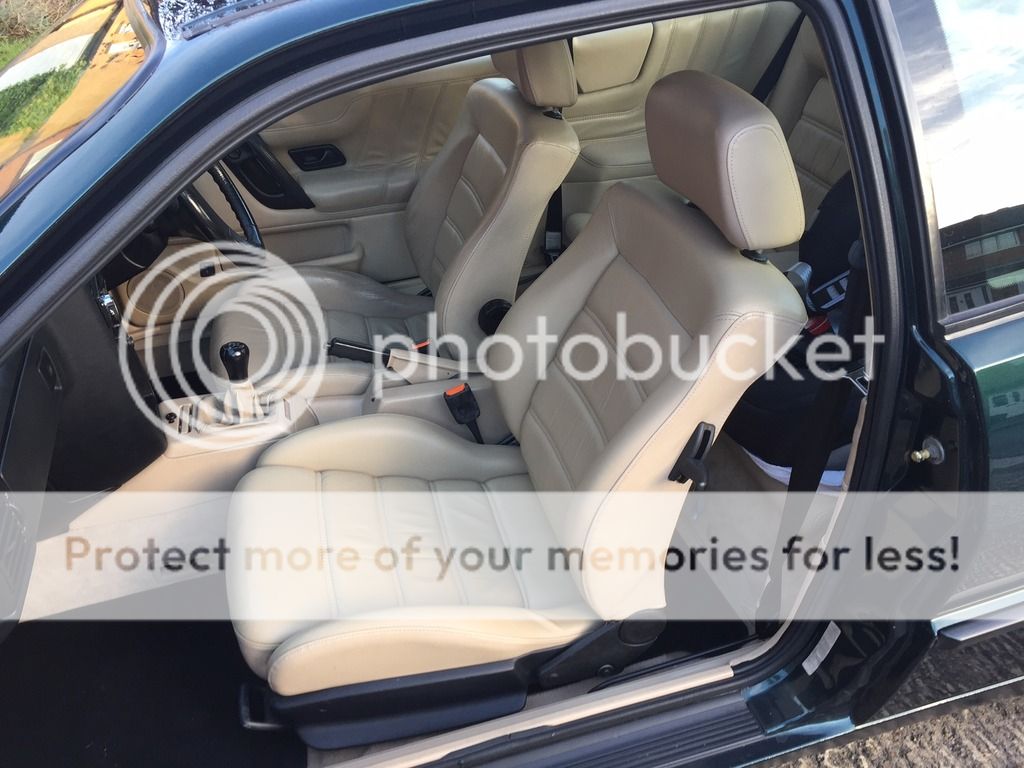

Dan_Storm 0 Posted October 22, 2016 Been a while since I updated my progress on here! I'm pretty pleased with how the Corrado is looking now following a front end respray and a repair to the small rust spot on the rear window. I also stripped out the interior and gave all the leather and carpet a good clean. I re-dyed the passenger seat using a kit from furniture clinic. It's not perfect, but looks almost like new. I need to re-dye/refurbish the drivers seat in the near future as it is looking very tired. I'm hoping to see if I can find a solution for the bolsters at the same time. I completed lots of small jobs while the interior was out including replacing the blown front speakers and fitting a small Pioneer under seat sub from a previous car (I installed it in the boot). It is sounding a lot better but the rear speakers are blown and need replacing too. I still have a long to-do list, but the Corrado is looking pretty tidy now. I've had quite a few compliments including the body shop and MOT test centre. Quote Share this post Link to post Share on other sites
