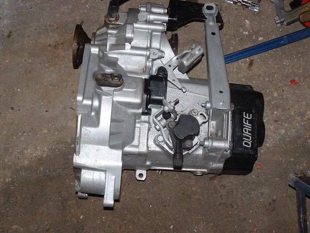

Kevin Bacon 5 Posted August 7, 2008 Dub20vt said: I've run a Quaife syncro 6speed kit with turbo power since 2001 with no problems, engine dyno plots showed 317bhp + 357lb/ft no problems as yet (crosses fingers). and you also get the lovely straight cut noise in every gear too :D (unlike a lot of the Gemini kits that are still available, mostly 3-6 kits). I didn't know Quaife did a straight cut box for the 02A/J? Straight cut boxes are usally dog engagement and you won't find many of those in a road car. The slower you drive them, the more they wear..... The Gemini is semi-helical (like the current selection of Quaife boxes) and as for the noise of straight cut being desirable, I think that's a matter of preference. I hate it personally. Quote Share this post Link to post Share on other sites

Kevin Bacon 5 Posted August 11, 2008 You'll get noise from semi-helical mate and if you want more noise, fit a poly gearbox mount, or Vibratechnics competition :D Straight cut doggie style sounds like your grandma mashing cogs in the Sainsburys carpark. They need revs. Quote Share this post Link to post Share on other sites
