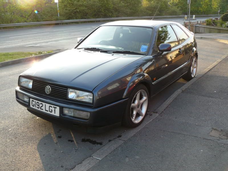

Walesy 0 Posted May 27, 2008 I plan to respray the car anyway, so cost isn't much of a factor.. I just assumed it would look weird with early wings? Anyway, pics might help ;) *wink wink* I've got no pics of a C with late bonnet/early wings as i've not seen one, going by what davidwort says though you'd need to get a pair of wings and a bonnet before you go for paint. Here's a couple of pics of a late C with one early wing, I assume that having 2 early wings makes it stand out alot more! :) Quote Share this post Link to post Share on other sites

Walesy 0 Posted May 27, 2008 Just found a better pic of a bit of panel gappage :) Quote Share this post Link to post Share on other sites
Dec 1 Posted May 27, 2008 One of my old valvers with a late spec bonnet. Not the clearest in the photo, but the bonnet match from the front edge back to about 15cm's didn't look right at all! Further back the match was ok though. The front edge of the late spec bonnet sits further forward than the early slam panel, so the bonnet lip doesn't match with the top of the headlights/grille. And the front of the late spec bonnet is far more curved than the early spec bonnet, so there is enough of a panel gap to get your little finger in! :pukeright: Looked a bit of a mess imo, and there is no way I'd be fitting one if you were going to be getting a nice full respray! :salute: Quote Share this post Link to post Share on other sites
n3p 3 Posted May 27, 2008 Thanks Dec 8) I can actually see that picture! No offence to your corrado of olde, but the bonnet does indeed look rather odd ; EDIT: can't see the picture now Quote Share this post Link to post Share on other sites
n3p 3 Posted May 27, 2008 Well I can see the pictures now :). The nugget one looks good from a distance actually, but the up-close gappage is kinda :(. The lighter colour hides the hump a little bit more than Dec's grey one. I'm slowly warming to inverted bonnets :luvlove: Quote Share this post Link to post Share on other sites
