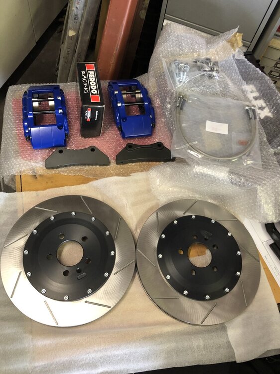

1xshaunx1 27 Posted December 21, 2022 On 12/21/2022 at 7:49 PM, ABV-VR6 said: Oh man, this looks good! Are those rotors 312? With 6 pot calipers, you'll need 17" wheels? 335. just enough room on the bbs. Should have gone 310mm As above if you make an firm enquiry about a specific set up they send you a printable scale pdf of the disc and Caliper, print it off stick it to some cardboard, cut it out and put it to the inside of your wheel. Takes all the guesswork out of it. What I didn’t take into account was if you have split rims on 17” you are left with 16” cast clearances, so I’d have been better in the long run with 310mm Quote Share this post Link to post Share on other sites

ABV-VR6 12 Posted December 21, 2022 On 12/21/2022 at 8:11 PM, 1xshaunx1 said: I thought you’d got all new brake callipers and lines on the front already I did, went with just a step above using DE set-up. They are super heavy as well. But that's all I could fit under my Schmidt modern line. I have some BBS LM's coming at one point from Japan. Thinking of upgrading. Those 6 pots of yours, are they the Monster version? And do they have dust boots? Quote Share this post Link to post Share on other sites
1xshaunx1 27 Posted December 21, 2022 Mine are monster 6 pots, yes they have dust boots, all their road versions have them, only their race versions don’t. You are probably better off waiting until you get the wheels to see if the hispecs fit. I’ll send you the template for my set up and you can try it on your Schmidt wheels. Off set of the callipers will be the same, but obviously the callipers will come in 12.5 for the smaller disc Quote Share this post Link to post Share on other sites

ABV-VR6 12 Posted December 22, 2022 Just to confirm my last thoughts, hopefully! When you guys swapped to larger 310/312 rotors. You do have to install carriers that were meant for those disks (TT, 337,Gli) right? And that adapter/shim provided by HiSpec is to recenter the caliper with the new rotor width? That adapter/shim goes between the carrier and the knuckle, correct? Cheers! Quote Share this post Link to post Share on other sites
1xshaunx1 27 Posted December 22, 2022 The adaptors are the carriers. They are the grey things below the callipers in my photo of the kit, you replace the carriers you have on with those and then bolt your calliper to that. If you buy their kit you only need brake fluid. Quote Share this post Link to post Share on other sites
ABV-VR6 12 Posted December 22, 2022 On 12/22/2022 at 7:02 PM, 1xshaunx1 said: The adaptors are the carriers. They are the grey things below the callipers in my photo of the kit, you replace the carriers you have on with those and then bolt your calliper to that. If you buy their kit you only need brake fluid. Oh!! That's pretty cool! It means that I don't even have to buy larger carriers then, that's great! Probably save a good amount of weight as well. Thank you for explaining how it works. Cheers mate Quote Share this post Link to post Share on other sites
