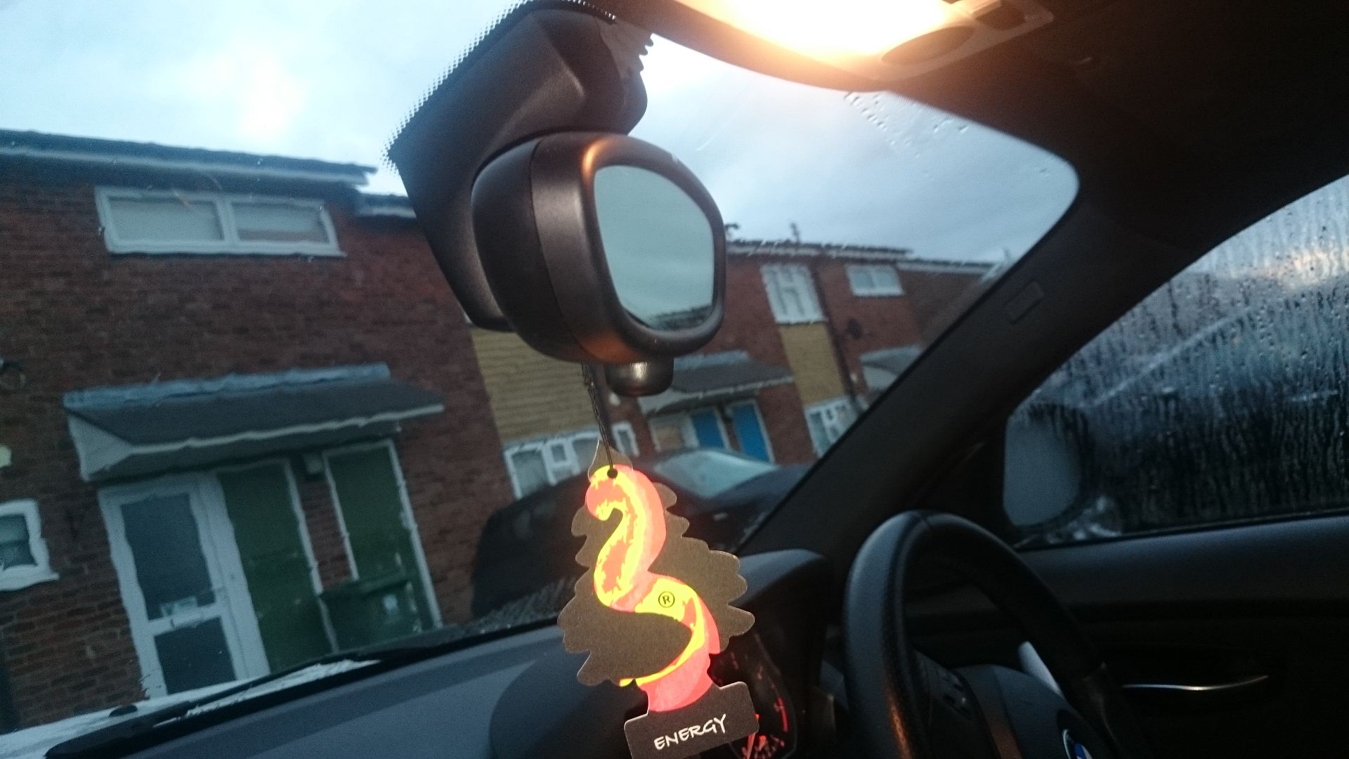

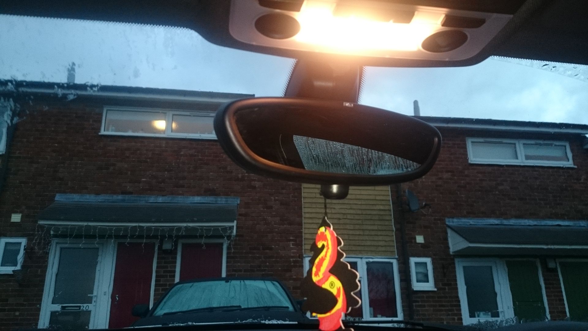

seanl82 23 Posted December 31, 2014 Here you go Sean. Just been out and snapped a couple of pics for you. Interested to hear about this. Quote Share this post Link to post Share on other sites
Sean_Jaymo 0 Posted December 31, 2014 (edited) Does it have a rubber gasket between the plastics and the screen Sean? I wonder if they do it in a non windscreen wiper form? That would keep the plastic size down. I've changed my metal screen mount to a BMW version so hopefully they keep it the same between all their vehicles! Edited December 31, 2014 by Sean_Jaymo Quote Share this post Link to post Share on other sites
seanl82 23 Posted December 31, 2014 I'll check later for you mate, wife's gone to work in it now! Quote Share this post Link to post Share on other sites
KipVR 1 Posted December 31, 2014 Thanks for the pics Sean, does the one series com without rain sensing wipers? I can remember looking into the options years ago and I went for the e46 one but I can't remember exactly why, but it might have been cause of the rain sensor. Quote Share this post Link to post Share on other sites
seanl82 23 Posted December 31, 2014 Bugger, sorry guys I completely forgot. In Plymouth with the Corrado now so won't be back to the Bimmer til Saturday night. I'll check for you then Sean. kip, ours doesn't have rain sensing wipers, although I'm not sure if theyre all equipped with the function tbh? I'll get some dimensions if you like too. Quote Share this post Link to post Share on other sites
KipVR 1 Posted January 2, 2015 Thanks Sean that would be brilliant! Quote Share this post Link to post Share on other sites
GrahamU 6 Posted January 3, 2015 (edited) been looking at these mirrors lately and the peugeot auto dim look quite small http://www.ebay.co.uk/itm/221626762821?_trksid=p2060778.m1438.l2649&ssPageName=STRK%3AMEBIDX%3AIT I'm just waiting for an answer from the seller for the width of it amd they seem to be cheap :) oops, link changed to be pug 307 mirror Edited January 3, 2015 by rado20vT Quote Share this post Link to post Share on other sites
seanl82 23 Posted January 4, 2015 Got some dimensions, all approximate. The base is H90 x W70 x D40 increasing to 80mm at the bottom where it curves outward. Mirror itself is H75 + 15 for the alarm light at the bottom x L230 x D38mm. The screen is at quite a sharp angle like the corrado, and the bottom of the base to the flat face of the mirror is 100mm. Sean, I couldn't see a gasket between the base and the screen, although there is a slight gap between the two so its possible. I didn't want to attempt to remove it as there's no obvious grub screw or anything so think it clips into place. Obviously don't want to try unless I have to for fear of breaking it! If theres anything else you need let me know. :thumbleft: Quote Share this post Link to post Share on other sites
Sean_Jaymo 0 Posted January 4, 2015 Cheers mate, I was only seeing if there was a gasket as the standard screen masking on the Corrado is small and if that is the only shaped Base for the 1 series, I didn't want to be able to see into the case from outside of the car. If for any reason you ever want to remove it. It's held on with a spring clip. SIMPLY rotate the body of the mirror 45 degrees anti clockwise and it should pop off. The plastic behind should be in 2 halves which should simply pop apart so you can access the plug. Quote Share this post Link to post Share on other sites
