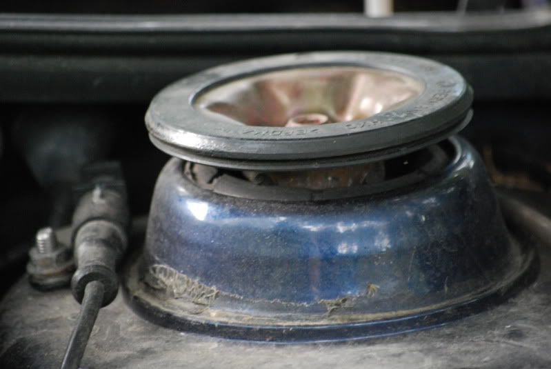

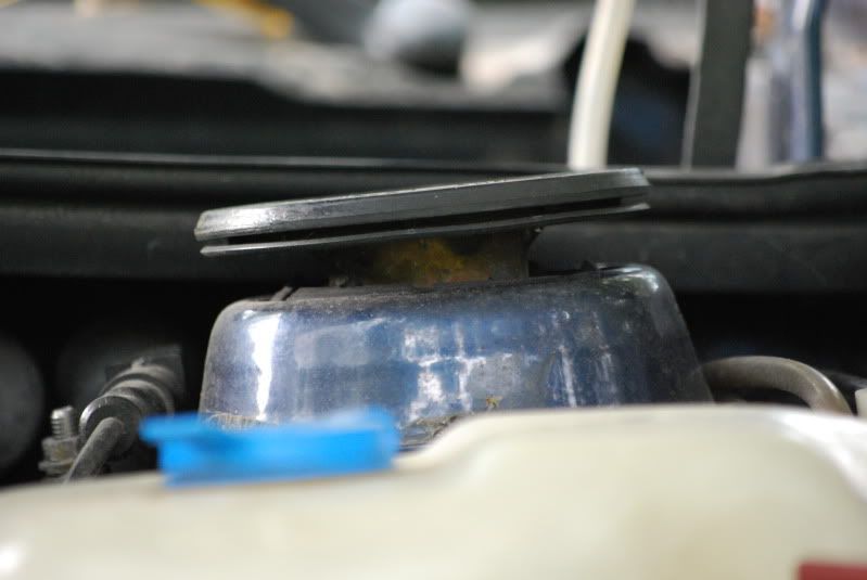

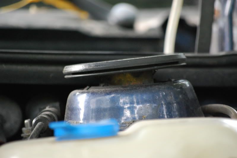

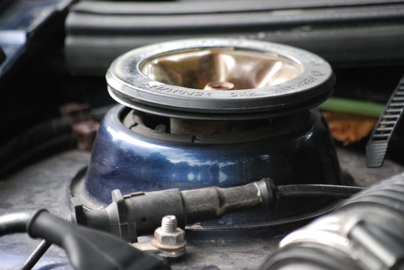

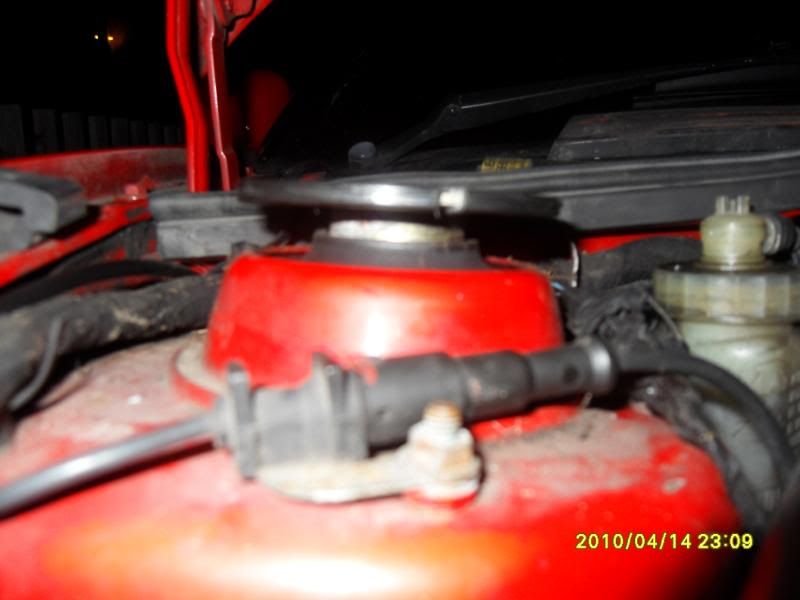

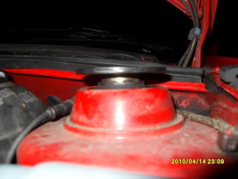

Hurd this knocking earlyer whilst driving home
opened the bonet to have a see what it is and took the top mount to find this :(
Drivers side
Passenger side
so could anyone tell me the best top mounts to buy for my 9a corrado would it be g60 or vr6??
You just need the standard ones for your car which are the later 'VR6' type - make sure you buy genuine VW ones as these seem to be the only ones that last!
Pointless really as the rubber bit of the standard mount isn't the bit that wears out. The bearings are the weak part and no one does uprated bearings.
hmm I guess this solves the damn knock I have been hunting for the last two evenings

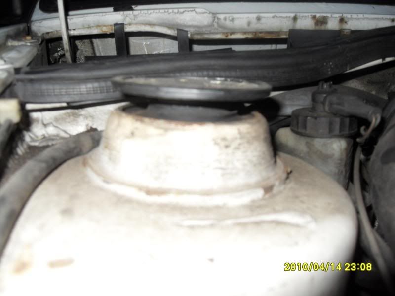

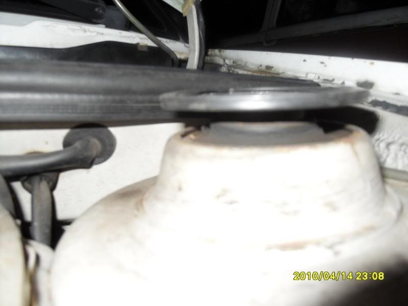

first off 5 year old dead mounts on the golf lol but they dont knock lol
drivers side
passenger side
now the raddo 600 mile old mounts :(
drivers side
passenger side
gonna nip vw and see how much they are from them as these are from one of the 2 big parts places for french and german cars and are crap :mad2:
