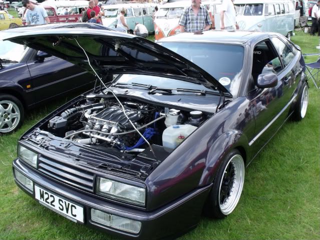

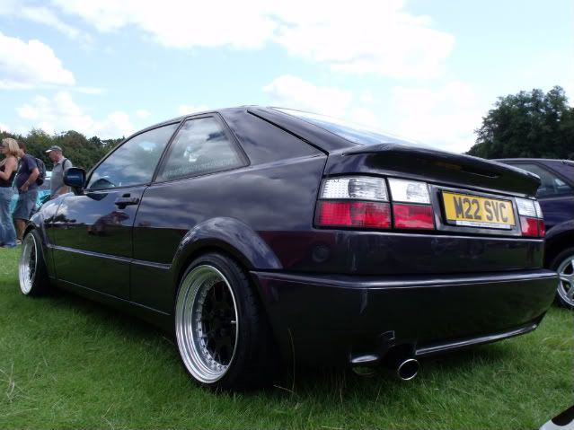

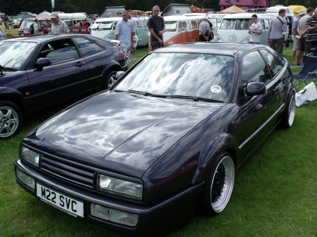

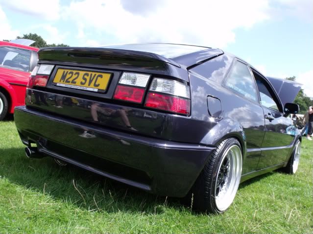

samthegram 10 Posted August 10, 2009 Got my wheels re-sized now so the rears are 8.5j with 205/40/16 and look perfect. It was interesting to do as i stripped down the old 7's , cleaned them up then re-assembled them using standard black silicion sealant. I bought some second hand compomotive 5" barrels from wheel whores and they fitted perfectly. It was a nice sense of acheivement when i picked them up from the tyre fitters and they said that they were not leaking :clap: Here are some piccies from Tatton Park yesterday, gleaming in the sun. Cheers to my mate Sean for taking the shots. Quote Share this post Link to post Share on other sites
zak 0 Posted August 10, 2009 looks amazing, great work Quote Share this post Link to post Share on other sites
Kempy 0 Posted August 10, 2009 looks great, any issues with rubbing on back? Quote Share this post Link to post Share on other sites
samthegram 10 Posted August 10, 2009 looks great, any issues with rubbing on back? Cheers. No they are fine, the rear arches are rolled . Quote Share this post Link to post Share on other sites

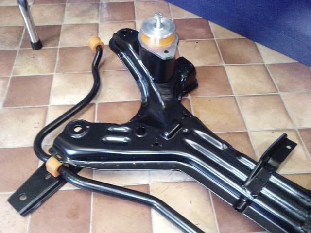

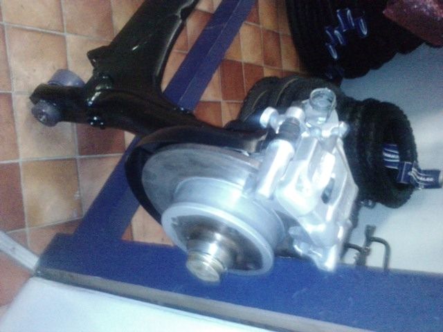

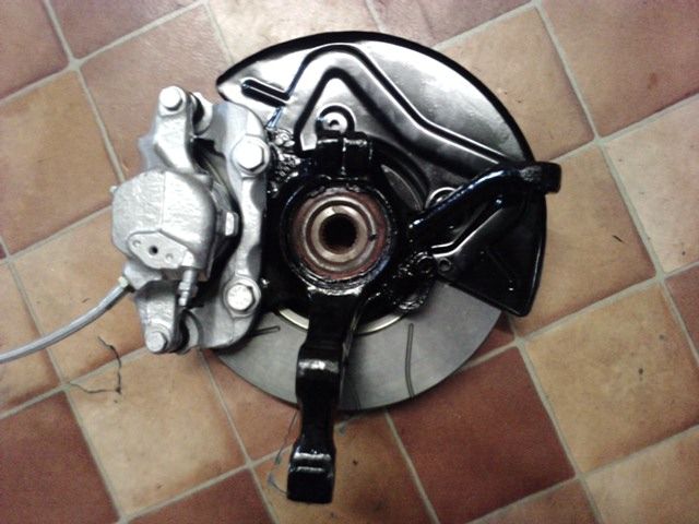

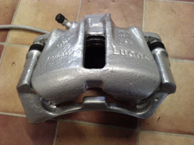

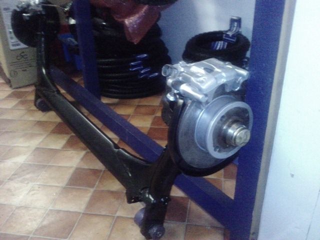

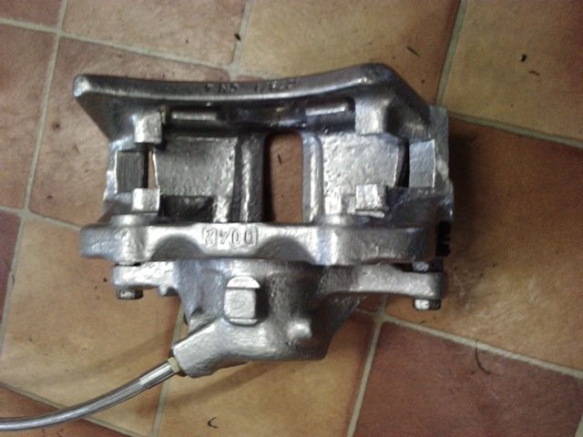

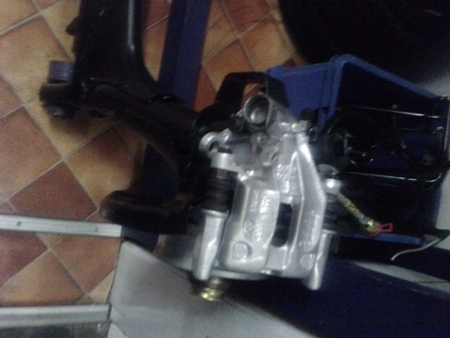

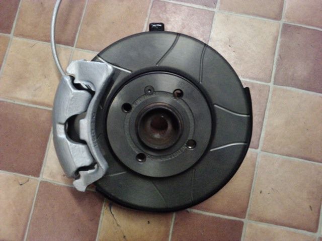

samthegram 10 Posted August 11, 2009 Cheers everyone, here are some more shots of my caliper/rear beam winter rennovation project. These went on just prior to the new wheels. The beam was shot blasted and zinc primed, then powdercoated. I then fitted some poly bushes. I wire brushed the hubs and brakes then painted them up with caliper paint. I also had EBC greenstuff pads fitted at the same time. So now all the underneath is clean and shiny :grin: Sorry about the grainy images, took them with my phone. Quote Share this post Link to post Share on other sites

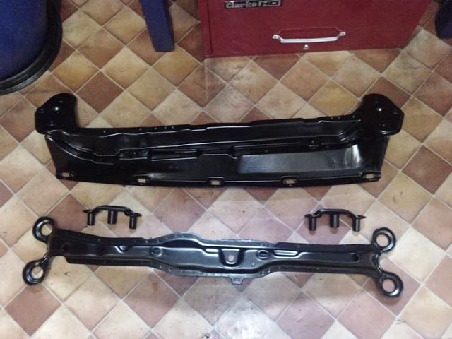

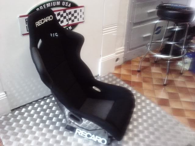

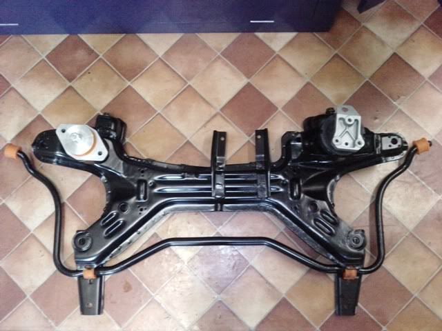

samthegram 10 Posted October 16, 2009 Not posted on here for a while so thought I would let people know of the work in progress. Bought a second hand subframe and front cross member to have powdercoated and poly bushed up I am just going to get a few new O.E brackets and bolts from the dealers and then it will be fitted by my local friendly mechanic man. Also one of my newest puchases has been a Recaro Profil SPG seat from the 'bay which i am very excited about :dance: Check out my for sale post for my old Recaro speed seats :grin: I have been on a weight saving mission in an attempt to make the thing accelerate and brake quicker without looking like a stripped out track car. So far after weighing all the parts taken out/upgraded I have managed to shed a whopping 81kg! I will post up a list for your perusal when i get time. So with it running 170bhp and loosing 81kg it now goes like the preverbial :censored: off a shovel :lol: Quote Share this post Link to post Share on other sites
