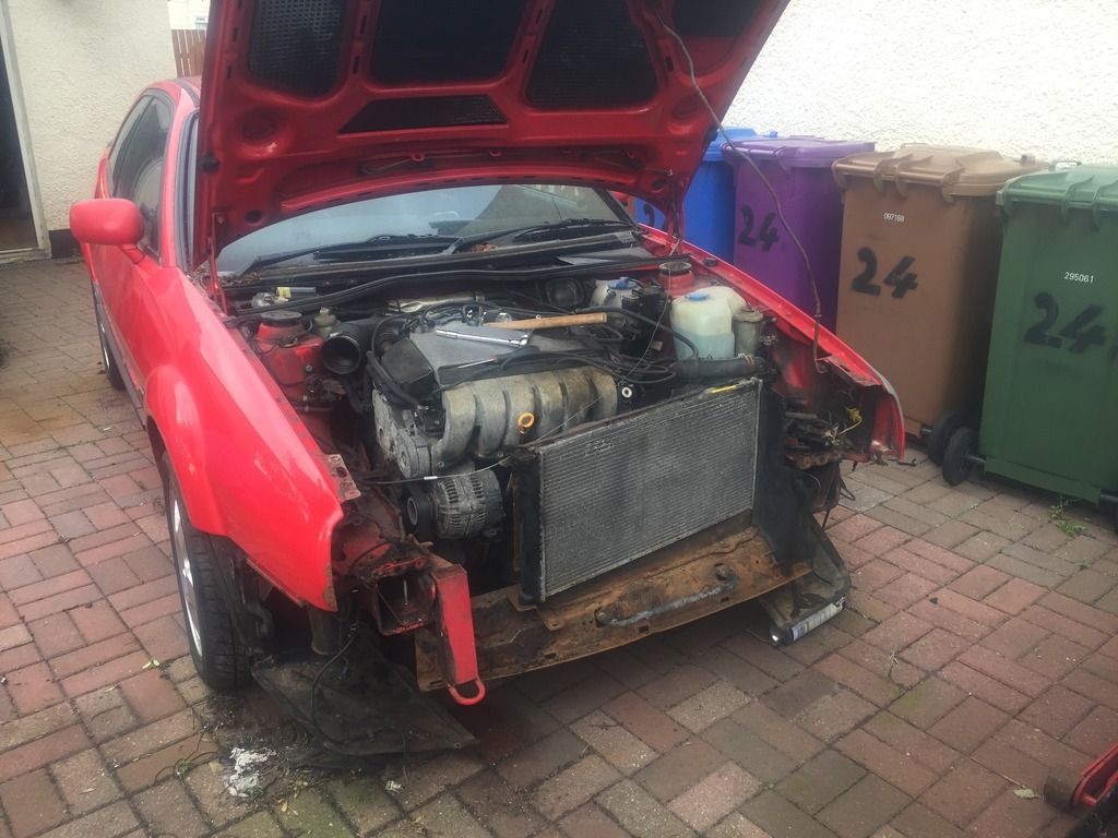

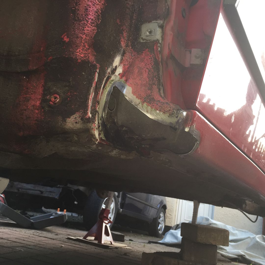

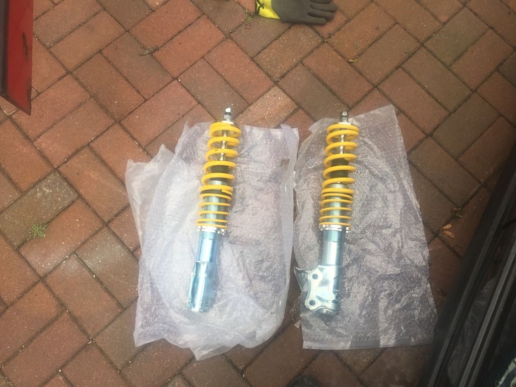

Another wee update, started stripping the front end, both wings are rotten and there is a hole on the n/s sill where the wing attaches. Also I need to do the brakes and as Anna from VW heritage kindly sent me a pair of brake shields(which need fitted to show they are a proper replacement), I thought I might as well fit new suspension, which I have had lying about for ages, but as we all know, one job leads to another and I'm now faced with drilling out a broken bolt, it would be one of the brake shield ones as well :lol:

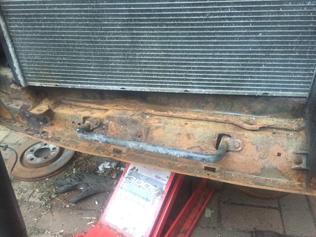

Radiator support is almost transparent so that needs replacing, new discs, pads, hoses,shields,wishbones (refurbished) and associated bushes. I'm hoping to leave the hub alone as I don't have any abs sensors and they can get swapped out later.
Also need to sort out an oil leak(switch on the filter housing) , possible sump leak and there is some oil under the gearbox.......so not too much to do :lol:

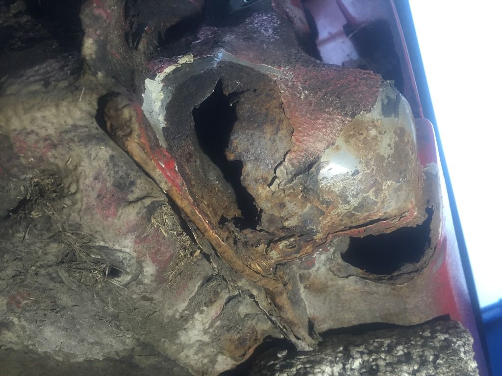

Rotten

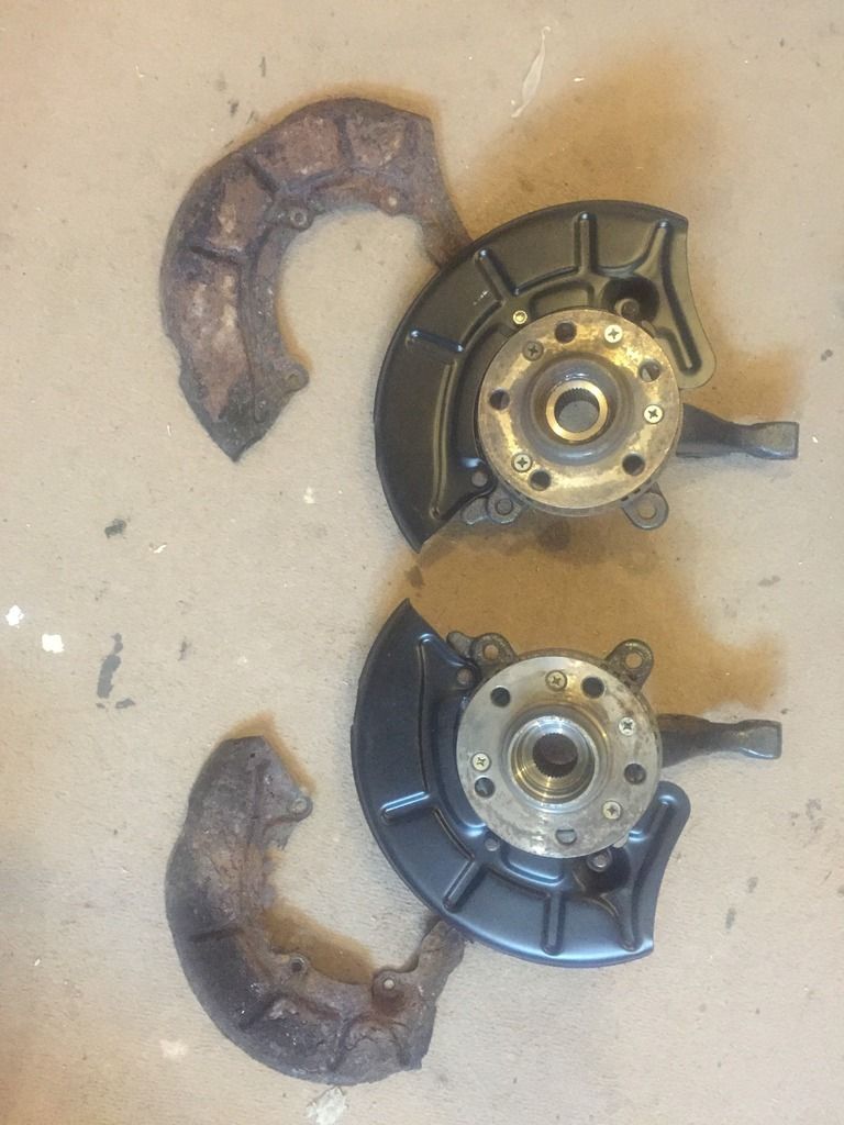

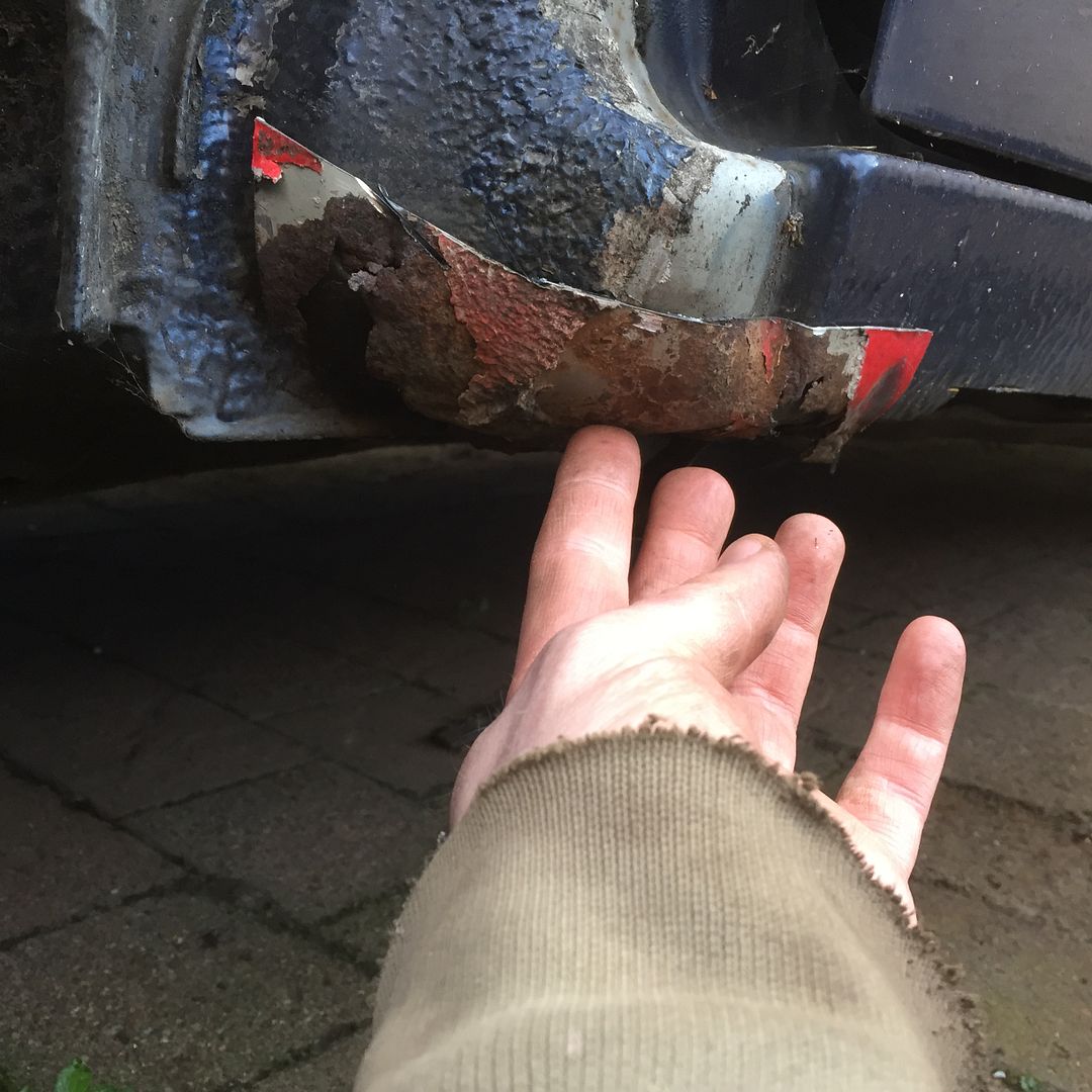

Old v new, these are like Swiss cheese up close
Welding required
Bought a couple of years ago(hoarder), I do have rears too
It's a big task easy. My car looks like your first pic at the moment . And I have to agree , where do you stop ! .
  delfinis38 said:
I've stopped playing it's a money pit...
Come in number 24...... Home many wheelie bins.
Haha, I thought the same thing! Lol
Ha ha, there are actually 5 wheelie bins :lol:

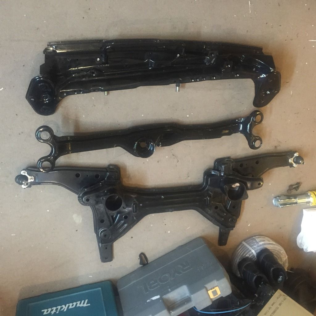

Onto plan b, I can't rebuild anything using the old rusty bolts, which leads me to the fact that I can't fit refurbished wishbones to a crusty subframe and I can't fit a fresh radiator support panel without changing the front crossmember. So all the bits I have aside for the storm will be going on here. Need to order every bolt etc plus 2 abs sensors and I think I need the bits for the end if the anti roll bar, will need to find out what they are called :lol:

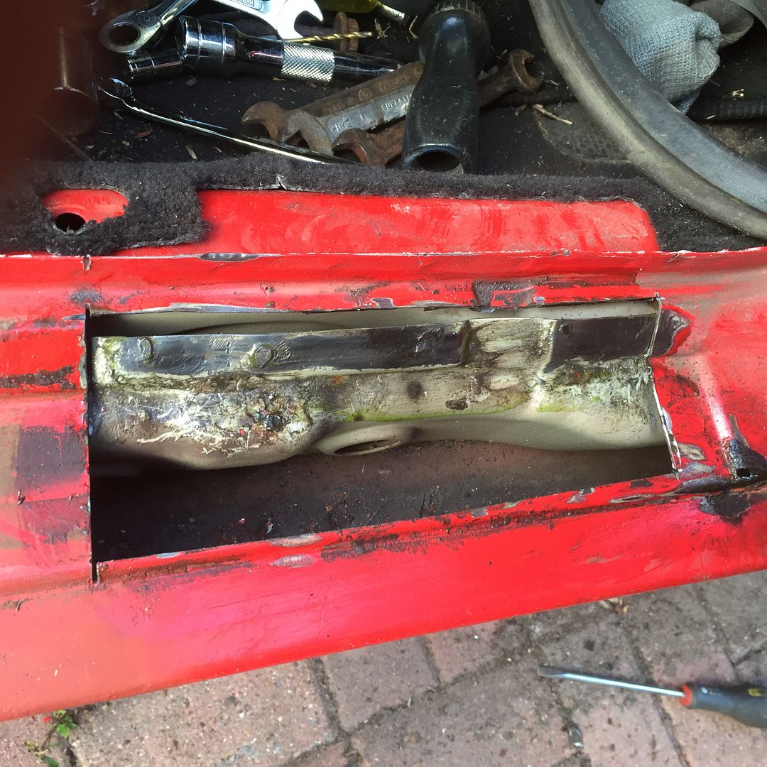

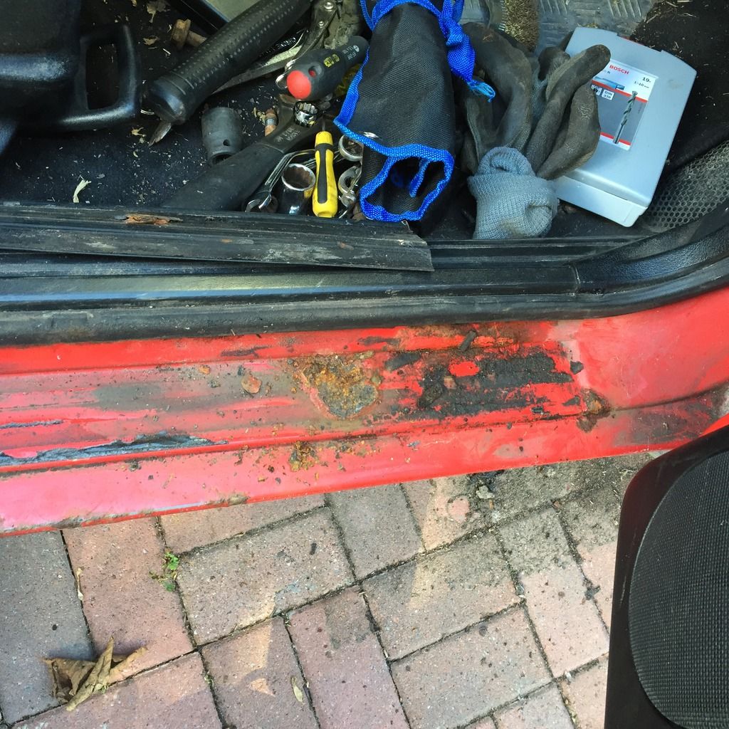

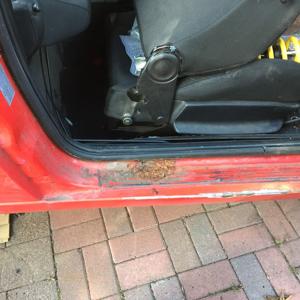

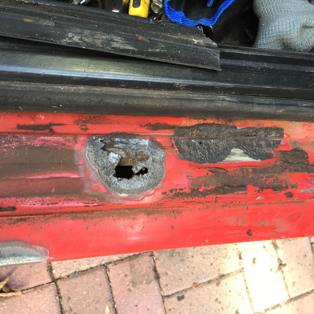

So, I had a couple of hours this afternoon and as I'm still waiting on the bolts etc for the front underside I thought I'd have a wee play with the dents/rusty bits.

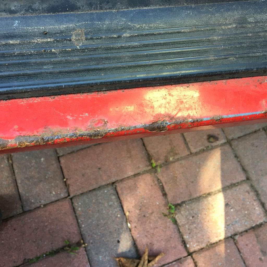

The sill at the drivers door had quite a few chips along the edge, easy enough to grind back and paint over right? :lol: It's a Corrado so not a chance :(
Small chips

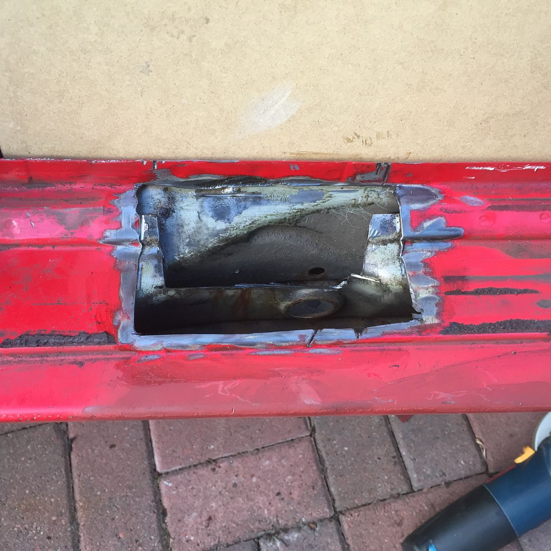

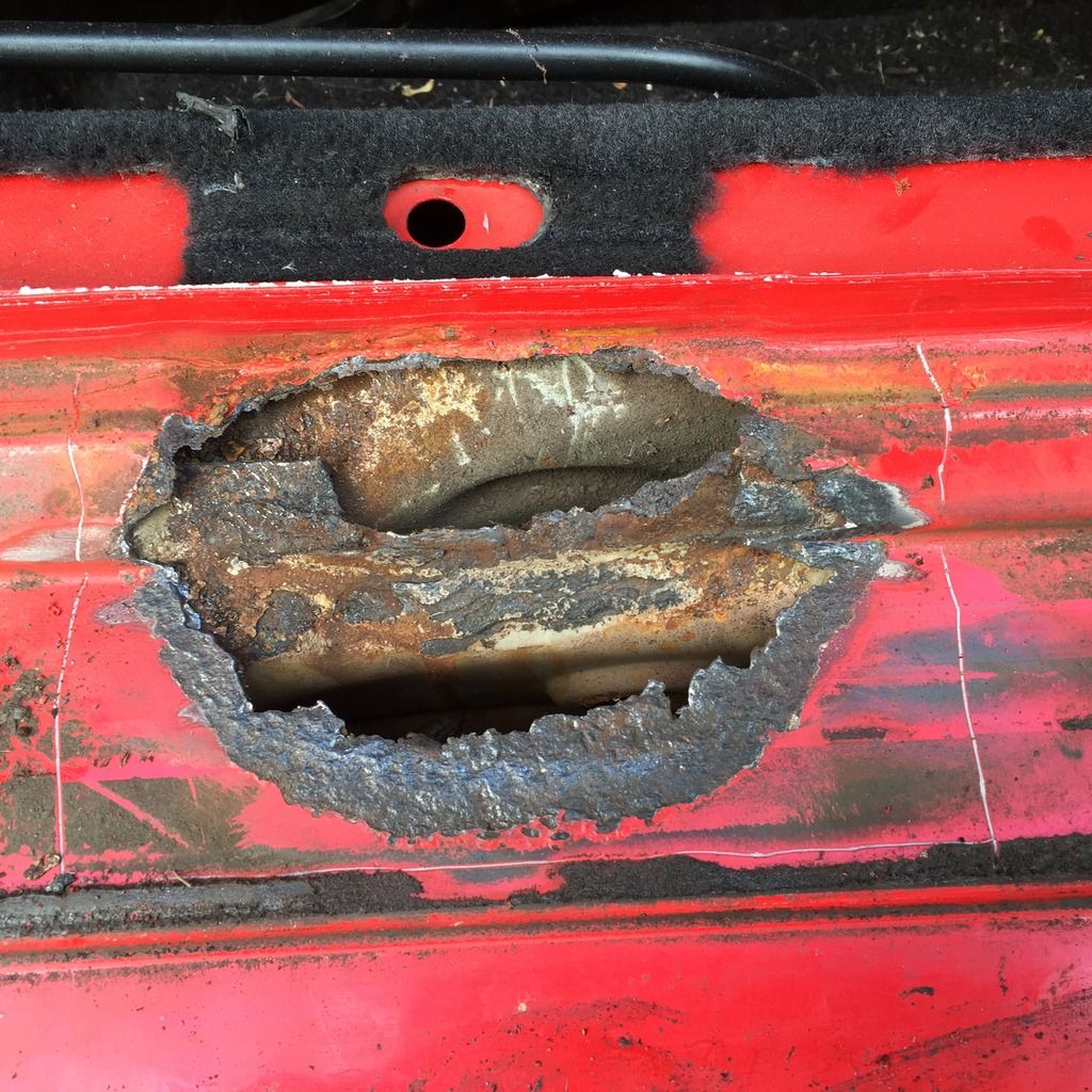

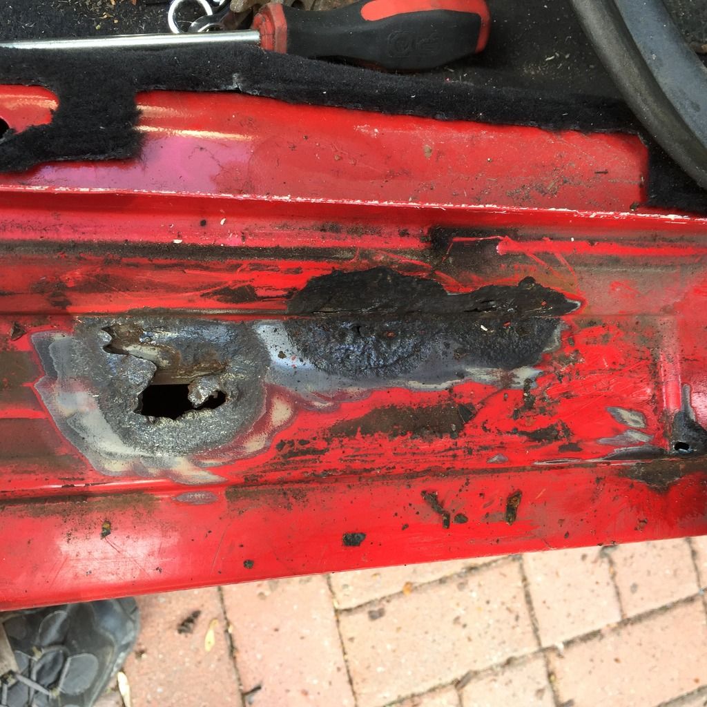

Thought I should remove the sill cover as I didn't want to get it messy, found these bits :lol:
After drying my tears I gave them a poke/grind/kick :lol:
So not nice but at least it'll give my comedy welding skills a good workout :)

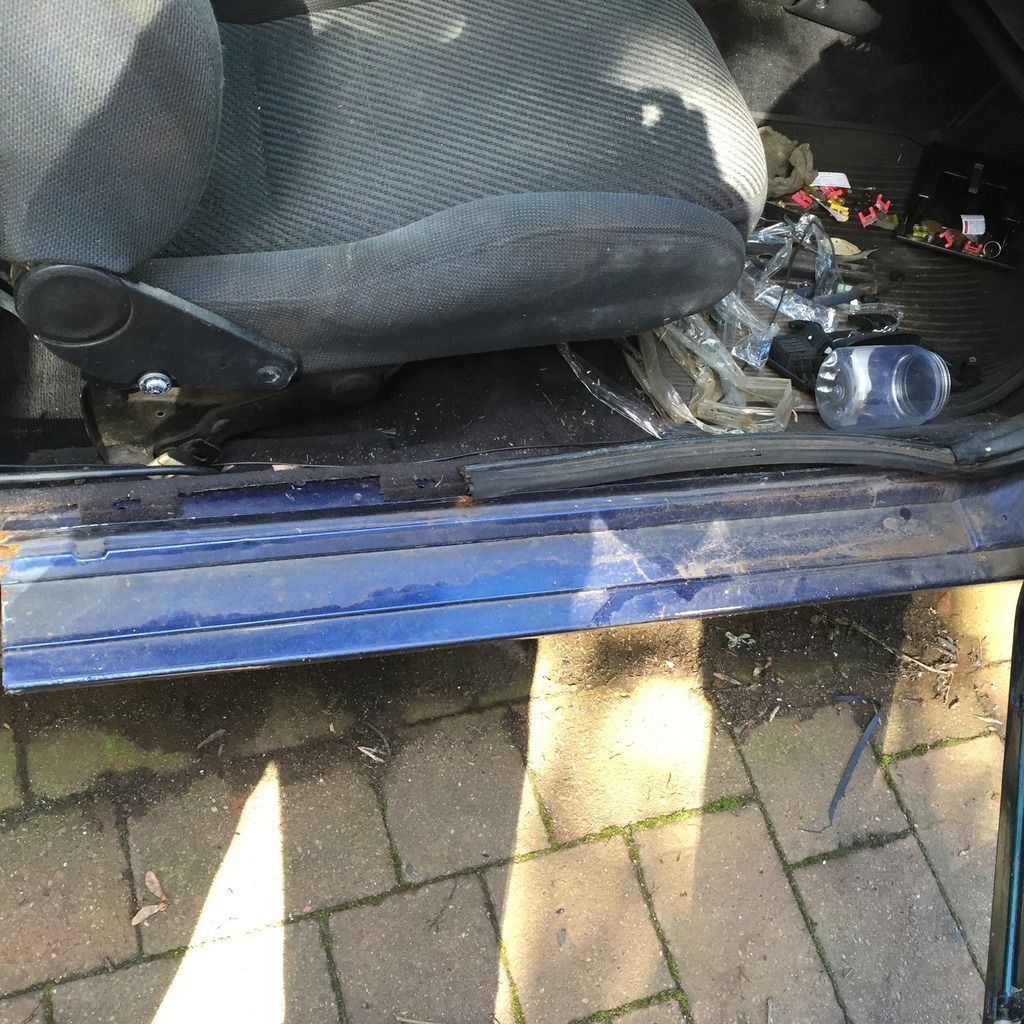

And I have a nice bit in the breaker to cut the relevant bits from. Time has run out again as I won't get back to it until later on and by then it's too late to be cutting and grinding, I'll just need to prep and hit all the welding at one time
Breaker
I think I may be a loony too ! . I will be on the lookout for the nuts n bolts . I have most of the parts for the underside , a few more needed . It would be a lot easier to drop the whole lot , chuck it and fit the new parts with new bolts . I started today and got stumped on rounded bolts I've never touched .

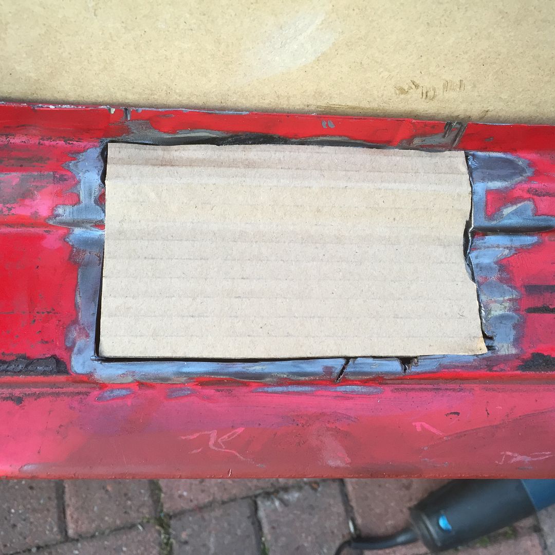

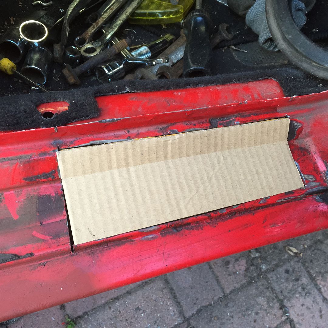

Got a wee cutting session in earlier, also managed to make a few cardboard templates up for the bits I need to replace, if only I could weld in cardboard :lol:
I've done the same with a few of the smaller bits but there is a big one that cardboard just isn't any good for :)
So I'll need to cut out the exact shape
