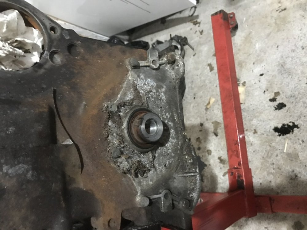

easypops 8 Posted February 14, 2020 Ok, An update is well overdue. I have removed the engine from my red VR6, doing the chains, tensioners, clutch, cams(268’s) , OBD2 conversion, teves20 conversion, gearbox has had the 5th gear swap plus a wavetrac lsd, got a Shrick manifold(OBD2) to compliment the cams, lightened flywheel. I’m currently stuck as I failed to crack the crank bolt before I removed the engine, schoolboy error as it’s now on the stand. A solution will appear I’m sure(don’t be shy to offer advice😁) Quote Share this post Link to post Share on other sites

Dox 31 Posted February 14, 2020 Crank bolt - a decent windy or battery gun should get it off. Or fit the flywheel, place a bolt in one of the engine to gearbox bolt holes then hold with a pry bar or biggest screwdriver in the ring gear whilst an assistant heaves on the crank bolt Quote Share this post Link to post Share on other sites
easypops 8 Posted February 16, 2020 On 2/14/2020 at 4:39 PM, Dox said: Crank bolt - a decent windy or battery gun should get it off. Or fit the flywheel, place a bolt in one of the engine to gearbox bolt holes then hold with a pry bar or biggest screwdriver in the ring gear whilst an assistant heaves on the crank bolt Thank Dox, I ended up jamming the crank with a couple of strategically placed bits of wood. I have had the flywheel lightened and balanced so didn’t really want to go down that road as I would have almost certainly killed it 🤣 Anyway, it’s off, long breaker bar with 6ft extension plus 2 people -one swinging , one holding 💪🤣 Quote Share this post Link to post Share on other sites

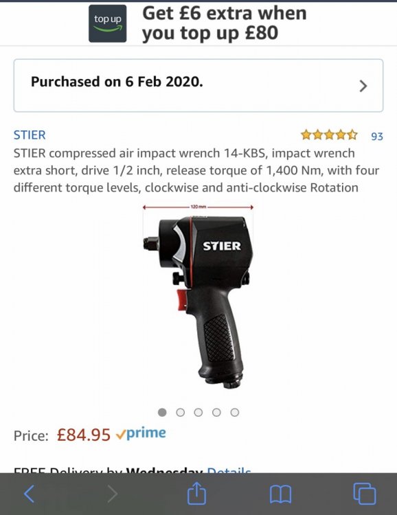

easypops 8 Posted February 16, 2020 (edited) 10 minutes ago, Tigerfish said: I’ve got a battery gun as well, I’d recommend everyone has one in their tool kit. Even if it comes to just whipping the wheels on and off they are brilliant. Sent from my iPhone using Tapatalk Pro I bought this gun as I thought it would be up to the task, I have a decent compressor but that bolt just laughed at it . I may well add a battery gun at some point but I hope to never face anything that tight again 🤣 Edited February 16, 2020 by easypops Quote Share this post Link to post Share on other sites

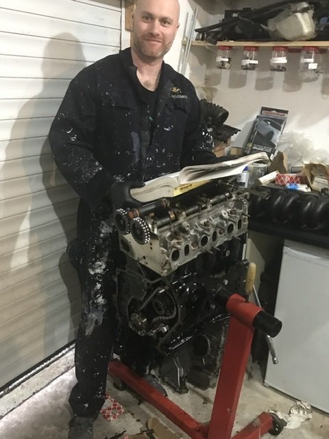

easypops 8 Posted February 21, 2020 I had a bit of help today from a very knowledgeable forum member , thanks mate, so we managed to get the chains on........baby steps 😁 Quote Share this post Link to post Share on other sites
