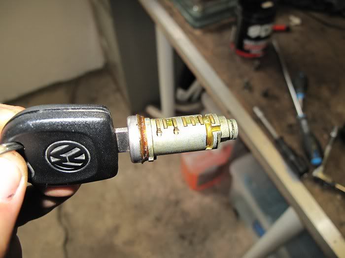

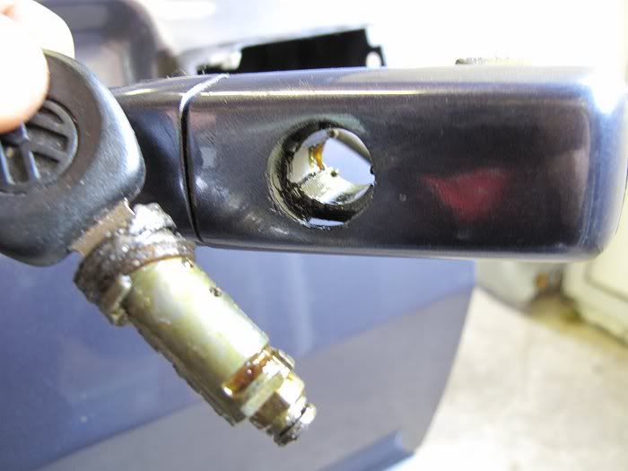

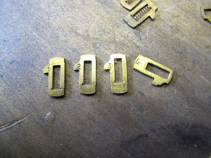

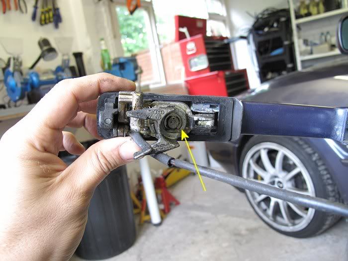

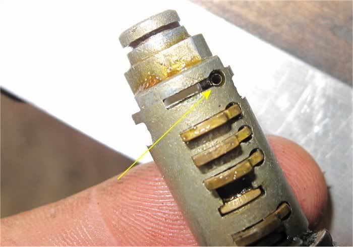

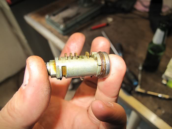

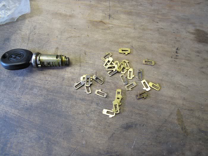

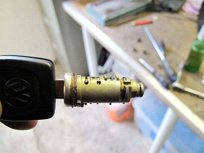

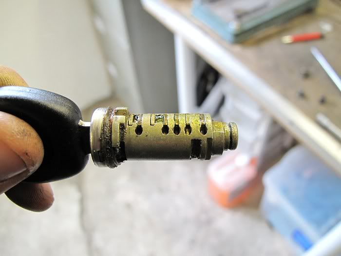

Kevin Bacon 5 Posted June 7, 2009 How many of you have 2 or more keys for the locks? Annoying isn't it. When I converted to a fixed steering column, I had to change the lock housing, which comes with a new ignition barrel and key. Therefore I had to carry 2 keys around in case of alarm / central locking failure. Not a major nuiscance but it's nice to have just 1 key opening all the locks. The most secure, expensive and difficult way to do this is to replace all 4 locks. The main benefit is the newer barrels have a lot more tumblers than the original ones in your car, making it more secure, and new locks feel slick and tight. The downsides are cost (around £150) and the fact you have to drill out the old ignition barrel, which leaves a permanent hole, making lock barrel removal easy for a thief 'in the know'. The cheapest way is to remove the door and boot barrels and re-tumbler them to match the ignition key. New tumblers also give the locks a better feel and improve security as old tumblers wear down easily, being made of a soft metal. Another way is to file down the existing tumblers but I don't feel that is the best way. Anyway, here's a guide on retumbling your barrels. I won't get too into detail on removing the door handles as I think we all know what's involved there, but the boot barrel is tricky. You have to push the lock in and drive out a split pin to seperate the barrel from the lock housing. You'll see what I mean. New tumblers. Dealers keep a pile of them under the desk, so pop in and ask for some, they're pennies. Sometimes free if your dealer is friendly :D There are only 4 variants of tumbler, so they're not the most secure locks in the world anyway. But get a bunch of each type and some tumbler springs. Barrel removal The door locks can be done in situ if the wire slack is long enough, if not, the door cards will have to come off to unclip the wire. Pop the correct key in the barrel.... ...and then remove this circlip and take off the sprung loaded mechanism, noting how it's assembled. Withdraw the barrel from the handle. Barrel retumbling With the right key, you'll notice all the tumblers are flush with the barrel. And with the desired key in the barrel, the tumblers poke out and the door won't open. I think by now you can guess what needs doing :D Without a key, the tumblers are loose and can drop out easily, so be careful. The tiny springs inside can also drop out easily, hence getting some spares with your new tumblers. So the object of the game is to replace the tumblers with a different one, one at a time until the new key does this.... It's not as bad as it sounds. After you've done the first one, note down the tumbler sequence and then you'll breeze through the rest! So there it is, a cheap and easy way to make 1 key open all the locks, and freshen them up with a new feel at the same time. Goes without saying, but grease up all the locks and handles liberally as they're prone the breakage :wink: Quote Share this post Link to post Share on other sites

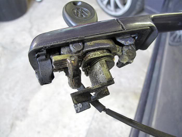

Supercharged 2 Posted June 7, 2009 Even easier if you give the dealer parts dept your key code - they can then work out the tumbler arrangement from the key catalogue... I think I've got 4 or 5 brand new barrels each with 2 keys from buying new door handles over the years - never understood why they came with them as they are so easy to swap over for the old ones. Ignition barrel needs drilling out but the door handles are easy, what are the boot and glove box like to do Kev? Quote Share this post Link to post Share on other sites
dragon green 5 Posted June 7, 2009 The glove box is as easy ,if not easier then the doors,dont know about the boot Quote Share this post Link to post Share on other sites

Alex_G60_Fanatic 0 Posted June 9, 2009 New tumblers. Dealers keep a pile of them under the desk, so pop in and ask for some, they're pennies. Sometimes free if your dealer is friendly :D I just phoned a vw dealer near me... they are asking for £43.48 for a set! (8 tumblers and springs!!!) :pale: I wish I was as friendly wish my local dealer as you are with yours!!! :camp: Any ideas on where i could get some other than my :hitler: dealership? Quote Share this post Link to post Share on other sites
JMC 0 Posted June 9, 2009 My local dealer retumbled my 2 for £10, which i thought was ok. Left them to me to fit them though :lol: Quote Share this post Link to post Share on other sites
vwdeviant 0 Posted June 9, 2009 Whoo-hoo easy to do.. when I have a few hours free to get mine done... Kev I hope you also replaced the mechs with Dave's patented Stainless ones too? Just to save another removal of handles in a while... :norty: Plus they're probably much easier to replace with the barrel out... Must get on to do my Driver's side before that snaps too.. and maybe retumble the lock whilst I'm there! Quote Share this post Link to post Share on other sites
Kevin Bacon 5 Posted June 9, 2009 I just phoned a vw dealer near me... they are asking for £43.48 for a set! (8 tumblers and springs!!!) :pale: What??! That's insane! Apparently for £50 you can get a box full of them (100s), so £50 for 8 sounds very wrong to me and also sounds like your dealer is an arse! Any ideas on where i could get some other than my :hitler: dealership? Well my locks are done now, so I can send you the tumblers I didn't use if it helps? A mixture of old and new. I noticed with mine it was mainly a case of rijigging them around to fit the new key, plus 1 or 2 new ones. Kev I hope you also replaced the mechs with Dave's patented Stainless ones too? Just to save another removal of handles in a while... Nah I just replaced the whole handles a few years ago.....when they weren't the £90 odd each that they are now!! Quote Share this post Link to post Share on other sites
Alex_G60_Fanatic 0 Posted June 9, 2009 Well my locks are done now, so I can send you the tumblers I didn't use if it helps? A mixture of old and new. I noticed with mine it was mainly a case of rijigging them around to fit the new key, plus 1 or 2 new ones. My good man! :notworthy: That would be amazing! Do you have some tumbler springs to go with that? id obviously give you postage and packaging and a few pennies extra for the trouble. Im in kinda a rush as id like to do them at the same time as replacing the door Pins (usual story there! :wink: ) give me a PM with the Low down my honky friend and we shall do business :grin: P.S. I've been in touch with Volks-Apart (great company by the way) and they say that most good locksmiths can change the tumblers for you for a few quid... AND even find you parts if like me your having trouble. Saves giving my :hitler: Dealership money! I may move just to escape them!!!! Quote Share this post Link to post Share on other sites

Kevin Bacon 5 Posted June 9, 2009 Absolutely, Marlboro lights and beer..... essential items when working on Corrados. And it's Carlsberg Export actually... 2 boxes of 18 bottles for £10 from Morrisons :D PM me your address and I'll shove em in the post for you, and yep, springs included! Quote Share this post Link to post Share on other sites
