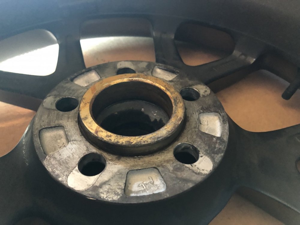

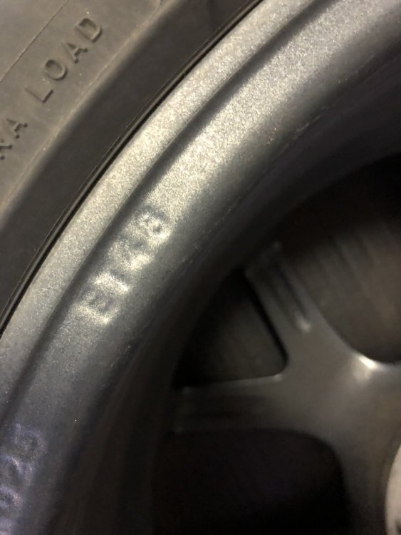

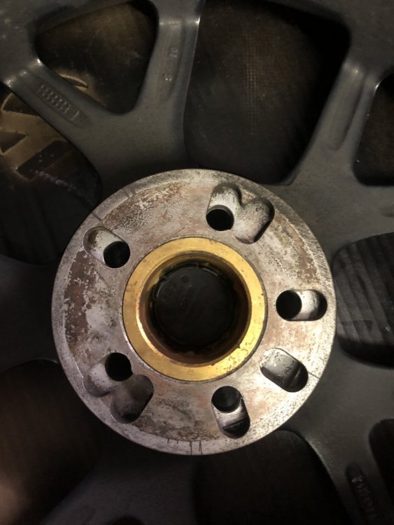

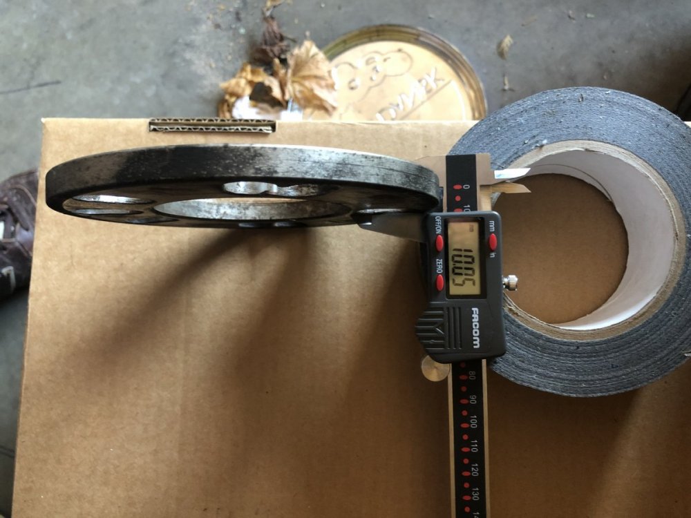

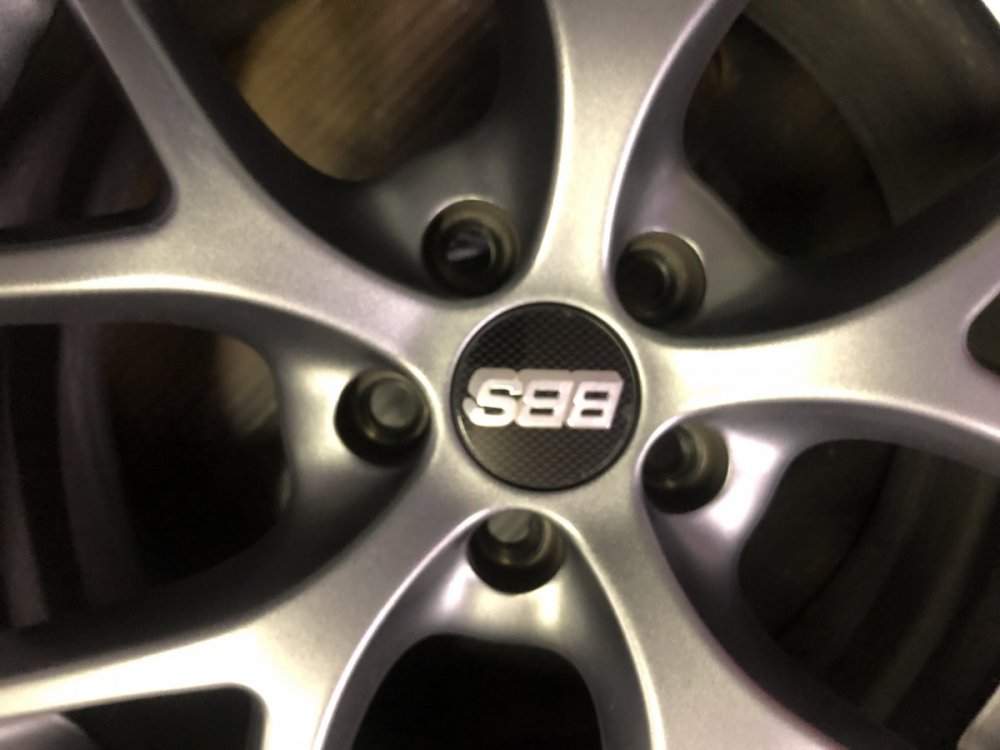

1xshaunx1 27 Posted September 14, 2020 8 hours ago, Dox said: I doubt you’ll get 10mm to fit as the boss on the rear disk is 18 - 20mm or so. 56mm will bind before the wheel meets the spacer? You could get a spacer bored to 56mm and 57.1 I’ll get a photo later of my spacers on the 17’s. 17’s offer a lot more grip but aren’t very speed bump friendly Quote Share this post Link to post Share on other sites
1xshaunx1 27 Posted September 19, 2020 I think it would be cheaper to get the wheels machined to 57.1. My wheels came from rimstyle and they sorted the machine work and spacers. The wheels and spacers were machined so the centre bore spacer fits the Corrado disc boss as I think they had a bigger bore Than 57.1 Quote Share this post Link to post Share on other sites
