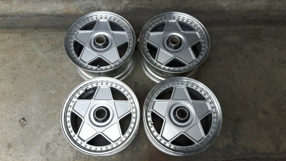

g0ldf1ng3r 16 Posted March 18, 2021 a small update as today i have purchased a unicorn - one that i have been looking for on & off for 10 years i missed a set on here about 8 years ago but today i made the jump as i swore not to miss out again they need some work but the last things on my desirable list for the VR6 are these & a VDO console 16" Autostrada Modena 3 piece split rims - specifically 16" by 7J ET +41 & 16" by 8J ET +51 so even a nice small stagger front to rear ive had a look on a will they fit calculator & i think i will just need small spacers to get the rears to fit - i already run 10mm spacers on the front so as to clear the HiSpec 4 pots so think fronts will be ok if any of our wheel expert people on here could offer any assistance with fitment & tyre choice i would be grateful - im thinking 205*45*16 on the front & 215/45/16 on the rear but maybe 225 Quote Share this post Link to post Share on other sites
Dox 23 Posted March 18, 2021 If you have 2 x 10mm spacers you could use the for trial fit by stacking them to test for clearance? Then calculate the size needed from there? Quote Share this post Link to post Share on other sites
g0ldf1ng3r 16 Posted March 18, 2021 19 minutes ago, Dox said: If you have 2 x 10mm spacers you could use the for trial fit by stacking them to test for clearance? Then calculate the size needed from there? good thinking dox Quote Share this post Link to post Share on other sites
_Matt_ 32 Posted March 18, 2021 Nice looking forward to seeing them on the car. Can't beat a good 5 spoke on a Corrado imo. Quote Share this post Link to post Share on other sites

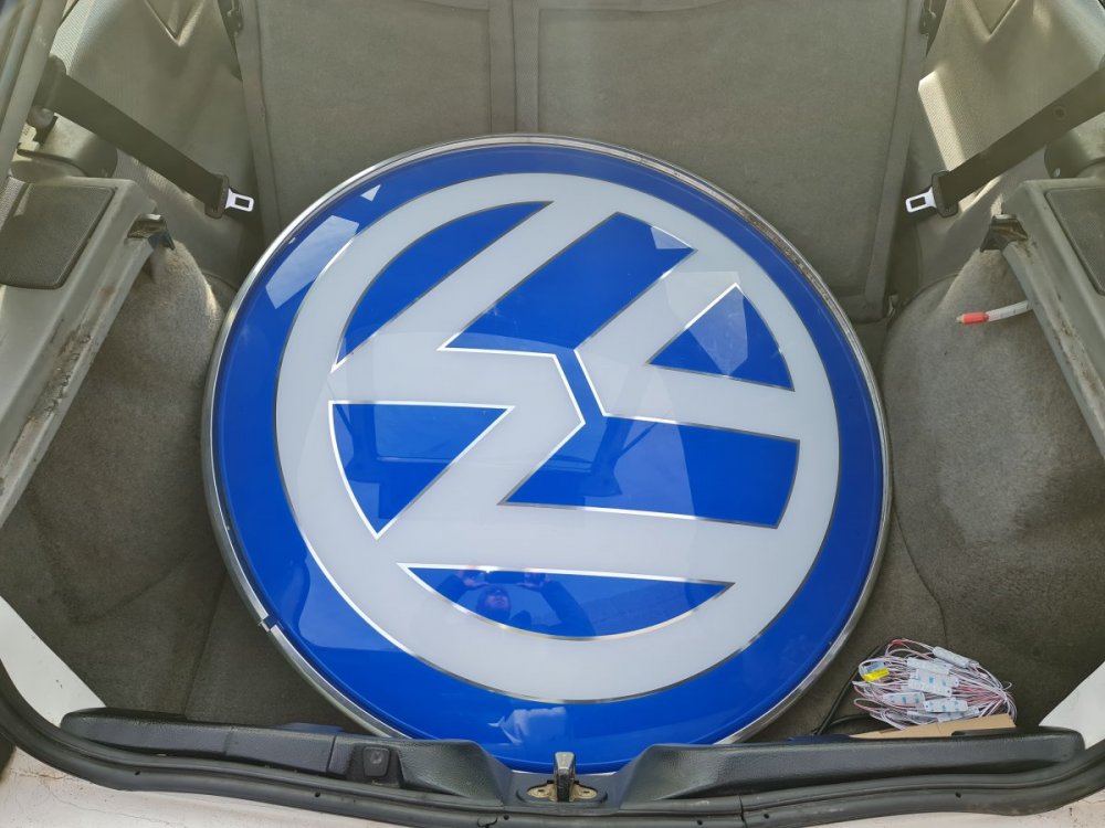

g0ldf1ng3r 16 Posted March 18, 2021 1 hour ago, MJA said: Nice looking forward to seeing them on the car. Can't beat a good 5 spoke on a Corrado imo. thanks - ive wanted these for so many years i cant quite believe ive brought some lol good day for VW related things today as this just arrived too & with the LED backlights Quote Share this post Link to post Share on other sites
fendervg 33 Posted March 18, 2021 Ha ha - rear emblem for a monster truck Corrado? Or some garage mood lighting? Quote Share this post Link to post Share on other sites
g0ldf1ng3r 16 Posted March 18, 2021 40 minutes ago, fendervg said: Ha ha - rear emblem for a monster truck Corrado? Or some garage mood lighting? it is destined for my workshop wall 😄 Quote Share this post Link to post Share on other sites
_Matt_ 32 Posted March 18, 2021 I want one of those for my newly built garage too! Will have to let the pennies recover first though. Quote Share this post Link to post Share on other sites

1xshaunx1 27 Posted March 19, 2021 Very nice. 225 on an 8” wheel. 215 is a little stretched. Best grip tyre and last fairly long are Michelin pilot sport, not cheap though. Quote Share this post Link to post Share on other sites

g0ldf1ng3r 16 Posted March 19, 2021 11 hours ago, 1xshaunx1 said: Very nice. 225 on an 8” wheel. 215 is a little stretched. Best grip tyre and last fairly long are Michelin pilot sport, not cheap though. thanks shaun - i will go see what the fitment calculators say about a 225 ive a feeling 225 rears with 205 front will look rather porntastic!!! 😄 Quote Share this post Link to post Share on other sites
fla 9 Posted March 19, 2021 19 hours ago, g0ldf1ng3r said: thanks - ive wanted these for so many years i cant quite believe ive brought some lol good day for VW related things today as this just arrived too & with the LED backlights Looks like you're our Corrado Forum superhero! Led backlights sound good - any pics? Quote Share this post Link to post Share on other sites
g0ldf1ng3r 16 Posted March 19, 2021 5 minutes ago, fla said: Looks like you're our Corrado Forum superhero! Led backlights sound good - any pics? ha ha ha thanks m8 no pics yet as the sign is currently making my kitchen look pretty but i will post some once it is installed in the workshop - it is going to take up most of the back wall in there & hopefully improve the lighting lol Quote Share this post Link to post Share on other sites

Keyo 47 Posted March 20, 2021 On 3/18/2021 at 1:30 PM, g0ldf1ng3r said: a small update as today i have purchased a unicorn - one that i have been looking for on & off for 10 years i missed a set on here about 8 years ago but today i made the jump as i swore not to miss out again they need some work but the last things on my desirable list for the VR6 are these & a VDO console 16" Autostrada Modena 3 piece split rims - specifically 16" by 7J ET +41 & 16" by 8J ET +51 so even a nice small stagger front to rear ive had a look on a will they fit calculator & i think i will just need small spacers to get the rears to fit - i already run 10mm spacers on the front so as to clear the HiSpec 4 pots so think fronts will be ok if any of our wheel expert people on here could offer any assistance with fitment & tyre choice i would be grateful - im thinking 205*45*16 on the front & 215/45/16 on the rear but maybe 225 Yeah these are nice these are. They look very Merc which I love. Quote Share this post Link to post Share on other sites
g0ldf1ng3r 16 Posted March 21, 2021 19 hours ago, Keyo said: Yeah these are nice these are. They look very Merc which I love. they are the wheels used on several ferrari's including the F40 😄 Quote Share this post Link to post Share on other sites

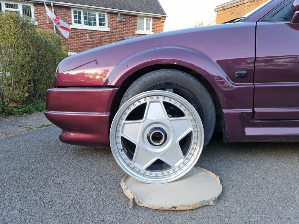

g0ldf1ng3r 16 Posted April 13, 2021 small update.... put one of the modena's alongside the VR & am thinking these are going to look fantastic once refurb'd & fitted 😄 ive got the 1st of the 4 is now split down - 40 bolts per wheel but took my time & had a little help from good old WD40 the barrels are super light once the face is removed!! 3 more to split & i can get the faces to the machine shop guy for the redrilling to 5*100 hopefully the 240 grit wet & dry 6" discs will arrive this week so i can get to work on the very minor kerbing. am hoping to get away with a 240, 320 & then 1000 & 3000 for finishing but will get some 600 if needed planning to order the centre inserts & split pins at the end of the month - not cheap but nowhere near the cost of the hex nuts or cover plates would be if they were missing tyres seems to be my main issue again though, i was hoping the increase to 16" from the 15" speedlines would give me more options but sadly not think im going to give bridgestone themselves a call to see if they have any lying around their factory as ATM it is looking like yokohama AD08RS are the only option in a premium as i need 205/45/16 on the 7J fronts & 225/45/16 on the 8J rears does anyone have any experience of these tyres? i know they are semi slick aimed at track but i wont be planning on doing much travelling in the wet Quote Share this post Link to post Share on other sites
Dox 23 Posted April 13, 2021 3 minutes ago, g0ldf1ng3r said: small update.... s i need 205/45/16 on the 7J fronts & 225/45/16 on the 8J rears Not tried this myself, but I'd imagine you'll have ABS issues on the move with the different tyre circumferences front / rear? Quote Share this post Link to post Share on other sites
g0ldf1ng3r 16 Posted April 13, 2021 17 minutes ago, Dox said: Not tried this myself, but I'd imagine you'll have ABS issues on the move with the different tyre circumferences front / rear? circumference's should be the same as front & rear are both 16" & on a 45 profile tyre - it is the just the barrel & tyre width that is different Dox my ABS is made redundant anyway as the HiSpec 4 pots on the front kick the OE brakes all around the park! plus my ABS hasnt been fully functional for years lol Quote Share this post Link to post Share on other sites

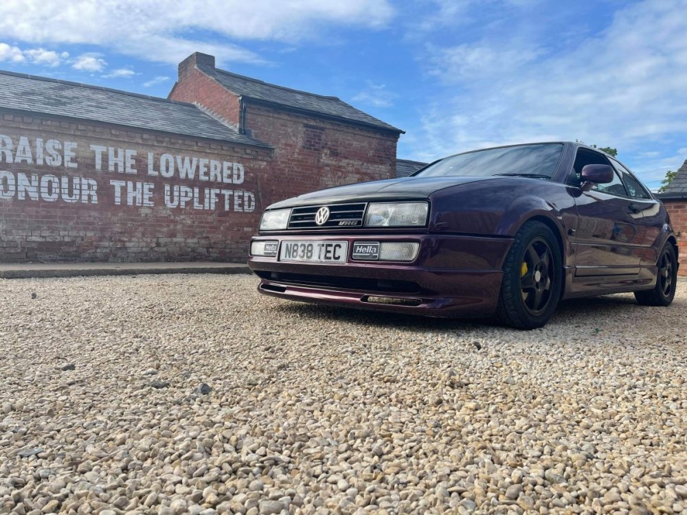

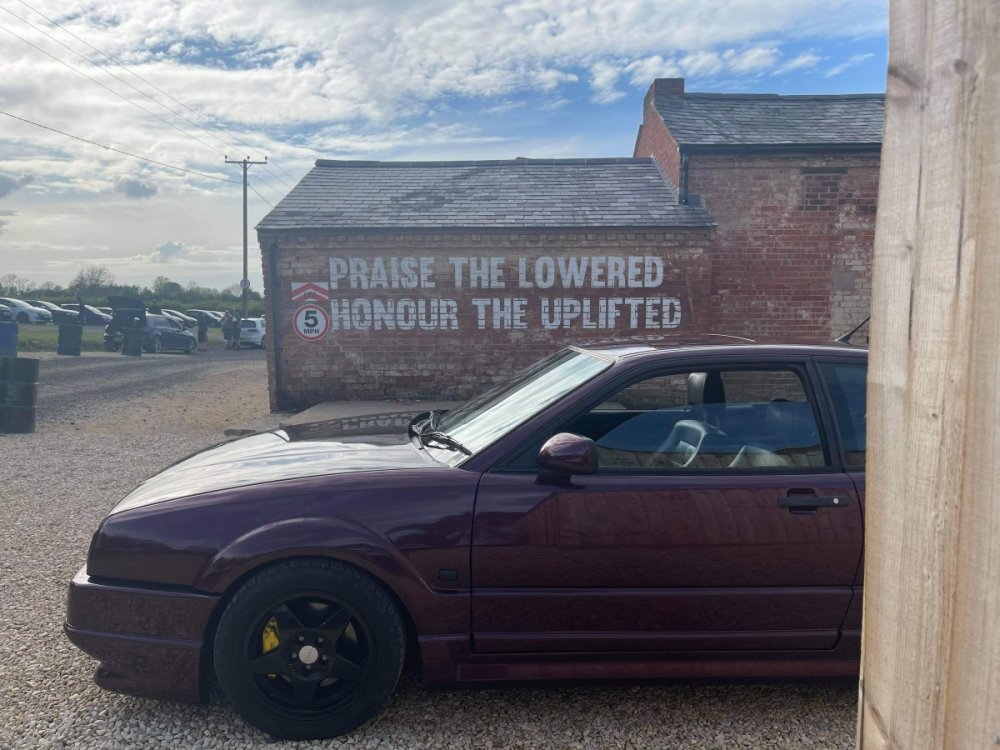

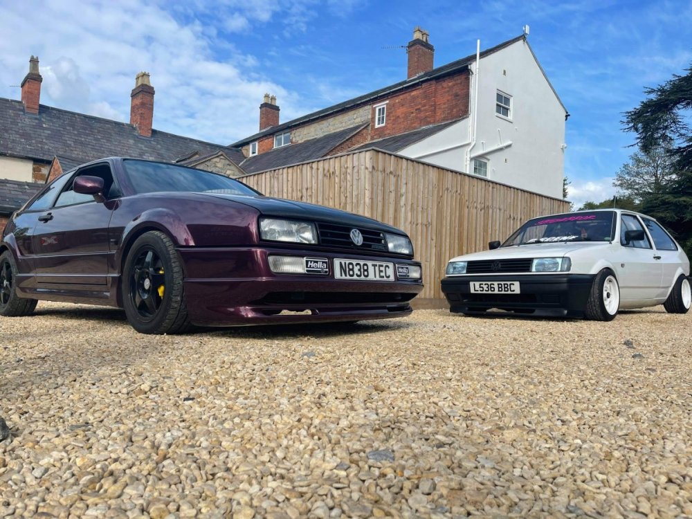

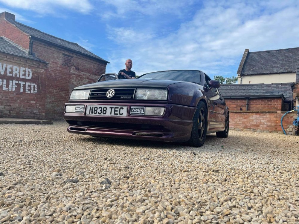

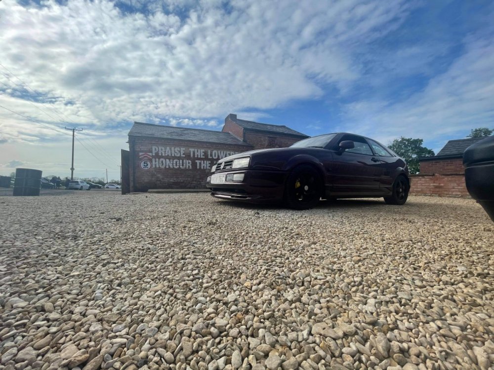

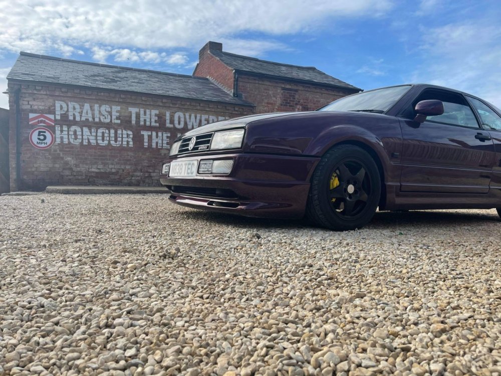

g0ldf1ng3r 16 Posted May 13, 2021 some nice pics from Caffiene & Machine in Stratford last night Quote Share this post Link to post Share on other sites
_Matt_ 32 Posted May 13, 2021 Looking smart. Are you running fatter tyres, looks nice. Quote Share this post Link to post Share on other sites
