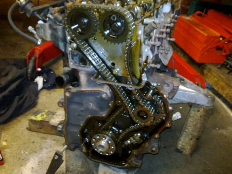

Purple Tom 0 Posted January 27, 2010 Getting there slowly but surely with it Adam, I'm just looking forward to getting the chains and tensioners done next week, will be a load off my mind once they're in and done. Forgot to say I've got 12 new tappets for it too, hopefully it'll appreciate all the work! Speaking of appreciation, it obviously didn't like being taken to pieces over the weekend because I went to get into it after work on monday and the bloody door handle broke :lol: Luckily I'd already bought a couple of door repair kits from Daves16V months ago when I had my 8V, so I set about having a go at fitting the kit to the drivers side. All I can say is once I got the handle off the door (door card off, cut the plastic door seal!) it was a piece of cake. The kit is very well designed and it took about 10 minutes a side to physically fit the new piece into the handle. I can't recommend the kit enough if I'm honest, and I'm pretty confident it'll never break again. Tonight I fitted the repair kit on the passenger side (not that it was broken, but I'm sure it would have been soon), cured a rattle from the rear speaker area (forgot to screw the seatbelt trim down) and also sorted a tiny coolant leak where a clip was slightly off-position on the hose that feeds the AWP from the thermostat housing. Then I took it for a long drive with the heater on full on the feet setting to start to dry the carpets, and it really is driving the best it ever has. Obviously this is all down to the new plugs and leads, but it certainly feels a lot more responsive. The old plugs that came out weren't in the best condition, god knows how long they'd been in for :shrug: I also had a play with an Astra VXR, not sure how hard he was trying but he didn't get past me, which was nice. Of course I didn't go faster than 70 :wave: Roll on chains, tensioners and OBD2 :D Quote Share this post Link to post Share on other sites

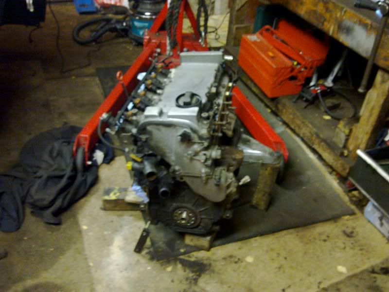

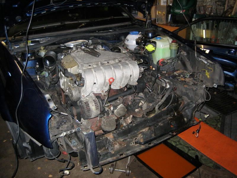

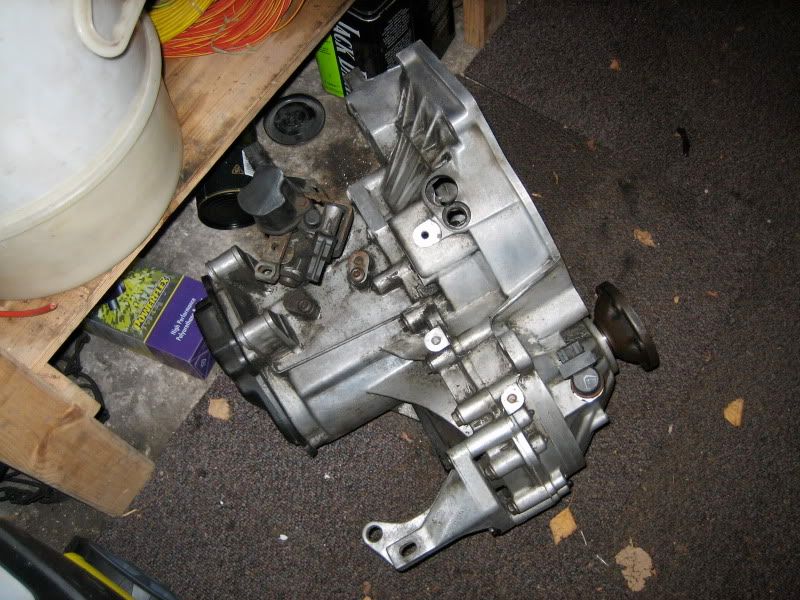

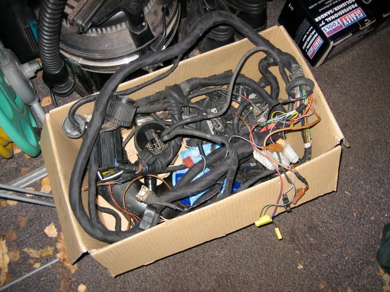

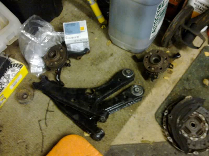

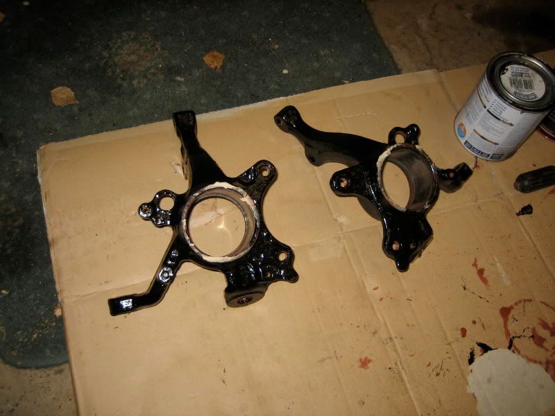

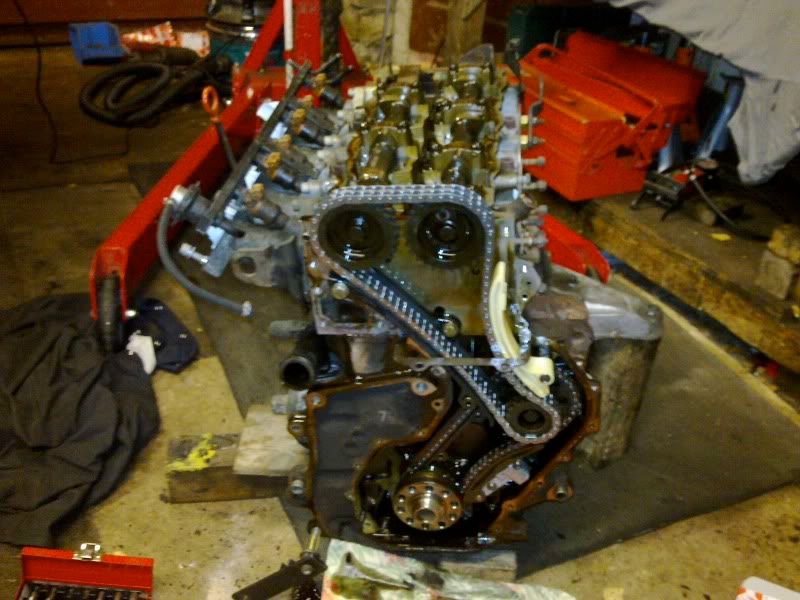

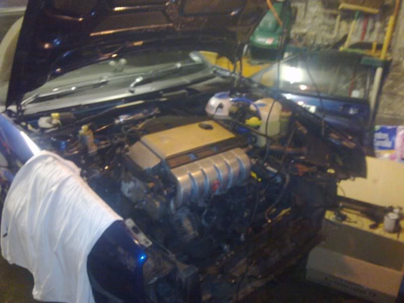

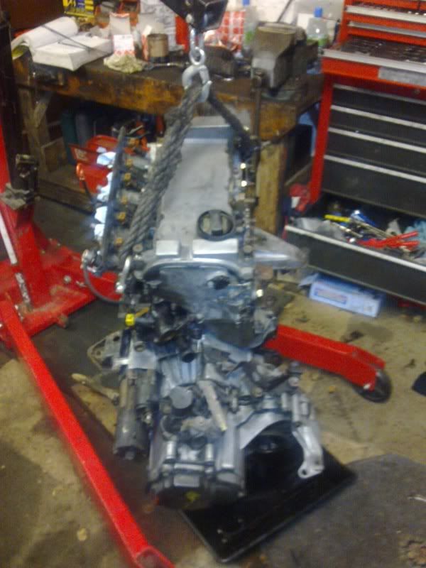

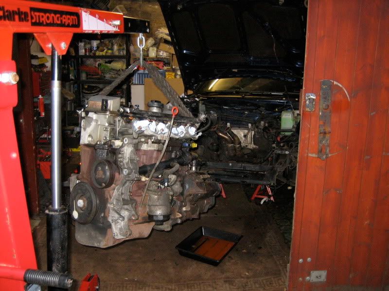

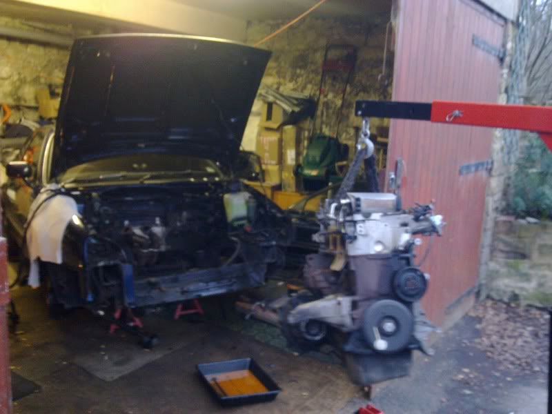

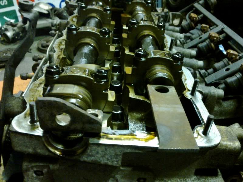

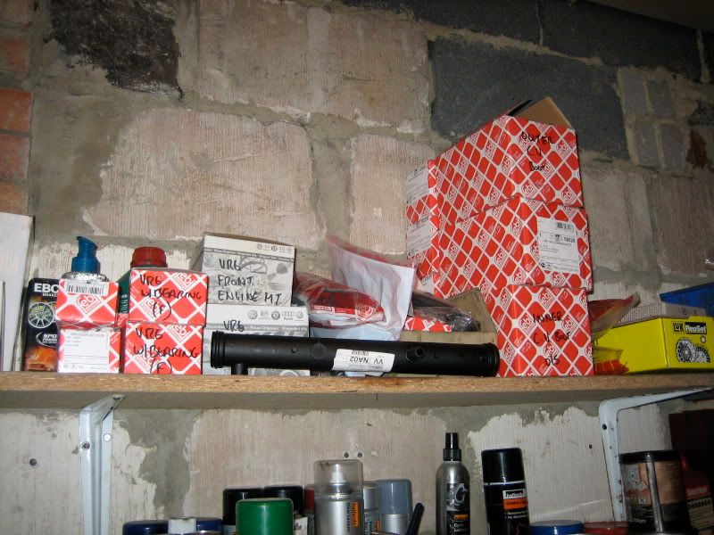

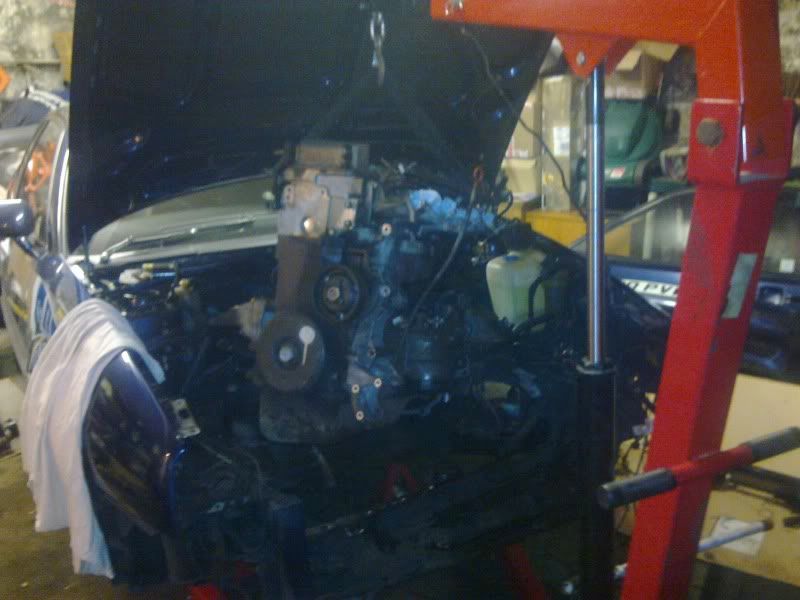

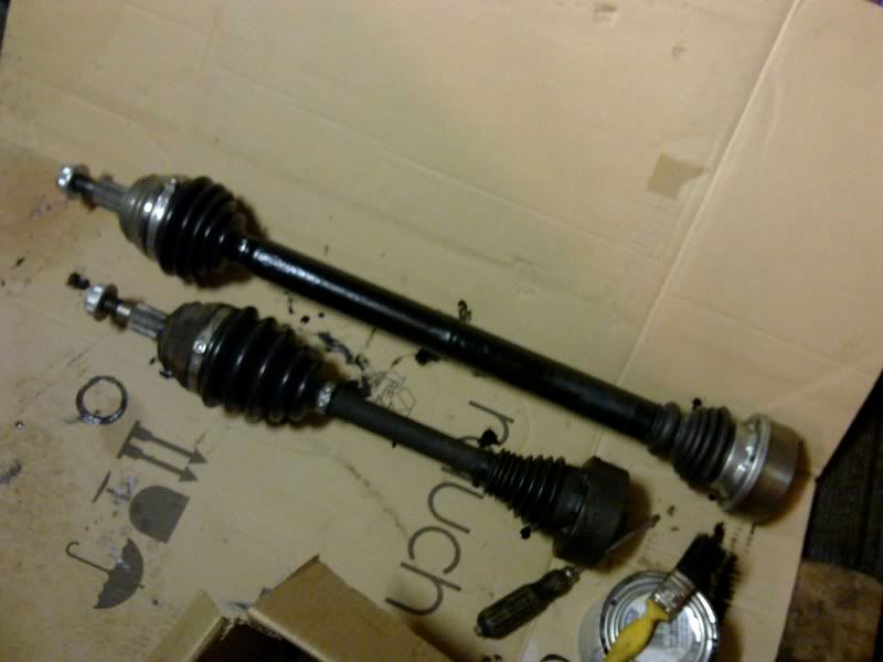

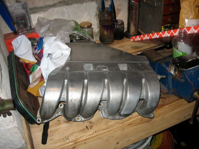

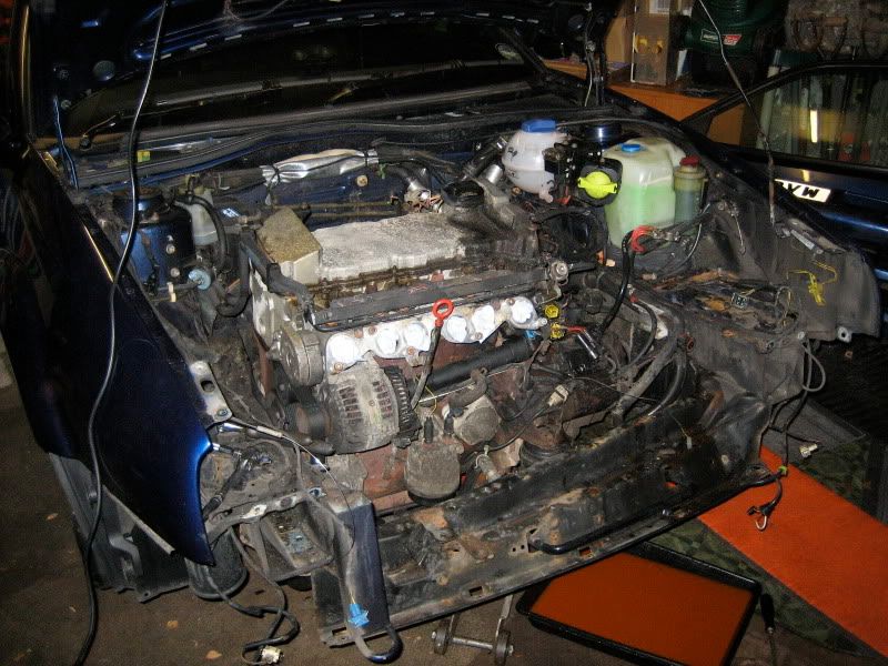

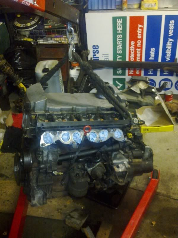

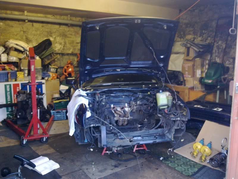

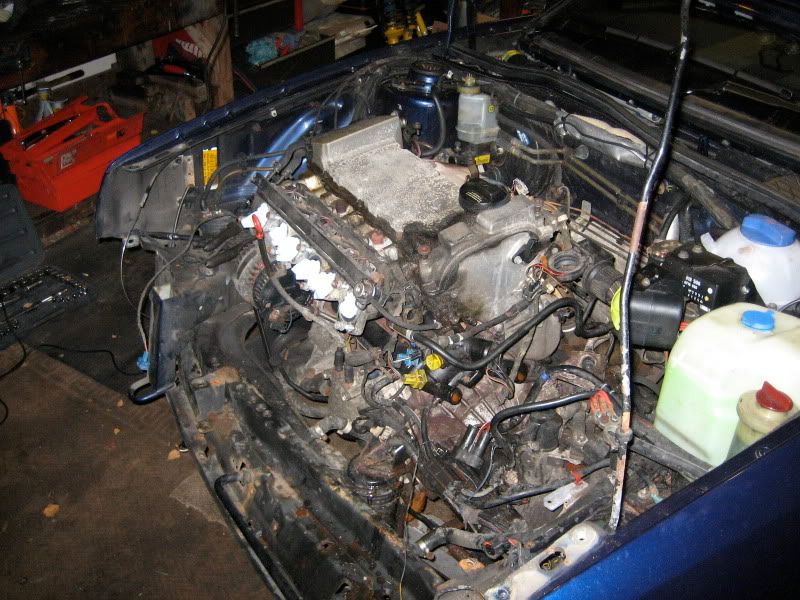

Purple Tom 0 Posted February 6, 2010 Well the time has come...chains/tensioners/clutch/gearbox/OBD2/suspension overhaul! So far I've reconditioned a set of bearing carriers that I purchased, ready to fit new bearings and drive flanges into. I've also partially stripped the front of the car and begun to make note of what does what on my OBD2 loom, which I've inspected and rewrapped with proper tape rather than shitty insulation tape :pukeright: Everything has come apart fairly easily so far, I reckon in a couple more hours I'll have the gearbox and chain covers off and be ready to begin the task of getting it to the correct TDC and replacing all the necessary components. Looks pretty straightforward though to be fair. Here's a few pics.... Here's how it looked when I remembered I really should start taking some pictures :lol: And how it looked when I left it tonight, all water hoses off, inlet manifold removed, wiring loom partially removed: Here's the reconned bearing housings: The cleaned-up gearbox: OBD2 inlet manifold: Rewrapped loom: And the boxes of bits ready to go on, scary stuff! I'll update again soon once I've done some more stuff to it! Quote Share this post Link to post Share on other sites

Purple Tom 0 Posted February 11, 2010 Long story to tell which isn't finished yet so I'm not going to start it! I'm having immobiliser issues atm, definitely with the OBD2 ECU as my car doesn't have a factory immobiliser. I was told the ECU had been defeated but I'm pretty convinced that was bullsh*t. Lots of pics and stuff to show you, but the long and short of it is that the car starts and runs but only for a couple of seconds. I'm happy that it does that though, at least it proves the chains are right and the loom is ok etc, but still lots to do yet. Adam - yeah I'm happy to fit the 288's for you mate, let me know how you're getting on and we'll arrange a time. Tom Quote Share this post Link to post Share on other sites
