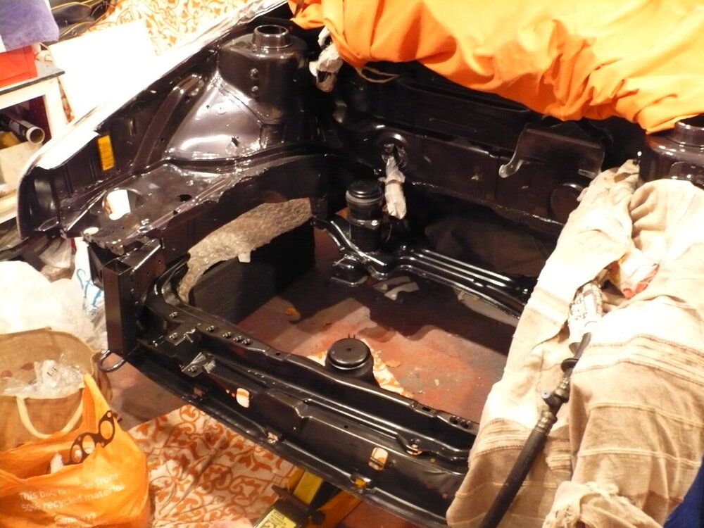

James. 7 Posted December 29, 2012 (edited) Butterfly said: FFS it is nearly 2013 isn't it... It is indeed. And I've got a car to rebuild. Best get some work done... Decided to dine at the "Corrado restoration table" today. Managed to make a booking for about eleven thirty. And in an attempt to avoid the cliche' starters such as garlic bread and the intravenous injection of cold hard drugs, decided to continue with my own choice of: Starter.. Clearcoated the scuttle tray, engine bay, arches and various under-neathy sections of newly needy-painty-bits. What a result. laid it on quite wet and left it ten minutes for the next coat. Damn stuff looks sweeter than a Crispy Creme glaze. I licked my lips and moved on... Main... Built up the front suspension and set it to one side until the clear coat is "propper ard". Coloured dots for the springs or not ? Hmmmm haven't decided yet. Desert... Undoing my belt a little, I tucked into the meeting of body and subframe. A moment I've been waiting a very very long time for. I feel it's a momentous occasion. I'm not saying man on the moon type occasion, more a channel tunnel, Higgs Boson type of thing. New bolts slipped in with copper slipped ease. Whilst the radiator supports needed the similar amount of persuasion to be coupled into their final resting places. Cigars, Cognac, Wafffer theen meents Sir ? Why not. All three, while watching Wigan on Match of The Day. The perfect day. Edited July 25, 2023 by James. Quote Share this post Link to post Share on other sites

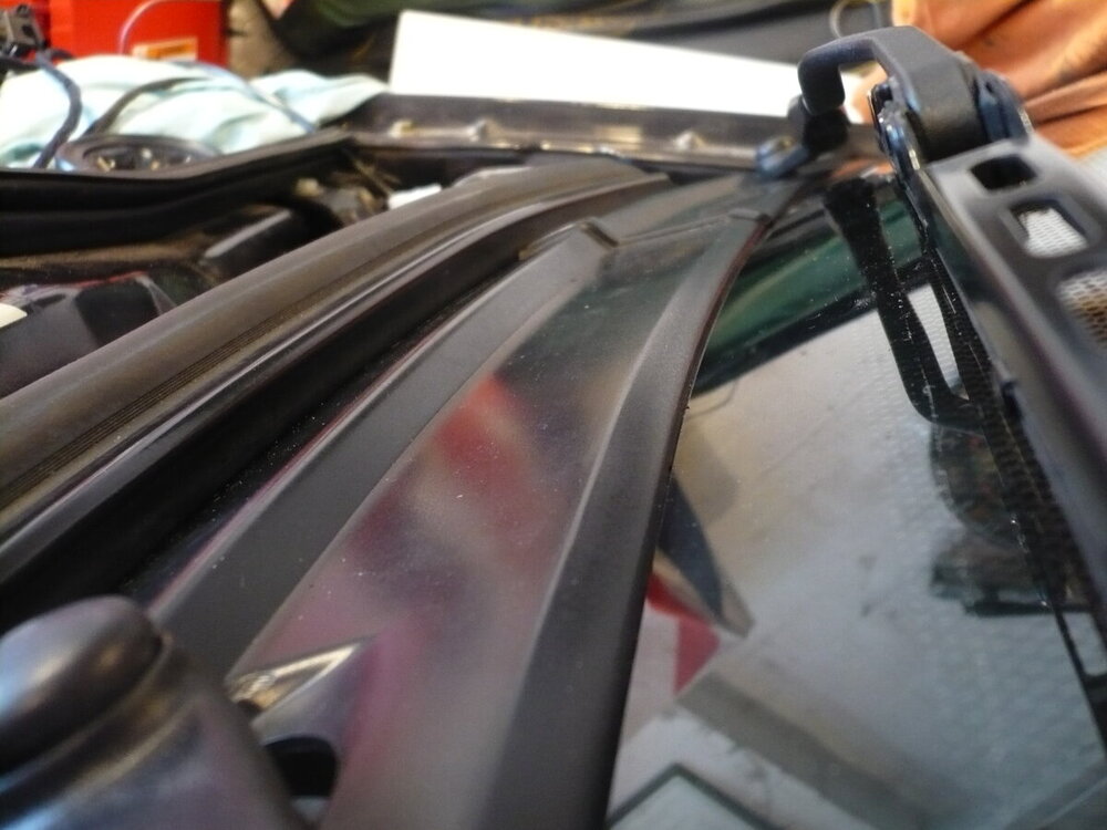

James. 7 Posted February 4, 2013 (edited) And so it goes... Scuttle tray is pretty much complete. Awaiting some scuttle trim plugs from Germany and I can sign that job off. But as is the way with most Corrados, the trim was held down with lashings of silicone. Unsurprising as the plugs are obsolete in the UK. In the mean time I obtained a very good trim cover, cut out one of my home made foilage seal "specials", drilled a hole for the air con cable and installed. I'm all for keeping it original, but when Diavia smash out a hole the size of an egg to route a 4mm cable... I draw the line. Installed a few small engine bay parts, exhaust heat shields, front suspension, wishbones and got my rear beam complete with new bushes back from Corkills VW (Thanks chaps). The brakes were returned from North West powder-coaters, freshly blasted. Along with the steering knuckles, cutting a dash in their newly restored black overcoats. Gave the brakes a lick of Jenolite to keep the red devil at bay and once dry, proceeded to coat them in a zinc primer and an aluminium outer. The difference is simply astounding. I had a dalliance with electrolosis and a Bilt hamber bath (not for me mind !). And to be fair, they both produced good results. But they weren't GREAT results. So off they went to Chorley for a blast from their past. With the steering rack, and other black engine parts getting some love, it's been a productive (if rediculously cold) few weeks. I wish it would warm up. But with that means closer to summer. And closer to my (desired) completion date. Edited July 25, 2023 by James. Quote Share this post Link to post Share on other sites

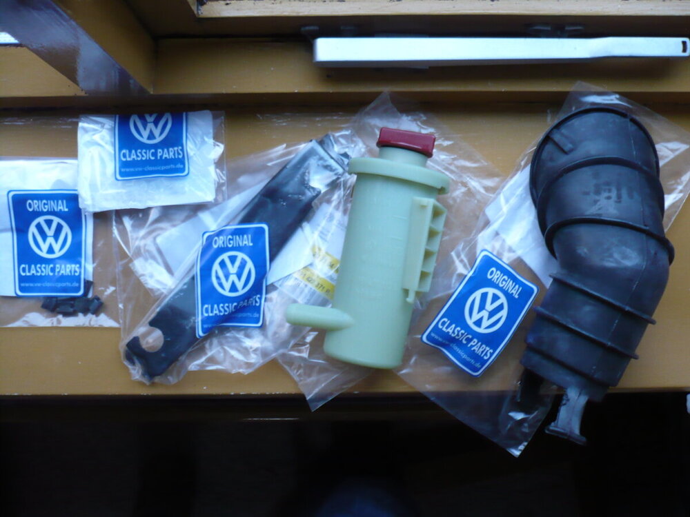

James. 7 Posted February 15, 2013 (edited) Campaigns log. Stardate 150213. A parcel from a neighboring galaxy arrived with us recently. Rare things indeed. No it wasn't a lesser spotted gweeky gweeky bird from Over ham-noid 5. Or was it the shivering natter build frog from him whipped one-oh-three ? The cause for such rarified arrivals ? Well the right signs were there. Sporting a clouded grey package and the words "Classic parts". The captains table was trembling with excitement. Clips, tanks and covers. The project is moving in the right direction now. But at the right speed ? Maybe a jump to lightspeed may help. Scotty, better punch up warp drive... Edited July 25, 2023 by James. Quote Share this post Link to post Share on other sites

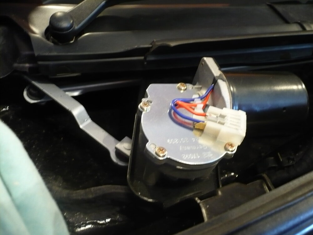

James. 7 Posted March 31, 2013 (edited) Easter Sunday. What more of a perfect occasion than to be messing about in the garage and its surrounding area. The easter bunny had left some treats for Oscar this morning, and with a similar spring in my step, I bounded over to the garage (having acrued a mass of garage time). First on the agenda was fitting those scuttle clips from der fatherland. Possible the most time consuming and yet rewarding job I've completed for some time. I had to cut away sections of mastic from under the window (to allow the trim to clip in place). But boy what a result. the trim now sits up against the window real tight and solid. One of those jobs that deserved to be done right. Second up was the new wiper motor. As hard as I tried, I couldn't get the motor to where I wanted it to be. The solution was to obtain a new one. This time a Febi unit. Looks the part and as for wiping abilities ? I guess well never know. It's not like the car's going out in the rain when all the works finished ! Gave the exhaust a battering with the wire wheel, jenolite and VHT paint. Popped it back in place (excuse the makeshift zip tie hangars) and it' starting to look good under there. All the loom was wrapped with Scapa tape during the week, and now it's all coming together nicely. Wanted to install the rear beam, until I was politely reminded that we're out tonight, so had to return indoors for my annual shower. Tonight I drink to mother nature and the beauty of a warm/dry spring day. And to a productive day. Cheers ! Edited July 25, 2023 by James. Quote Share this post Link to post Share on other sites
