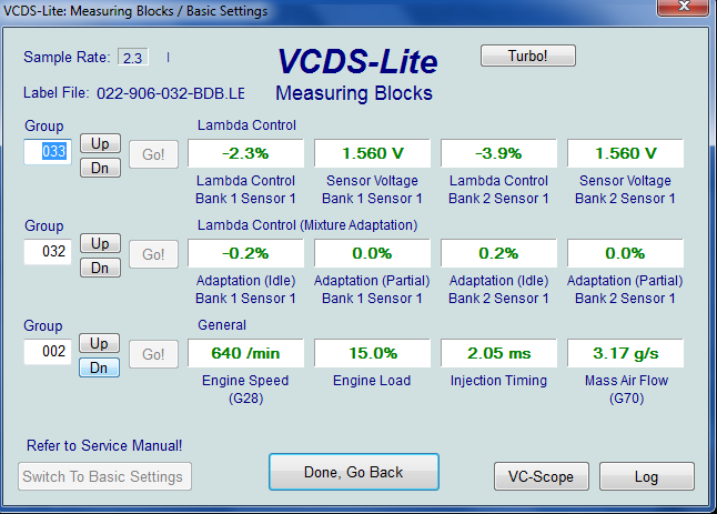

mic_VR 3 Posted June 16, 2015 What are your remaining faults on VCDS? Any lambda faults? Air filter clean etc? May also be worth doing a throttle position reset/calibration? Quote Share this post Link to post Share on other sites
Mk3highline 10 Posted June 16, 2015 swiftkid said: Well this looks better! Some lambda adaption at last! Finally down to the bare minimum fault codes, next step back to MOT station. Is there much difference between bank one and two still maybe a faulty lambda sensor? Worst case pour in a litre of methanol it will lean it out slightly to get you through mot then put some miles on it Quote Share this post Link to post Share on other sites
swiftkid 1 Posted June 16, 2015 (edited) Well we are getting closer but still not there! No faults to do with running, everything is now plumbed up properly, even done the carbon canister tonight. I have been offered the services of a 'friendly' mot man but I've spent all this time and effort to do it properly, I'd like it to be 100% My dad has suggested opening up one of the blanking plugs in the inlet to let more air in and weaken the mix but I'm not sure if the lambdas would then adapt and throw even more fuel in. Edited June 16, 2015 by swiftkid Quote Share this post Link to post Share on other sites

mic_VR 3 Posted June 16, 2015 The lambdas are in the correct banks aren't they? Have you got one adapting positive, the other negative. Quote Share this post Link to post Share on other sites
Sean_Jaymo 0 Posted June 16, 2015 My adaptions are a bit either side of zero. Are the lambdas both genuine or similar age? Is there a significant difference in exhaust temp? Quote Share this post Link to post Share on other sites
swiftkid 1 Posted June 16, 2015 Nope, had that suggested and values are around 0, seem to bounce around a little but max I've seen is about +8. Idle isn't spectacular I've noticed though so I'm going to clean the maf to make sure that is OK although is reading a steady 3-4 which I believe is about right. I'm past the 10 days retest now so the bloody thing can sit unloved for a while. Quote Share this post Link to post Share on other sites

Mk3highline 10 Posted June 26, 2015 swiftkid said: Yea hopefully, I have noticed a minor misfire but no code so I reckon there is a coilpack on its way out. Took the plugs out and they were black as expected so I'll replace the brand new, approx 10 mile old plugs that now look massively second hand and get a coilpack to try I don't think you need to replace the plugs they will clean up now you got closed loop back Quote Share this post Link to post Share on other sites
swiftkid 1 Posted June 27, 2015 Absolute win! And we have a pass, readings are a mile out so I'll have to look into that but now I have a year to play. Quote Share this post Link to post Share on other sites
