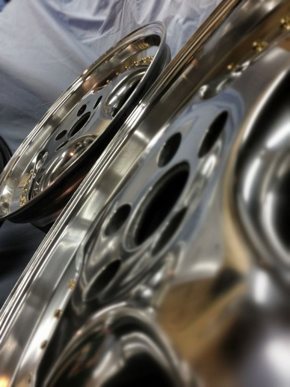

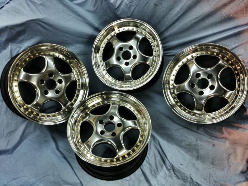

_G_ 10 Posted March 18, 2013 :dance: Excuse the iPhone pictures, but...... Maybe that will cheer you up too! See you tomorrow Buddy Quote Share this post Link to post Share on other sites
Rams 0 Posted March 19, 2013 Kev! Your a legend! Tyres being ordered up as we speak. Van insured also.... They look great buddy, thanks for all your hard work and I know you've got loads of your own stuff to do so I appreciate it immensely! You are 'The Best' man when ever that day comes! I feel lifted now. I know the boost gauge isn't your cup of tea but it will do for now and will add to the whole ambionce in the words of Mr Flanagan! My mechanic said, your car is driving out tonight, he's got clearance from his wife that he will be back late so if these hoses come then I will be driving home. I can then get these tyres fitted on Friday or Saturday and another major transformation complete. A very happy Rams Quote Share this post Link to post Share on other sites
