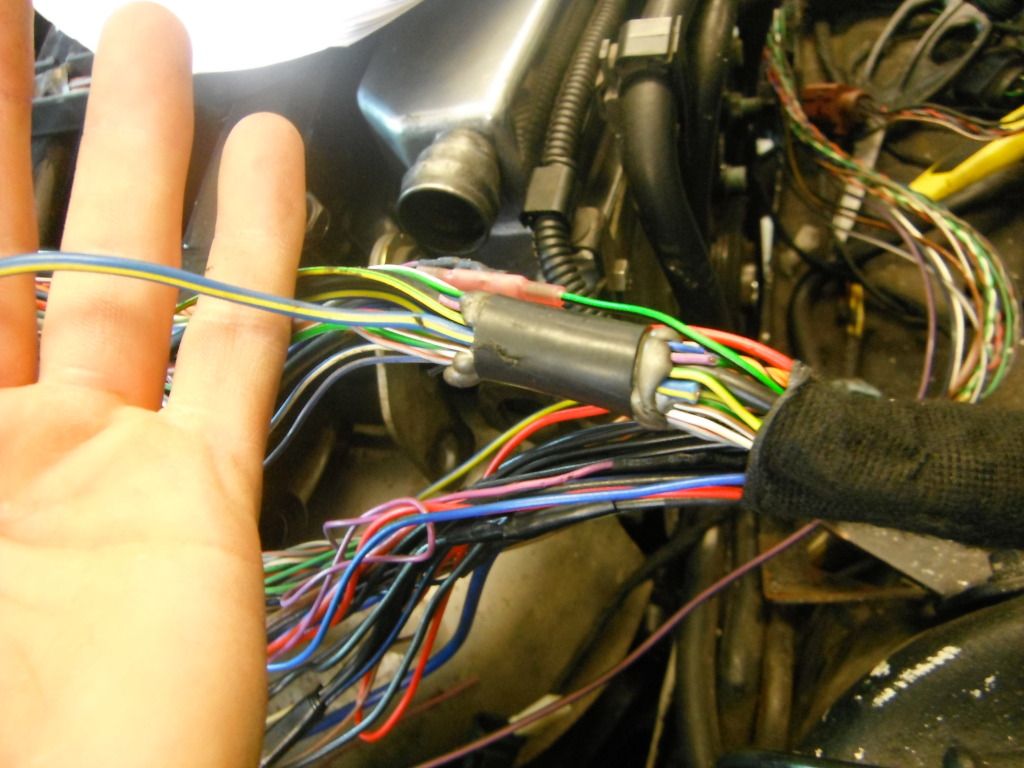

VW_OwneR_85 2 Posted August 4, 2012 (edited) can anyone tell me if these faults are wireing related ? this is from a 2001 BDE 2.8 from a 4motion into a corrado, immisions stuff should have been removed so im not sure if these lambda faults are important or not. my car cant idle to save its life! so im guessing its down to the maf fault, 17523 oxygen sensor heating : B1 S1 : short to ground p1115-002- lower limit exceeded 17527 O2 Sensor Heater Circ.,Bank2-Sensor1 Short to Ground 16486 Mass or Volume Air Flow Circ Low Input yea there wireing related !! arghh!!! Edited August 5, 2012 by VW_OwneR_85 Quote Share this post Link to post Share on other sites

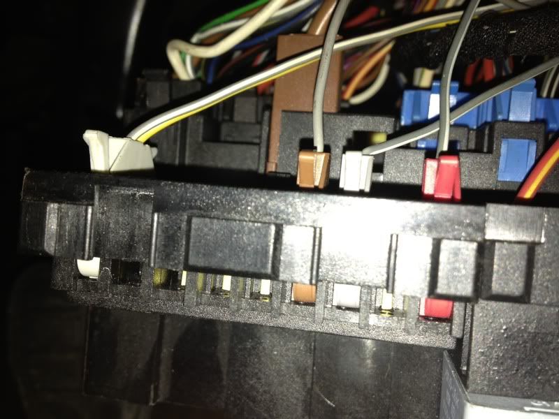

dil 0 Posted March 11, 2013 (edited) quick question i've never been able to scan the engine using 409.1 but i am able to scan the ABS unit, is this normal for an r32 conversion using mk4 loom? I am using an ebay jobbie cable (blue one), but it works perfectly on a vr6 golf. what i have tested Port 4 Earth?yes Port 7 Live?yes about 9.3 volts Port 16 Live?yes about 12.5 volts from what i have read these bunch of wires at the top of the fuse box are all OBD related? I assume one comes in from the ECU and one out to the port? Edited March 12, 2013 by dil additional info Quote Share this post Link to post Share on other sites
