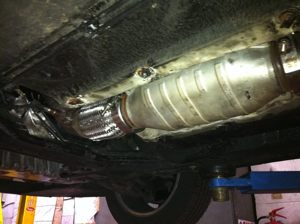

Kevin Bacon 5 Posted February 17, 2012 Minor update. Flew through it's 9th MOT today. Mileage now not far off the big 200K :D I also had the UnitedMotorsport downpipes modified today, to fit a 3" flex bellow and my 3" V band cat from the turbo engine. No more stinky exhaust smells :D I've been told the exhaust is far too quiet now, but I like it that way! Quote Share this post Link to post Share on other sites

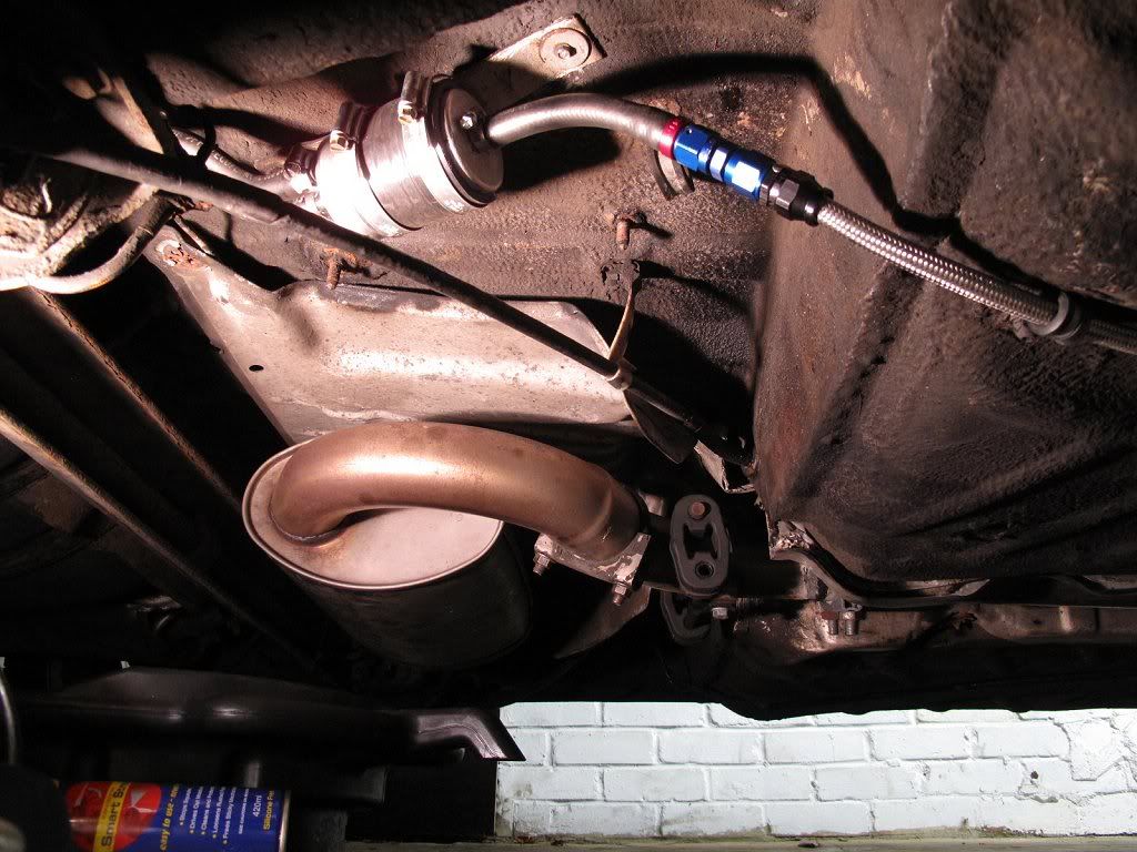

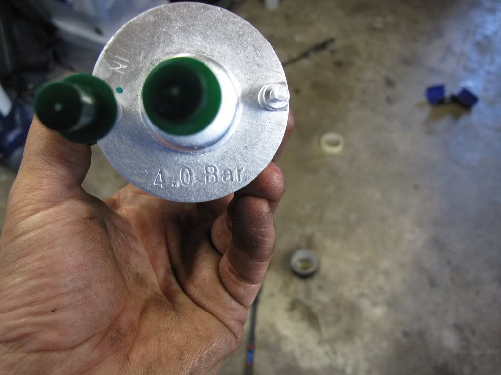

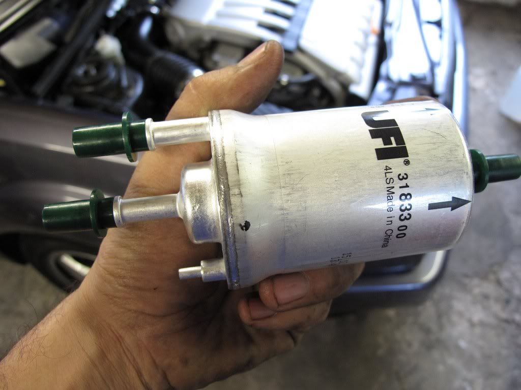

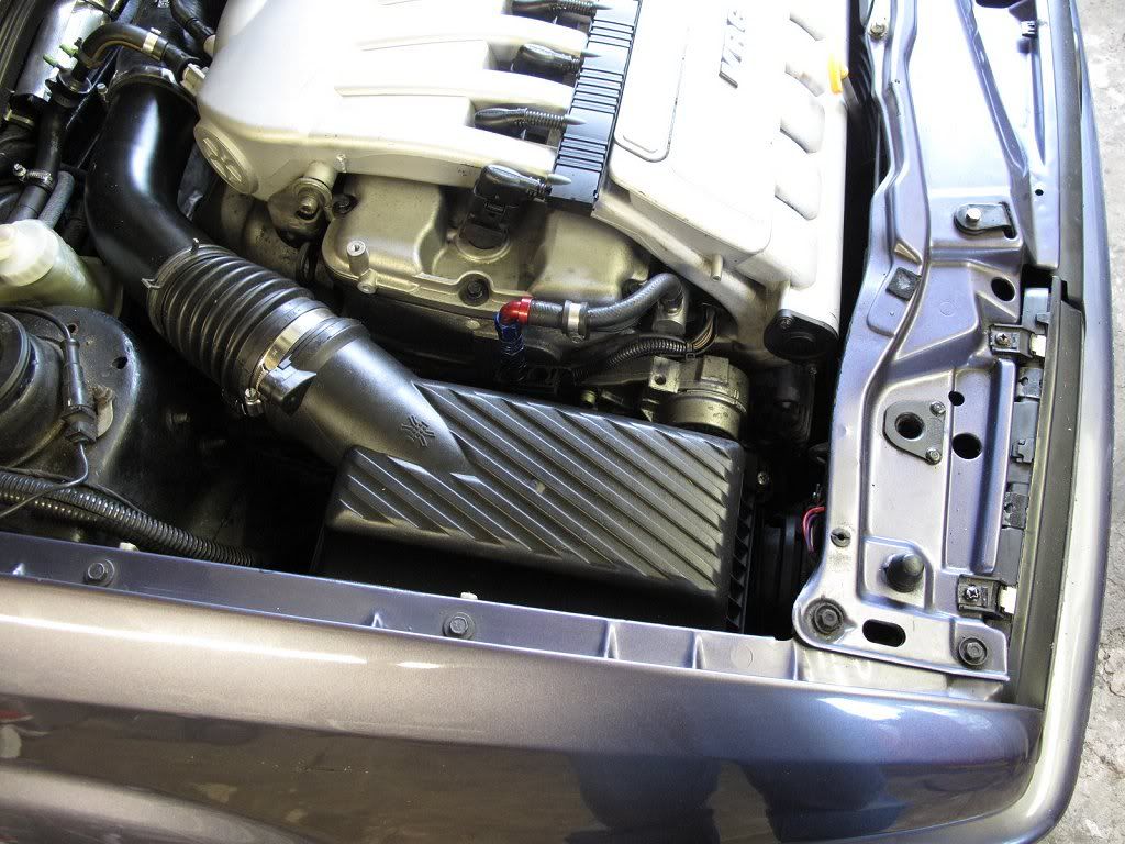

Kevin Bacon 5 Posted May 29, 2012 In preperation for going MK5 ECU, I have modified the fuel supply to MK5 spec too. The injection map in the MK5 software will be programmed for a constant 4 bar rail pressure, so the MK4 rail and FPR is off and back on with the returnless MK5 rail. In order to get the 4 bar supply as per the factory, I bought a MK5 fuel filter, which has a 4 bar reg built in. £15+VAT and 40K service interval. The fuel return is done in the regulator as well, so all I all I needed was a single line up to the engine. I used -6 braided teflon as it's super tough. Fit and forget :D I'm not really sure why OEs binned return rails and FPRs in favour of this method. Probably cost and to simplify the fuel circuit. Another benefit is the fuel is always cold as it doesn't have to pass through the rail and therefore get warmed up. I'm hate jubilee clips but was the only way I could do it for now as I can't find OE push fit fuel fittings, so I'll look into improving it. Things look tidier in the engine bay! It started up and ran fine and no leaks :D Just need to remap it a little now but so far so good! Quote Share this post Link to post Share on other sites
