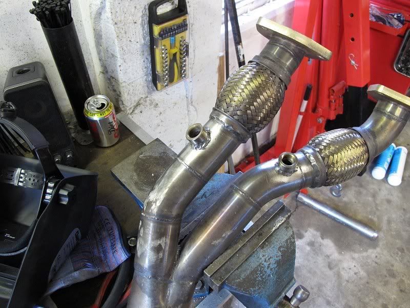

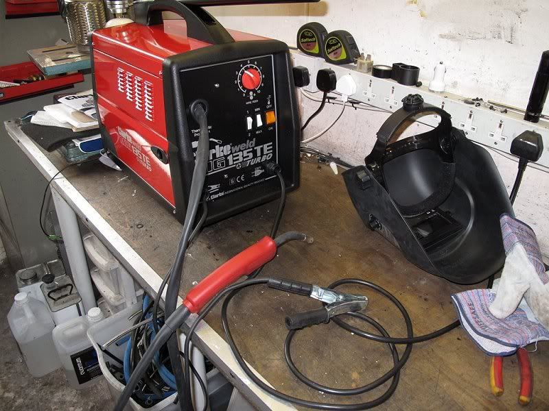

So I cracked the new welder out yesterday and glued my lambda bosses on in preperation for the Motronic management.
It's a nice little machine actually. Does what it says on the tin with no splattering :D My welds won't win any neatness awards but they'll get better with practice and it's only a downpipe which won't be seen :D I wish I'd taken up welding a lot sooner as it's not as hard as I thought it would be!
Clarke 135TE from Machine Mart, £275.
Lambda bosses glued in place.

They are great welders for DIY use. I recommend trying the Co2/Argon mix gas for neater welds.
Yeah I grabbed a few cans of that after doing some research on welding forums :D But I'm just using up the CO2 that came with the welder first whilst practising!
is the left boss bigger than the right one or are my eyes playing tricks?
No they're the same mate. Get yourself down to Specsavers :D
