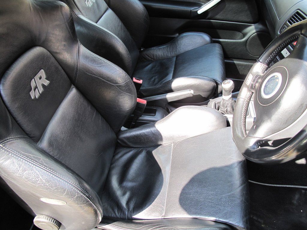

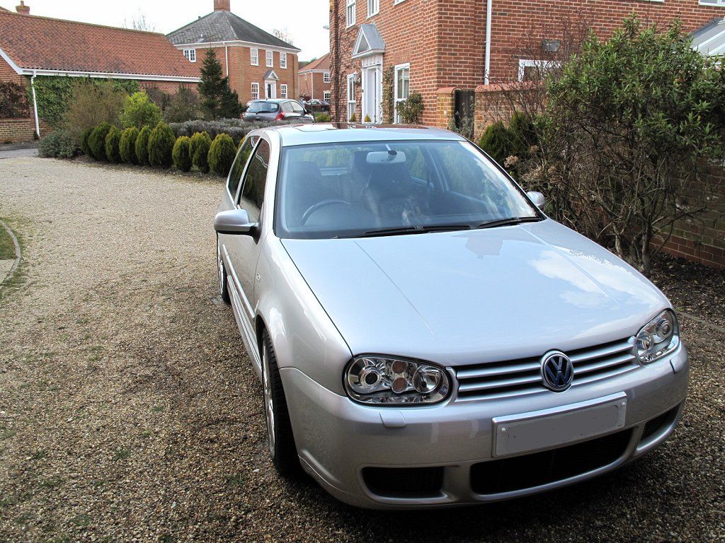

So here it is, a 2004 MK4 R32 with 52K on the clock. I went for a silver one as the blue and black ones are a bit too blingy for me. I like subtle :cool: Standard toys are: Auto wipers, auto dim mirror, xenons & climatronic. This car has the following options: sunroof, full heated leather and cruise control.
I've never really been interested in MK4s in the past but R32s have a real character and is quite a good looking car imo :)
It was completely standard when I got it but I got it remapped at Stealth last weekend. Unfortunately their rollers were broken on the day, so no power run :( It feels about 260ish on my butt dyno though.

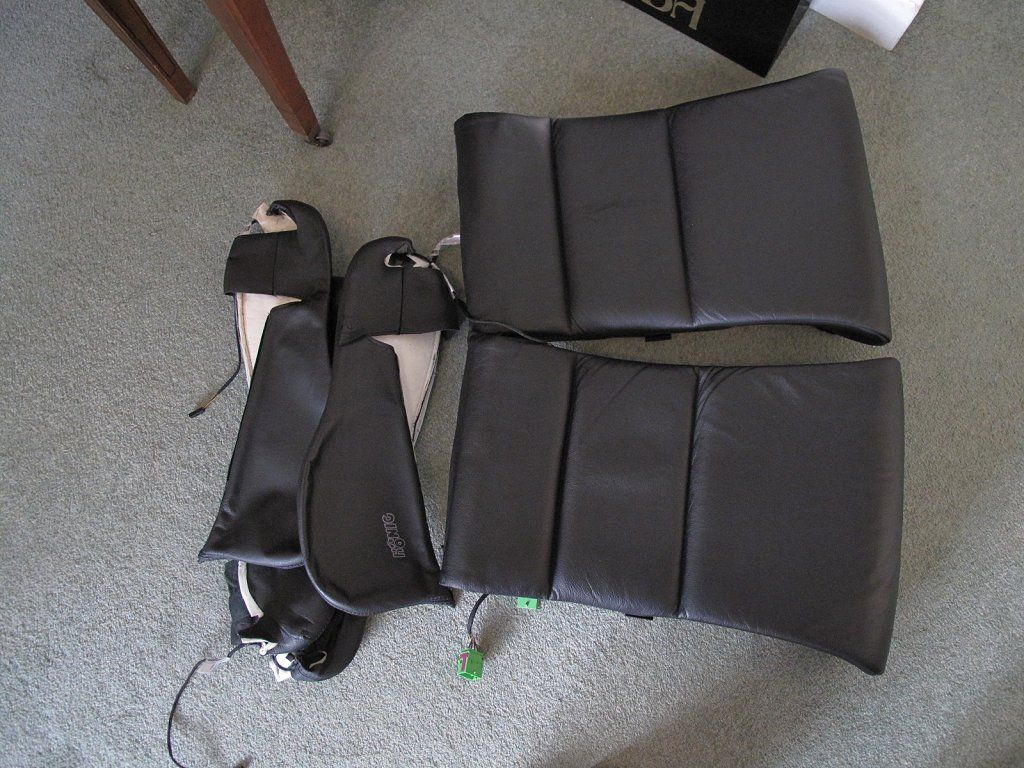

Very rare 3 panel seat bases. I believe they are US spec and weren't available in Europe. I stumbled on them on the R32OC and snapped them up. Reason being, I hate the way the 2 panel bases sag, like this....
They are otherwise hard wearing seats and are extremely comfortable, but these will fix the sagging :) The wires are for the heating. Even the bolsters are heated.

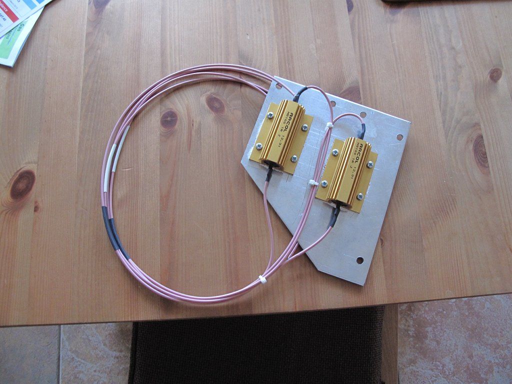

Another mod is a common one. A cooling fan resistor pack. The fans on these cars are 2 speed. Climatronic turns the low speed on when the AC is on to keep the condenser cool (aka A/C radiator) but the resistors built into the fans burn out, so no fans! £400 fix from VW, or a this £45 fix :) Not even the newer VWs are free of fan problems!

What I like about it is I can go into a dealer and they know what a MK4 Golf is and parts are readily available and sensibly priced. I wish that were true of the Corrado!
Having had the pleasure of driving Pat McCrotch's MK5 R32 DSG, the MK4 is a noticable step down in quality, but to me it drives better and you don't notice the engine weight as much as you do in the MK5 or a Rado VR6. Mainly because it's so firmly sprung and damped. MUCH stiffer than either car! There's a few rattles and squeaks I need to tackle but that'll be easy with my experience of doing the same to the Corrado and missing clips and interior panels/parts are readily available!
It's nowhere near as fast as the Corrado was (in it's R32 form) but it can certainly corner faster and flatter though. It's a decieving car in as much as it makes a lot of fruity noises, but you look at the speedo and think "Is that all??!" It was the other way round in the Corrado! The speedo climbed round nearly as fast as the tacho :)
Still, knowing me, it probably won't be long before a turbo finds it's way under the bonnet! But for now, it's fast enough as a daily hack.
If you like Corrados and want to move up to something a bit more modern and has great handling out of the box, you can do a lot worse than a MK4 R!
As ever, my tinkering will be fully documented ;)

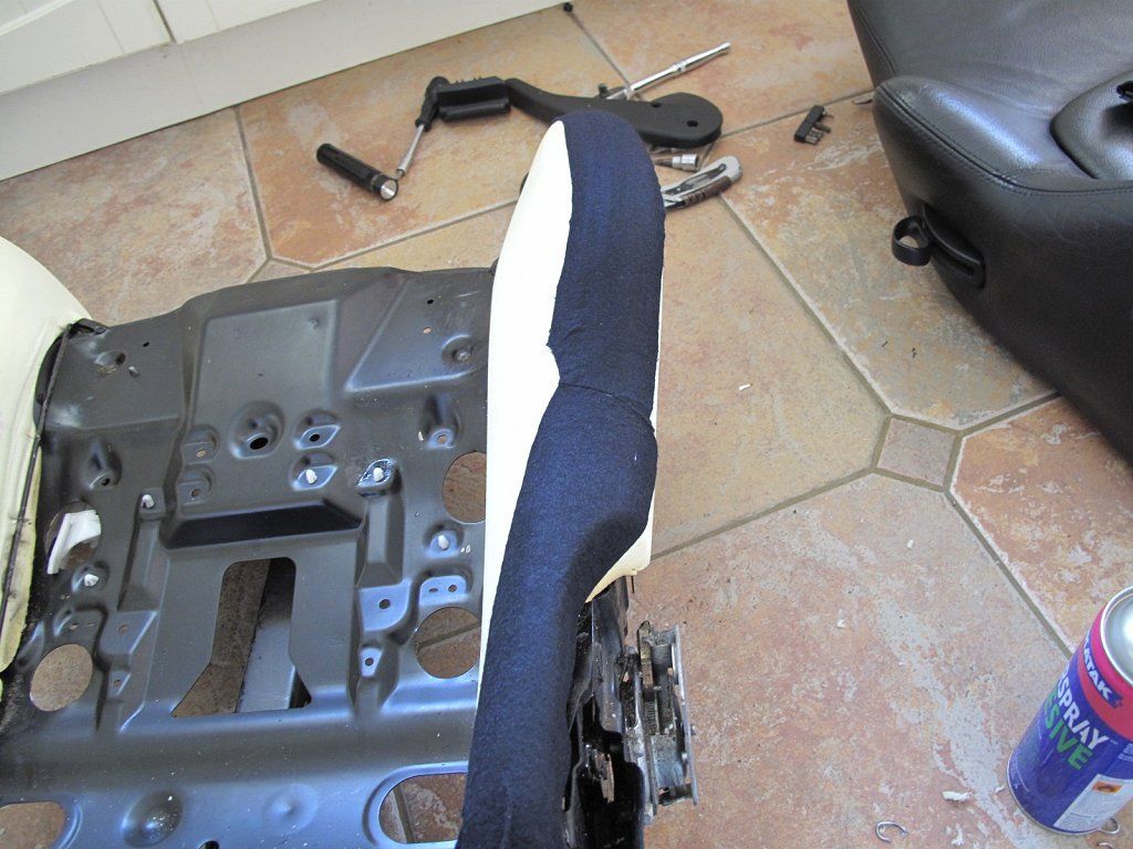

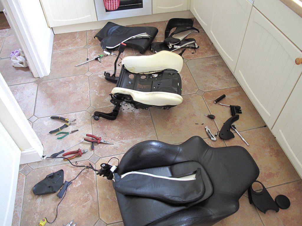

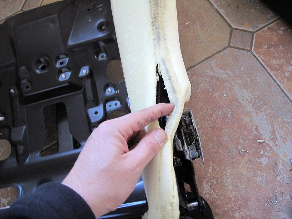

So today I did the seats...
I can see why these cars are 1500kg, the front seats are bloody heavy, but anyway, here's one all stripped down. The seats are fully rebuildable but the leather covers are eye wateringly expensive. Just as well they wear well!
Definitely a deja vu experience, having been here before with the Rado a a few times!
More deja vu. A good example of why people shouldn't sit on the bolster when they climb aboard and get out!
And the usual fix. Self adhesive felt from John Lewis's habberdashery department :) This stuff has cured many a rattle and fixed many a bolster over the years!

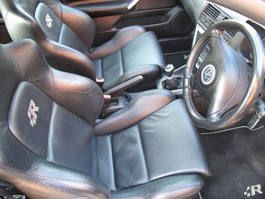

The end result of all that faff was turning the seats from this....
...into this. Much neater I'm sure you'll agree. The 3rd partition in the base should reduce any unsightly sagging as the miles pile on.
That'll do for now! Cheers for the compliments guys :)
