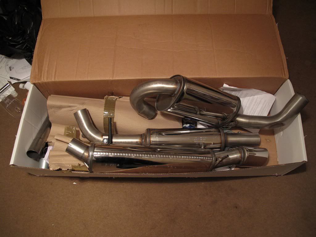

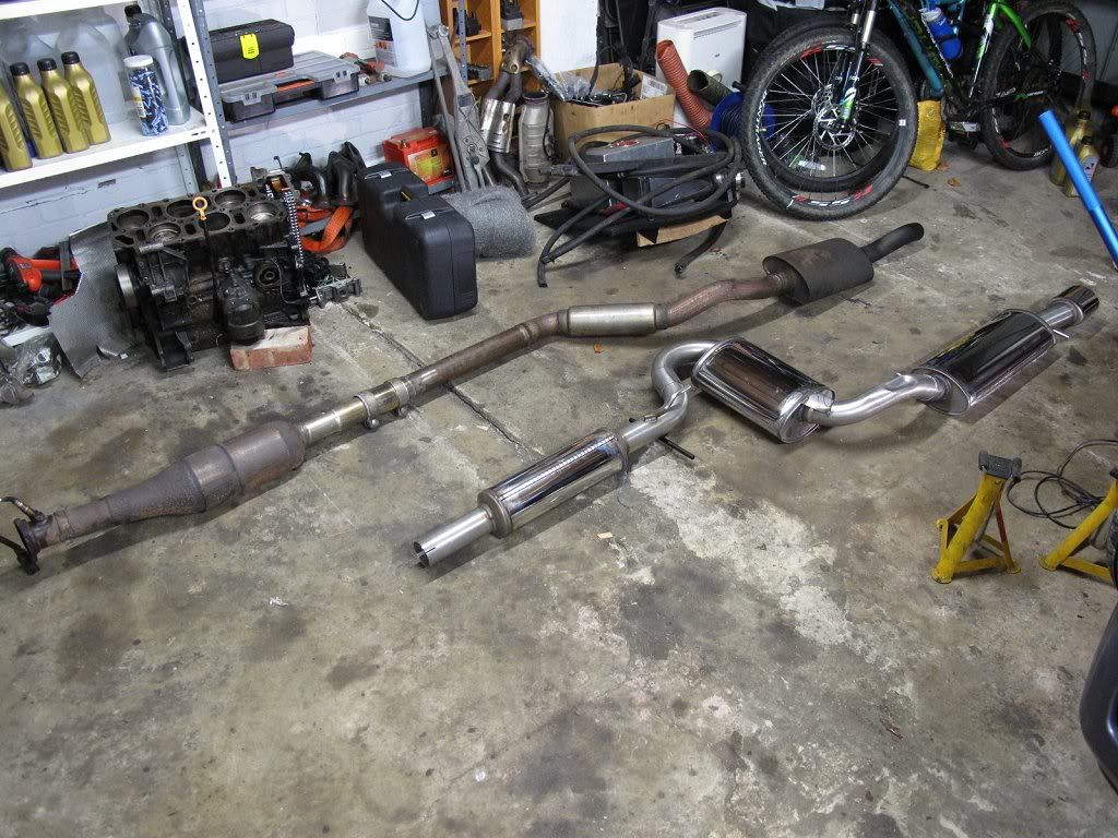

And what Kip means by that is, have I fitted this Jetex exhaust yet, which somehow found it's way into my spare room? :D
Erm, no is the answer. I have a very low enthusiasm for jobs that involve climbing under the car, especially this time of year!
That must be a pretty light exhaust. An OEM one would tear that box to shreds in seconds :lol:

Must have missed it but what wrong with the Techtonics one? I loved mine, perfect sound. Cut the tailpipe of this one and get an OE looking tailpip on.
Yeah it's seen it's fair share of exhausts :D The Techtonics one on there currently is the single silencer one. I did a swap with Leon a while ago for my dual borla one (wish I hadn't now!!). I was going to import another one but they're £450ish before shipping and taxes now!!! The Jetex was quick and easy to get hold of and not too horrifically priced.
That's exactly what I planned to do on mine!

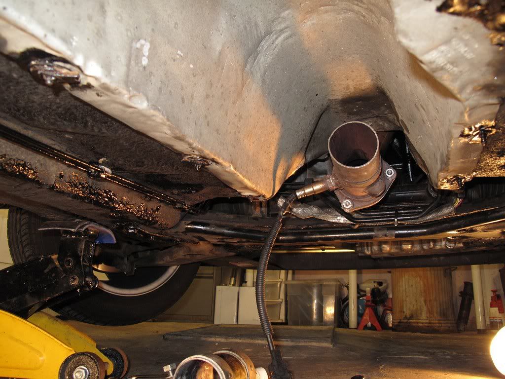

I'm a little gutted. See the first Jetex silencer there? Well it's too darn tight in the tunnel!! There's like, less than a cm's clearance either side of it. Not sure what's going on there but I've decided to bypass it as it's going to clonk. I'll just run the other two silencers for now. The tube drops to 1.5" inside the front silencer anyway, so not sure what that would do to a throbbing great 3.2 litre trying to relieve itself of it's waste gases!!
This means I won't be able to make tomorrow's RR Day as I've had to order some parts :(
I also had to lose the cat. Never mind. No front silencer or cat should make it breathe a little freer! It's all I managed to get done today.
Notice the hammerited brake lines :D I would do yours if they're rusty too. Should buy some time. Top tip for painting them, get a piece of sponge and dunk it in the hammerite and rub it up and down the pipes. So much easier than brushes / spray etc.

Its tight either side of the tunnel ,isnt it kev? I get the occaisonal tap when driving but youve gone for the same system as me expect youve got a big 3.2 in there! the exhaust is a nice sound btw.
looks like they have changed the design from when i bought mine years ago, the first silencer on mine was a lot longer and narrower than that.
