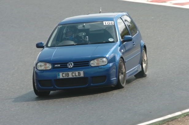

GVK 0 Posted August 5, 2013 (edited) Didn't think I'd ever see the day that you parted with the Corrado Kev! My ex had an R32 from when it was a year old,she had Schrick 264 cams,Milltek sports cats/unresonated system and Revo st 2 map on it in the end, initially had AmD map on it. We took it to the 'ring and did a track day at Spa in the wet, passed pretty much all the super cars in the rain :) Remember seeing 160 indicated on the way back on the autobahn (possibly) *cough* Spa: Over the 4 yrs not a lot went wrong on it apart from a set of coils under warranty and a track rod end which I probably killed on the 'ring going through the Karussell at 50mph+ LOL. Oh and a set of OEM pads every time it went on track pretty much.. Good luck with it, looks a nice example! Edited August 5, 2013 by GVK Quote Share this post Link to post Share on other sites

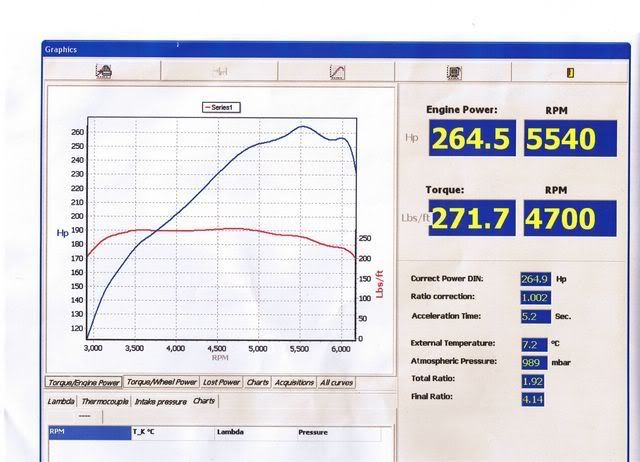

GVK 0 Posted August 7, 2013 (edited) I thought the cams/Revo st2 that were done on the same day made quite a difference to mid-top end. Big Boys Toys (now AmD Essex) fitted the cams and put the Revo on, this wasn't without problems as they had a job flashing the ECU as it had been previously done by 'original' AmD in Bicester and had APR trial software at some point. Mixed opinions if back then (2004) AmD could actually flash via OBD port or they did a chip change! They were 'only' the 264 cams and sadly BBT didn't have their dyno back then for any before/after comparisons. I do have somewhere a graph from a dyno day at Chipped UK which is now Viezu in Bromsgrove, it's on my Photobucket somewhere I'll have a look and post it up. Had a weird running issue with the Revo which they sorted out at Daventry (I've been friends with Kev Hall who's worked there from from start for years) Apparently the rev limit had been set at 8k rpm and it had a timing curve suited for race fuel LOL. I think as they were struggling with the ECU at BBT they may have used a file from their VW Cup R32, but that's my opinion.. When I was working for Listers VW I drove a stock one and it felt as flat as a fart. Still have the mk2 but it's been sat there 3 yrs unloved, I've had health issues unfortunately. Edited August 7, 2013 by GVK Quote Share this post Link to post Share on other sites
GVK 0 Posted August 7, 2013 (edited) Here's the graph. It was a proper 4wd rollers not just FWD with Haldex disabled, as I'm led to believe there can be differences in power output with the car not allowing full power on the dyno in 4wd mode. BMWs are the same, M3s/M5s etc need fuses pulling and in some cases a 'dyno-mode' being enabled on GT-1/DIS diagnostics. Might explain peak power only showing as 5540rpm?? vid too! It also went on Awesome GTIs rollers with similar results, don't think I have the graph anywhere for that though. Vid from Awesome GTI, run in FWD mode. As ever 'dyno-lottery' comes into play! Back in the day AmD used to claim 270hp for an R32 with remap/exhaust They used to claim 300hp for R32 with cams/remap/exhaust. This was obviously boll0cks! Edited August 7, 2013 by GVK Quote Share this post Link to post Share on other sites
Kevin Bacon 5 Posted August 8, 2013 Yeah I have experience of AmD from Geoff Everett's days too and the exaggerated dyno numbers :) It takes a bit more then cams and exhaust etc to get to 300hp and more, but it's mainly the intake manifold holding it back. I think I might give the cams a whirl to be honest, it would be rude not to! That's good power and torque at those rpms, especially the torque. It normally falls off past 3.5 ish K on the standard car, so the cams are keeping it going past 4K. That's good going! The power drops off at 6K sharply doesn't it, so not sure what happened there! Sorry to hear you've had health problems. Hope you're mended now, or on the mend! Nice clip! Rs do sound superb imo :) Quote Share this post Link to post Share on other sites
