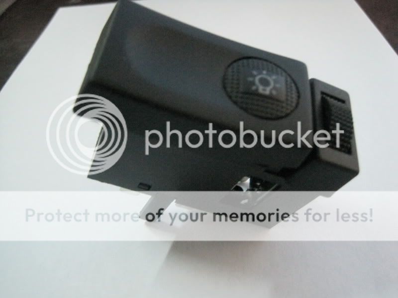

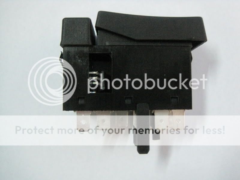

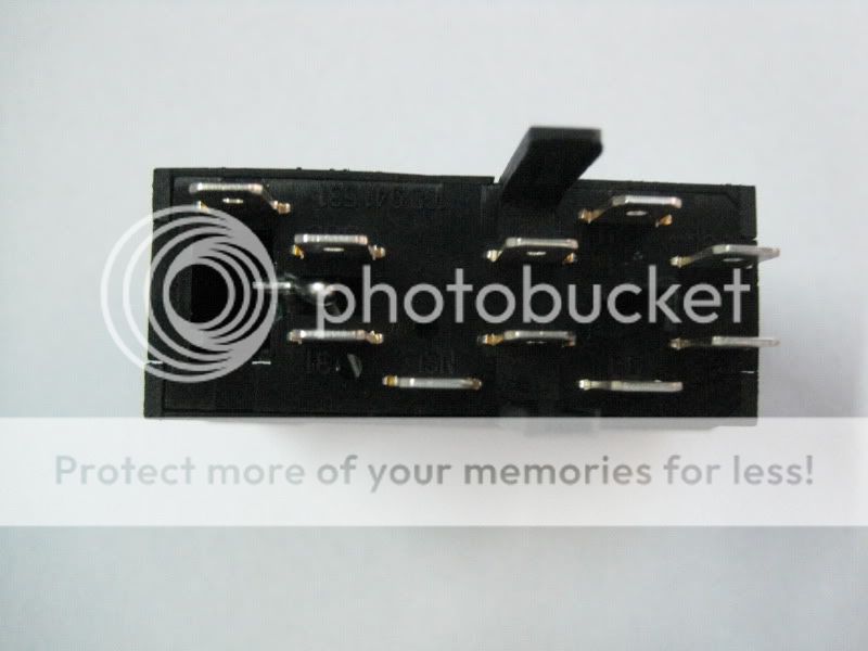

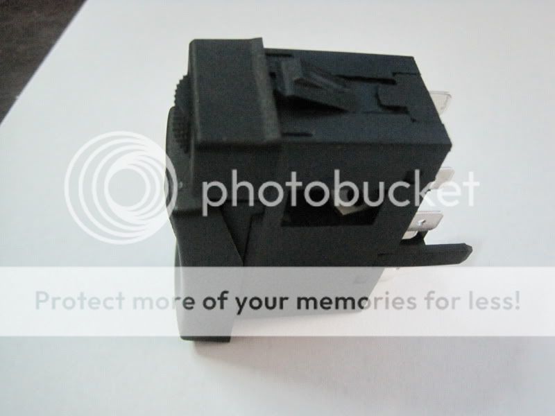

8vMatt 1 Posted July 4, 2011 Had a few emails back and forth today. The headlight switch is a direct replacement unit and the pic shows the pin layout the same as a new VW switch I have at home. The colouring when lit up is like this- the round outer colour is green and the middle is red. Thats the same as OE isn't it guys? Can't remember at the moment. Just need to pay now!!! Gulp :gag: haha. Some more pics to help out- Quote Share this post Link to post Share on other sites
RW1 0 Posted July 4, 2011 (edited) The key way will need to be knocked off as its not the correct orientation as a 535 941 531F on UK post 1992 C's. Also, what does that electronic 3 legged item inside do??? I'll guess it some kind of voltage regulator to dim the voltage to the dash lamps. May affect the way LEDs work if anyone has substituted the dash bulbs for LEDs. Pin 56D is missing which controls the dim-dip (yellow wire in loom connection) if anyone still uses that??? The pin is positioned just below the part number. The switch base connections look to be the equivalent of 535 941 531D. LHD Corrado fit which makes sense with China. Unless the pin idents have moved, it should work. . . Edited July 4, 2011 by RW1 Quote Share this post Link to post Share on other sites
8vMatt 1 Posted July 4, 2011 RW1, I trust your Corrado and VW knowledge, are you saying this is a go then? I'll ask about the 3 leg part inside, would many people have LEDs instead of bulbs in their dashes? Is pin 56D much of an issue as I don't know about the dim-dip, could you expand please? Thanks for your input. Quote Share this post Link to post Share on other sites
RW1 0 Posted July 5, 2011 8vMatt said: RW1, I trust your Corrado and VW knowledge, are you saying this is a go then? Is pin 56D much of an issue as I don't know about the dim-dip, could you expand please? Thanks for your input. Won't be buying as I have enough existing modified switches. Just so happens I have one of each of the switches (Euro/UK) on my study desk I was repairing last night. As said, yes I think they should work from China with the plastic keyway peg knocked off. I can't make out in the photo the pin connection idents (engraved on the base plate of the switch by each pin) ie X, 31, 56, 56e etc. 56D missing shouldn't be an issue unless someone is wanting to retain the dim-dip. Dim-dip is the side lights on and also the headlights on at less than full brightness with the sidelights only selected on the switch. The dim-dip systems is the wire wound resistor and yellow wiring behind the left headlight. A yellow wire also runs to the dash connector (pin 56D) at the back of the headlight switch. If not connected, it doesn't really matter but if someone is using, I mention it for reference. All VW's of the era had this, not just the Corrado. The unknown for me is the 3 legged electronics in the photo. In my jotting above, I assumed it replaces the rheostat resistor in the original switch which controls the brightness of the dash illumination on dials and switches. My concern here is whether the output supply is "chopped" to reduce voltage. That will work with filament bulbs but LEDs unsure. Somebody with more knowledge of modern voltage control my be able to enlighten, so I raise it as a caution given I know some on here have converted dash switch and dash dial illumination to LEDs. Pity a one off sample couldn't be sent over to try. . Quote Share this post Link to post Share on other sites

8vMatt 1 Posted July 5, 2011 A bit of another update to keep you guys going :thumbleft: The three metal strips are indeed to do with the dimming of the switch light inside the car. And an unexpected result, I asked about getting a sample not thinking it could be possible to get just one BUT they said just send my courior to pick it up from us :dance: . Guess I'll be a guinea pig to try it on my car Keep the interest coming, I'll pm people when we're in a position to proceed and prob start a new proper group buy thread when the time is right. Quote Share this post Link to post Share on other sites
