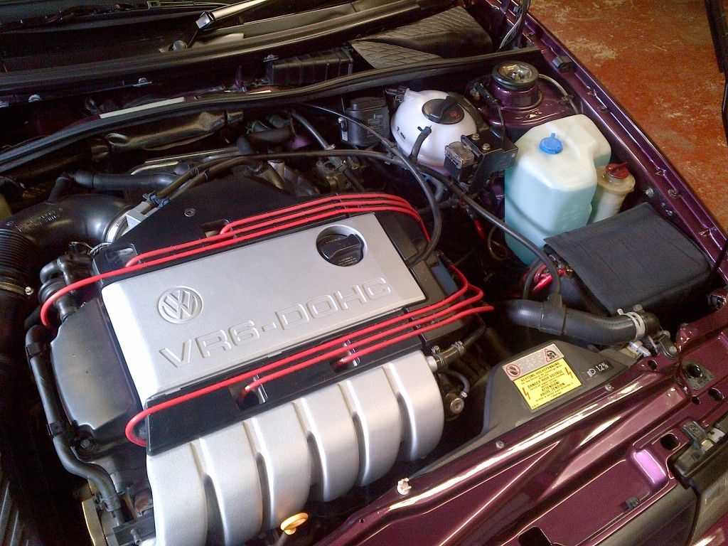

ChrisL 20 Posted June 29, 2012 Well the Corrado went straight through the MOT today with no advisory's!! It was long overdue a service so this was done and I also had the coolant flushed and a new expansion tank fitted!!! Quote Share this post Link to post Share on other sites

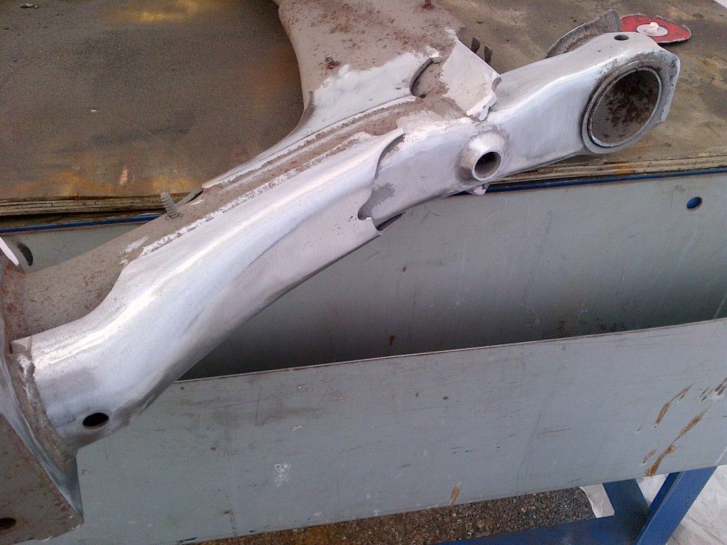

ChrisL 20 Posted September 19, 2012 Right so here you go, new wheels: Started to clean up the rear beam prior to powder coating, I'm grinding any sharp objects that may cause a weekness to the coating and also want to smooth any of the pitting. And just a photo from a recent classic car event, just cos I really like the picture. Quote Share this post Link to post Share on other sites

VW_OwneR_85 2 Posted September 25, 2012 ChrisL said: , I'm grinding any sharp objects that may cause a weekness to the coating. that sir is a blady good idea! new wheels look good btw! Quote Share this post Link to post Share on other sites
lilfuzzer 1 Posted September 26, 2012 Sweet rims Chris also nice work on the beam liking that Quote Share this post Link to post Share on other sites
BILLCOR 1 Posted September 26, 2012 Good job on the rear beam Chris and liking the new rims , but I think I preferred the other ones :grin: Quote Share this post Link to post Share on other sites

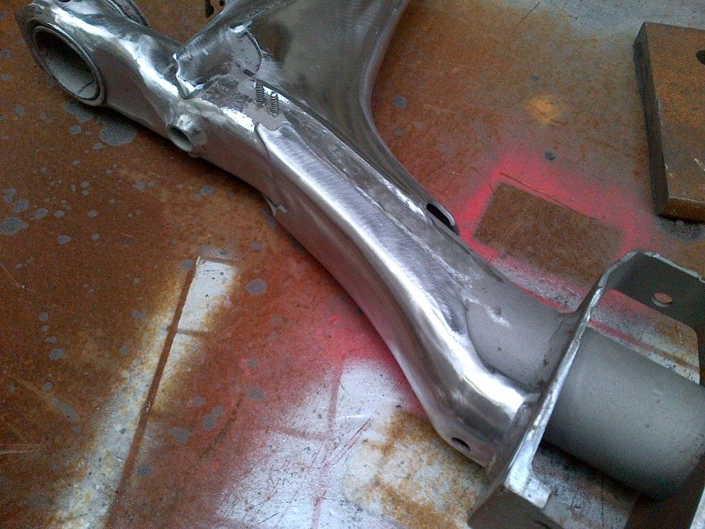

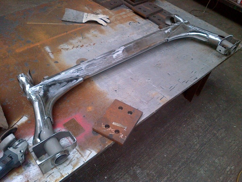

ChrisL 20 Posted September 26, 2012 Cheers, the rear beam is taking some time as I only get some of my dinners to do it in. Going to get the ends of the roll bar capped as I dont think powder coating will get in there and its a corrosion point. Quote Share this post Link to post Share on other sites
ChrisL 20 Posted October 5, 2012 Beam is ready for blasting again and powder coating, took some time but it should look like new when done. Last drive in the car before winter hibernation tomorrow I think. Quote Share this post Link to post Share on other sites
James. 9 Posted October 6, 2012 I'd just lacquer that one and fit it. Really looks that good. Quote Share this post Link to post Share on other sites

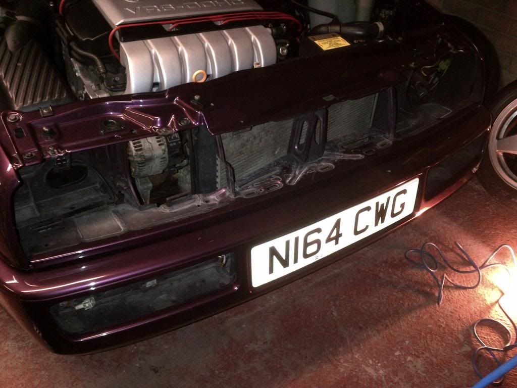

ChrisL 20 Posted November 11, 2012 Rear beam, brackets and brake sheilds have gone back for blasting before powder coating so thought I would crack on with the front end, quick half hour tonight and I'm left with this: Not looking forward to undoing the 4 bolts that hold the front bumper in place as I've read they can be very tight! If anyone has any advise on this then its very welcome... I'll keep the updates coming as quick as I can but working away a bit so havent been getting loads of time. Quote Share this post Link to post Share on other sites
swiftkid 1 Posted November 11, 2012 Looking good, havn't seen it for a while guess with winter here its tucked away! Yes they are most likely tight, could try give them a WD and then use a wrecker bar, the condition of your car I doubt they will cause too much problems *touch wood*. Just remember to leave the middle bolt alone, last thing you want is the engine dropping on you!!! Quote Share this post Link to post Share on other sites
Hofmiester 10 Posted November 12, 2012 Good job mate, I have a blackberry myself and I'm steadily working my way through it. This is a real inspiration! Quote Share this post Link to post Share on other sites
coullstar 0 Posted November 12, 2012 If you can get some PlusGas in about the bolts before trying to take them out. Quote Share this post Link to post Share on other sites
Jim 2 Posted November 12, 2012 And I guess make sure you have some Irwins on standby, and get ready to go order some replacement ones from VW if they resist coming out! Quote Share this post Link to post Share on other sites
