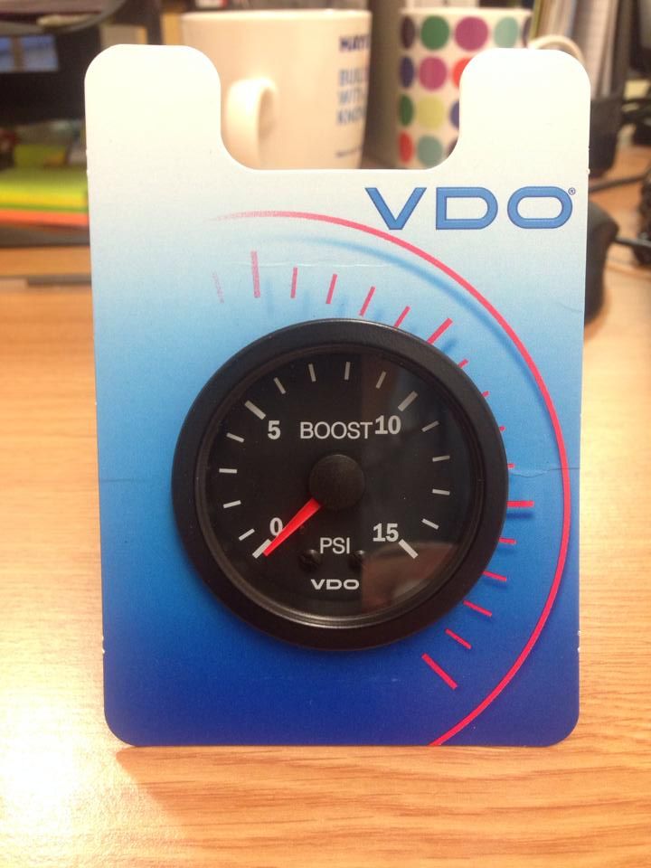

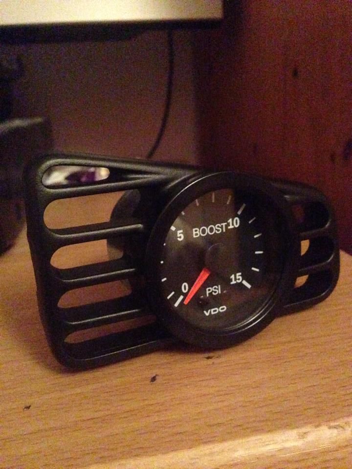

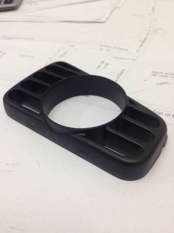

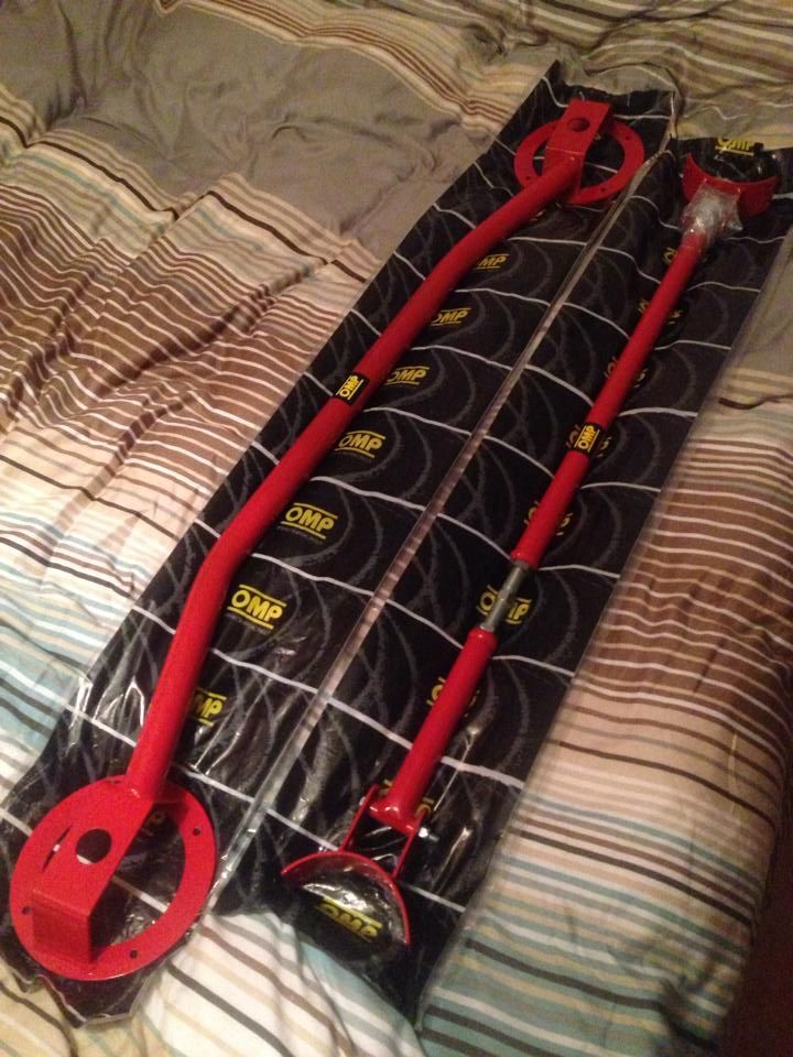

EJ Taylor 22 Posted December 5, 2013 (edited) Latest on the list is front and rear upper OMP strut braces Really looking forward to fitting these! :dance: Also the SWG Motorsport vent gauge pod arrived :dance: waiting for the VDO gauge to arrive from the states now Also instead of rear seats there is now a twin slot ported JL Audio box as below in there as a temp until we do the interior build over Christmas http://www.jlaudio.co.uk/cp212-w0v3-car-audio-basswedge-subwoofer-systems-93283 so that will be up for sale soon after crimbo so give me a shout if you want to have first dibs Will stay updated. Peace! Edited December 5, 2013 by EJ Taylor Quote Share this post Link to post Share on other sites

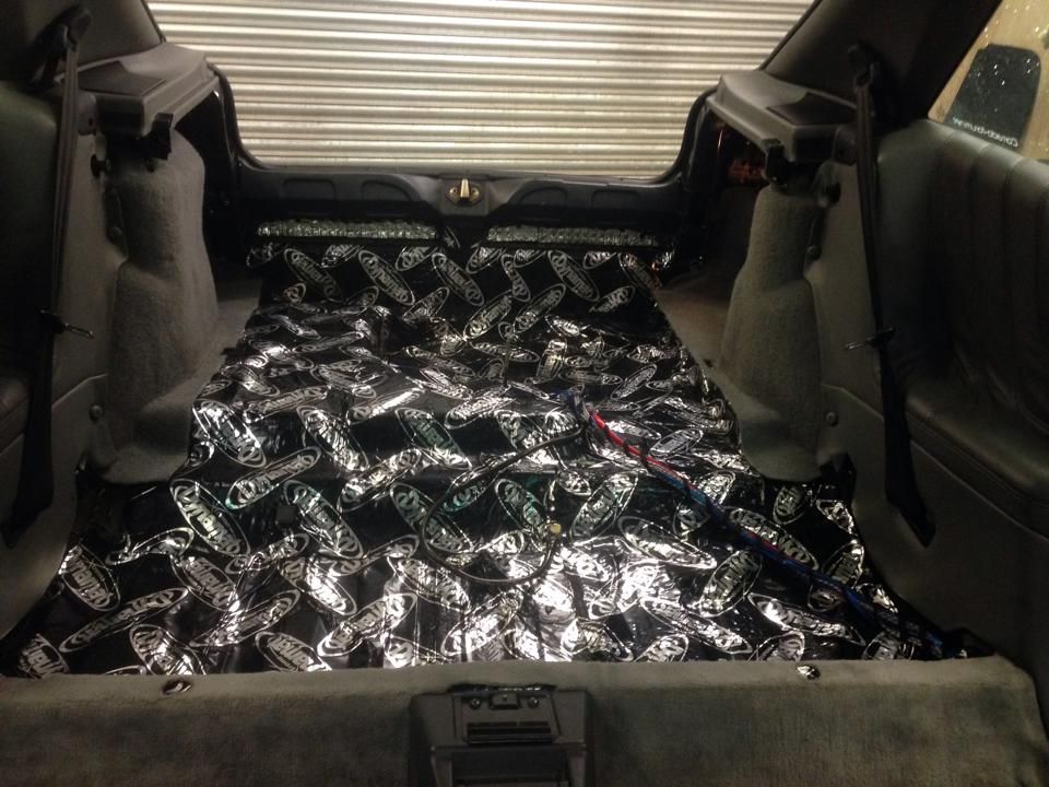

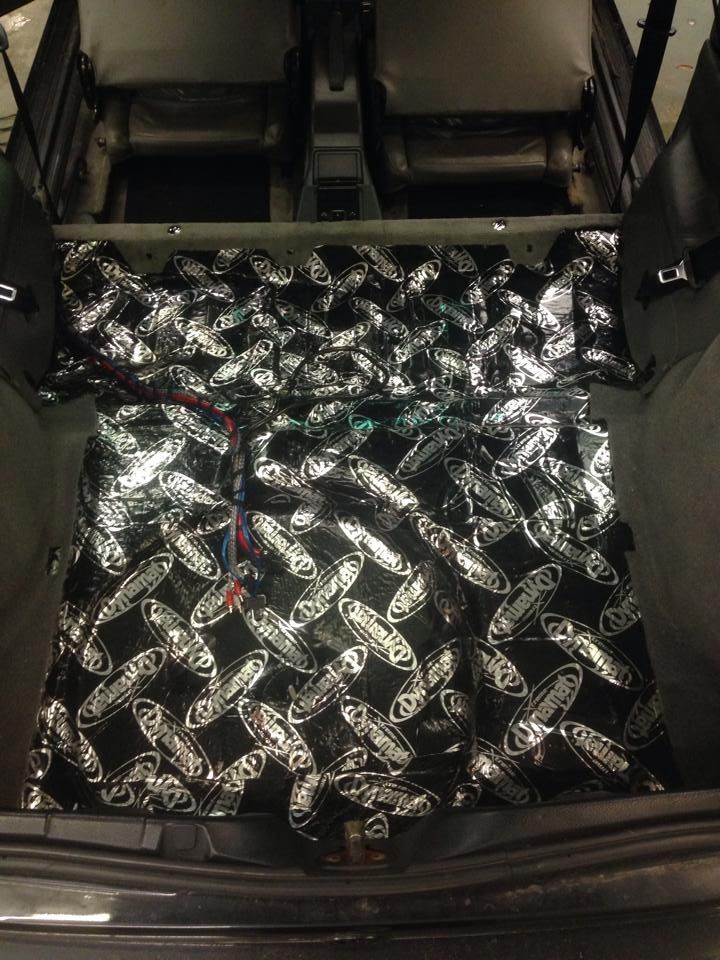

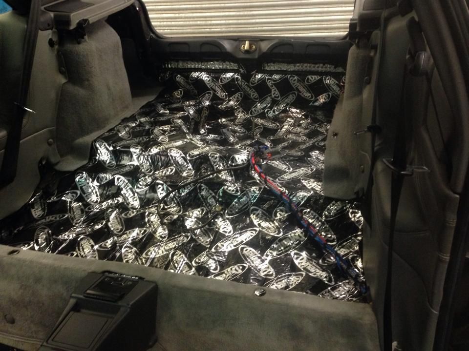

EJ Taylor 22 Posted January 31, 2014 Just some updates, havent been on for about a month! Cars been locked up since really. To much on the list, For now though, after speaking the the owners at Oxford car audio and the uk sales team from JL Audio we decided my car would make a lovely JL Audio/ Oxford Car Audio demo car, which is sick! So me and lemi (owner at oxford car audio, man who build the alpine R32, Alpine Passat CC and many more iconic demo cars) have been doing some sketches, we will be converting it to a 2 seater as ive wanted to do that since day one, and installing 2 JL Slash amps (Beautiful things!) along with 2 JL Audio W3's how its all laid out is a bit complex to explain, but ill upload some of out pencil sketches next week. will be incorporating the rear strut brace with some awesome design features by Lem. For now i got busy the other day with my JL Supplied HUGE box of dynamat. needed to do this as i have nothing in the back ATM the road/zorst noise was killer! (almost managed to make it look like its all done with one sheet :dance: The sweeeeeet little VDO PSI Gauge came from the states as well. Looks sick, such nice quality, very in keeping with the rado dials and so much nicer than all the other gauges ive seen. and together with the SWG pod :smug: And then a standard looking pretty photo! Although atm it sat on speedlines on front and cups on rear due to a puncture. not guna lie, its sorry for itself atm. But now my financial situation has recovered all works will be back under, need to fit the braces, the pod and start the timber work for the build. More to follow! Hope you are all well!!!!! Quote Share this post Link to post Share on other sites

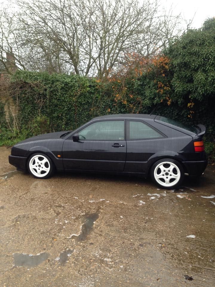

sexybourbon 0 Posted January 31, 2014 Nice work mate big plans ehh , sure it will be a nice build well done on getting it to demo car thats quality Like that little guage too will look nice when its fitted Can you post the specs up of your wheels and adaptors mate i really do like them alot , probably one of the only wheels id swap my speeds for Quote Share this post Link to post Share on other sites
Sean_Jaymo 0 Posted January 31, 2014 Nice gauge! I assume it lights up green? Quote Share this post Link to post Share on other sites
EJ Taylor 22 Posted January 31, 2014 Nice work mate big plans ehh , sure it will be a nice build well done on getting it to demo car thats quality Like that little guage too will look nice when its fitted Can you post the specs up of your wheels and adaptors mate i really do like them alot , probably one of the only wheels id swap my speeds for Cheers man :) Wheels are porsche cups 7j on front ET 50 9j on rear ET 70 on 40mm 5x130 to 5x100 spacer/adapters, currently running 205/40/16 on front and 215/40/16 on rear. soon to be changed for wider tyres alround :) :salute: Nice gauge! I assume it lights up green? yes mate, same as the rado :) Quote Share this post Link to post Share on other sites

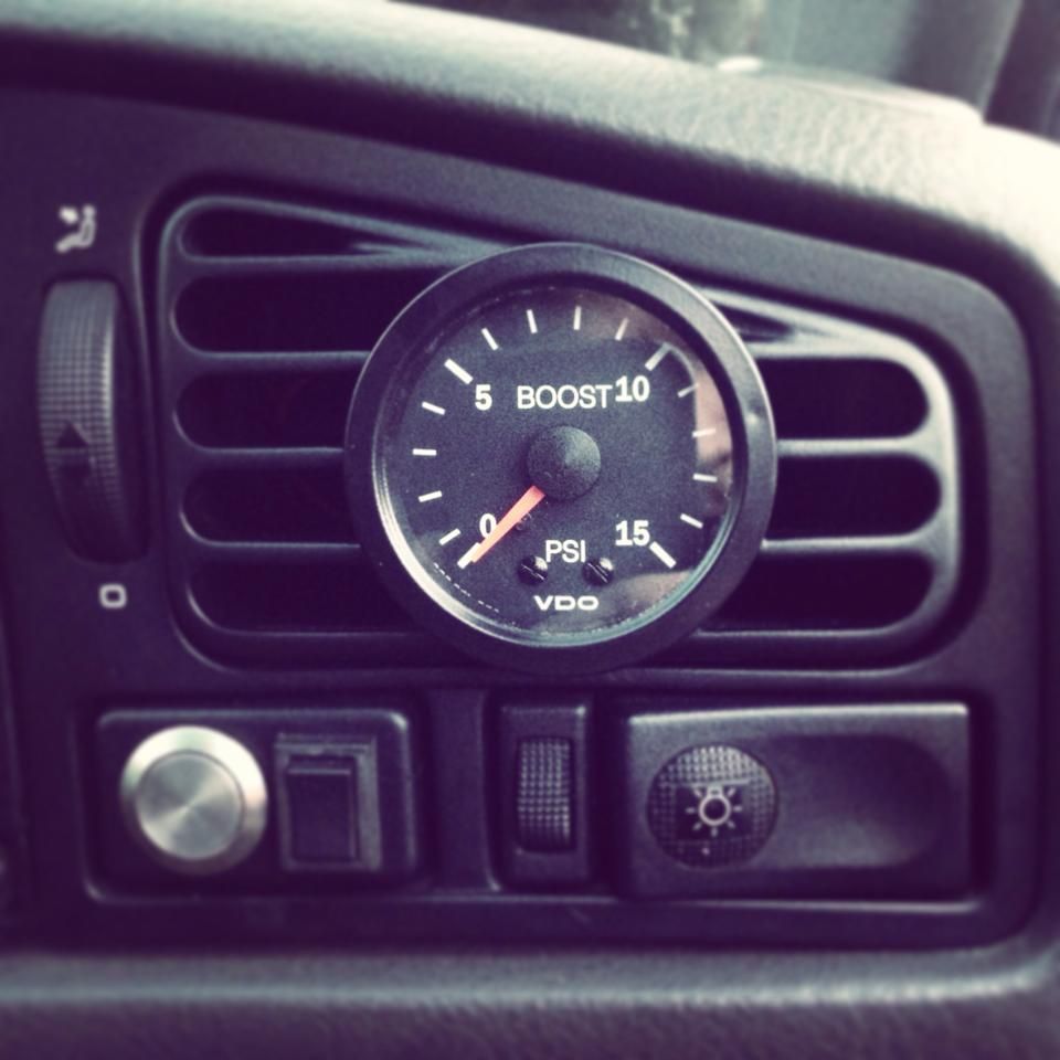

EJ Taylor 22 Posted February 27, 2014 had a day off yesterday so got a few bits done including the gauge and vent pod fitted. Looks sick! and nice to have the more accurate PSI gauge over one measuring in bar. Also got a brand new Bosch battery and Bosch Starter motor. After i fitted the above i went for a drive being a nice dry sunny day, and i honestly forgot just how savage the car is. With all the mods made it an animal, and the more i gain control over the constant battle with traction in 1st 2nd and 3rd the more im really starting to realise how quick the thing can go. Fell in love all over again. Now those little bits are done ive started the shopping list for a good service, so for those who care more to come.. Hope you're all well! Quote Share this post Link to post Share on other sites
poll250 0 Posted March 2, 2014 Nice work. I butchered my centre air vent to fit a boost gauge a few years ago, but it looks good in the side vent too. I've seen this around Oxford a few times and it does look great. Quote Share this post Link to post Share on other sites
wbx6dan 10 Posted March 2, 2014 nice job ! i like the psi gauge im running one in bar ! i do miss the vent though Quote Share this post Link to post Share on other sites
EJ Taylor 22 Posted March 3, 2014 Nice work. I butchered my centre air vent to fit a boost gauge a few years ago, but it looks good in the side vent too. I've seen this around Oxford a few times and it does look great. thanks man! you local? should come to the DCO meets! nice job ! i like the psi gauge im running one in bar ! i do miss the vent though Went for the PSI just because of reading accuracy, the charger only runs at 9psi so a bar gauge wouldn't show me f all really! and yes, the vent pod is a really nice product Quote Share this post Link to post Share on other sites

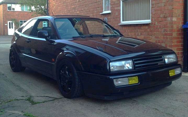

mic_VR 3 Posted May 30, 2014 That looks mean!!! Love it! Quote Share this post Link to post Share on other sites
Dox 23 Posted May 30, 2014 That looks mean!!! Love it! Agreed Quote Share this post Link to post Share on other sites
sexybourbon 0 Posted May 30, 2014 Like it mate it does look good but i think the white was more my taste and style they seemed to stand out more , nice work as always though mate keep it up Quote Share this post Link to post Share on other sites
EJ Taylor 22 Posted June 2, 2014 That looks mean!!! Love it! Agreed Like it mate it does look good but i think the white was more my taste and style they seemed to stand out more , nice work as always though mate keep it up thank for all the kind words chaps! photos dont really do it justice to be fair! Hopefully see a few of you at one or 2 shows this year as well!! Quote Share this post Link to post Share on other sites
