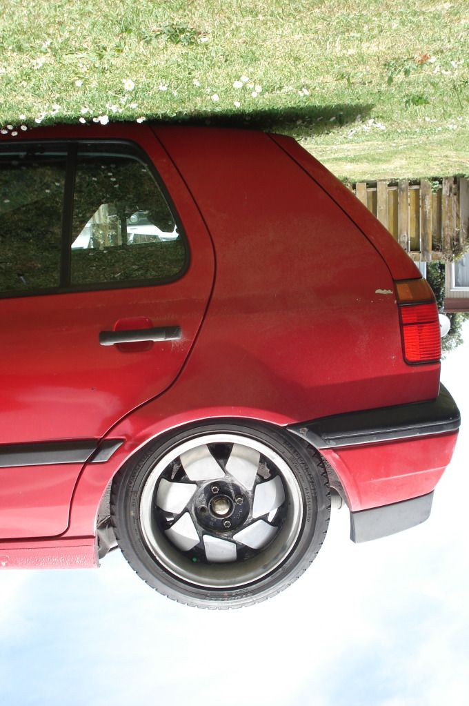

VeeDub_NZ 0 Posted March 1, 2012 Just a few of the sets I had at the time Here's a little trophy I built for a show that we started called Stance Off (http://www.facebook.com/stanceoff) I then polished up the original 1" lips for the other set I had and sold them to a nice guy in Luxembourg with an E30 cabriolet. Then I found a little mk1 golf which had not been registered or warranted for 10 years and had sat in a field on Waiheke Island. It was totally illegal to drive it on the road, but I thought it'd be a bit of fun. Over the weekend, I transformed it into the "RatPig mk1". The pig part being the police theme :stickoutt I took the springs out of this thing, but it still wasn't low enough. So we chopped the bottom off the shock housing, dropped the inserts about 30mm lower (through the bottom of the shock), and welded the insert in place. The shocks were ****ed anyway so it didn't matter. Anyway, by that time, there was one little thing on each panel of the car that ****ed me off, so I went balls deep and had a full respray in the original colour. At the same time, I had all the guards hammered dead flat, removed the rub strips from the doors & smoothed the front bumper. Still unhappy with the ride height, I bought some new FK Konigsports from Venom in the UK. They are height & damper adjustable, and they go lower than the V-****s do. Nice. Oh, forgot to say I had a 24v VR6 motor and VR6 O2A box lying around that was meant to be for the mk1 rocco. But I was bored of the 1.8 16v so decided to whack it into my Corrado instead. This meant I needed a facelift bonnet, in a country located at the asshole of the world, with 10 nz new corrados (all with the early bonnets) and about two imported cars with the facelift bonnet. ****. Even Germany wouldn't supply me with one after they had quoted me $2,000 to get one. I was running out of options, but luckily I keep tabs on all the other Corrados in the country, and had remembered meeting a nice guy with a facelift 2.0L 16v. I had stayed in touch with him for years, always wanting to buy the car, but he didn't want to sell it. I thought i'd flick him a text and ask if he wanted to sell me the bonnet. 'Nope, but i'll sell you the car'. That night, I bought the whole car... just for the bonnet. I swapped bonnets, and a couple of other little bits, and sold the car three days later to a young dude in Hamilton. This was the car. For those who don't know - the facelift bonnet has a lump in the middle as you can see, which allows an extra 2" of clearance required for a VR6 swap. Motor in, bonnet on, things were underway. I had sent the ECU away to a guy in the Isle of Man to get remapped & deimmobilised. When we got it back and plugged it in, it wasn't deimmobilised :mad Turns out he had never done one to the point where the car was still running corrado clocks & key. So 13 days out from the SO2013 (Stance Off show) that I was organising, I thought I was f*cked. Stealth Racing to the rescue! Within 6.5 days, I had expressed the ECU over to them, had the immo removed, tested, and expressed back to me. I try to forget that I spent $400 just posting an ECU around the world! But I got it back in time for the show and the car was all go. The radiator came in from ECS in the states, and left us no room to mount the fans on the engine side. So we whacked two big 12" and 10" fans on the front side of the rad. These things blow way harder than any girl I've ever come across! The motor is 204hp standard out of a V6 4motion mk4 Jetta with 77,000kms on the clock. It's now running a remapped ECU, BMC air filter, new Sachs clutch kit, Powerflex nolothane bushes all round, mk3 subframes, 2.5" catback exhaust & solid front engine mount. I haven't had a chance to dyno it yet but I imagine it'll be somewhere around 220 - 230hp. I got the exhaust done, 2.5" cat back with one resonator & a small back box. It sounds awesome, doesn't drone at motorway speeds and is nice and quiet, but when you put your foot down you hear it alright... Then I found an oldschool NOS wooden BBS steering wheel, rare as a rare thing. I got it for $50 too! Put that on (excuse the filthy interior and missing dash bits in this pic) I also gathered together a full set of original half height centre caps for the wheels - quite hard to find. I had them polished and whacked some new badges in to freshen the wheels up. They look 10x better than the aftermarket ones! Quote Share this post Link to post Share on other sites

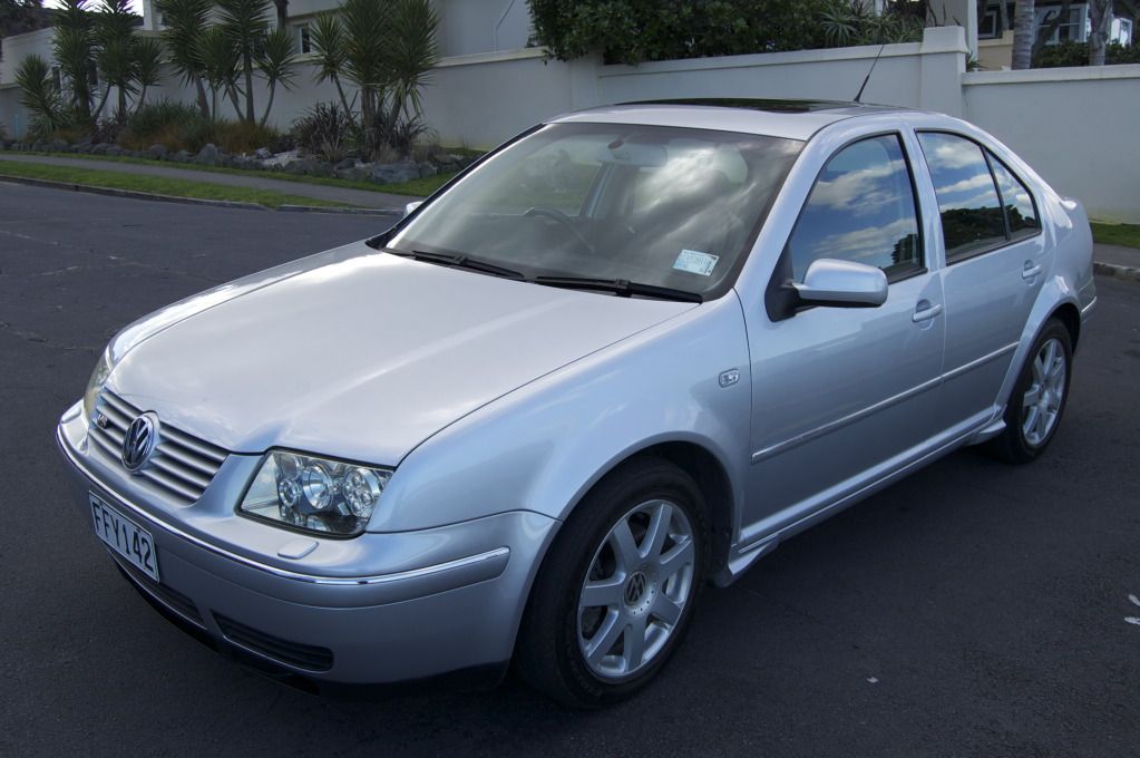

VeeDub_NZ 0 Posted March 2, 2012 Thanks for the comments. So at this point, I've bought 5 cars to get this car to where it is (actually 6 kind of...) The first was the black corrado, second was the E30 for the wheels, third was the facelift import car for the bonnet, fourth was a mk3 GLI that I bought for parts, I used the subframes out of that, fifth was just a Mk4 Bora V6 4 motion 24v that I just bought to make money off, but ended up driving as a daily for a few months, which was what sold me on this motor swap. Here's the other two unsung heroes of that story: Quote Share this post Link to post Share on other sites
