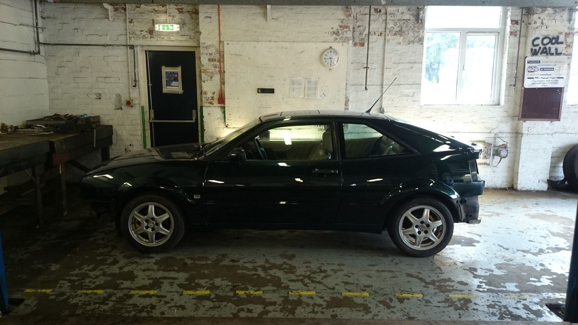

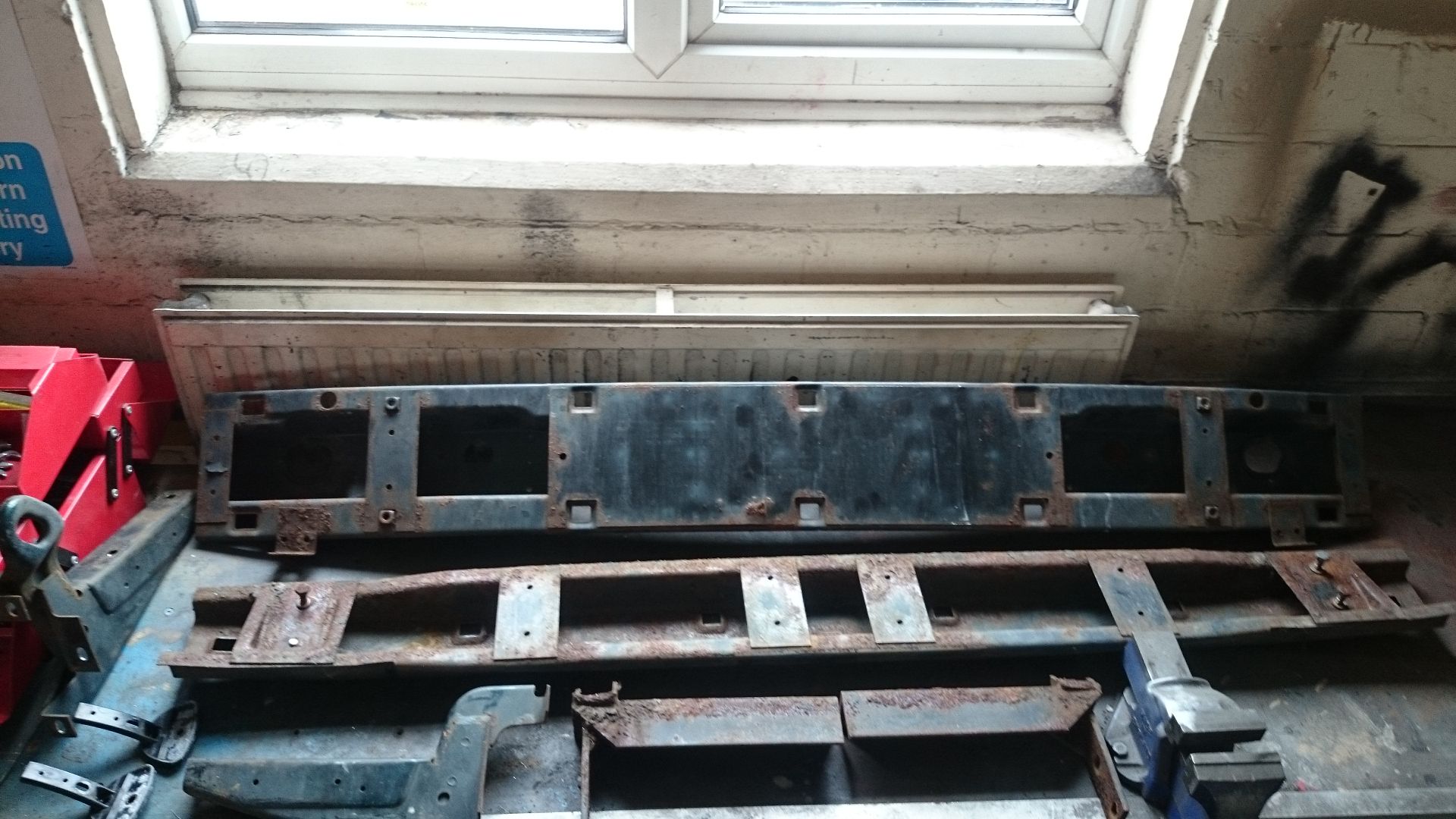

seanl82 23 Posted June 26, 2014 Car now off the road and strip down has begun. Back on the Solitudes ready for the RXs to go off for powdercoating next week. Need some fishing line to get the rear Vr6 and Storm badge off, and I'm having an utter mare with the boot hinge trims, and rear number plate tub. The tub has obviously been off in the past as its been painted body colour, and I think it's been bonded back on with God knows what. Got a few bits to go off for powdercoating too. The rear bumper iron is in a pretty sorry state tbh, and one of the support bracket bolts sheared. Hopefully it's salvageable though. Ordered a few bits from Heritage last week. Got both scrapers and both door aperture seals along with a few other little bits. I'll put my ARZ order in next week. The couple of reasons for taking it off the road a little early were to preempt any problems I may find during stripping it down, and also the MOT was about to expire. A couple of little bits that need doing were an outer cv boot, and finally trying to get to the bottom of my ABS problem. I couldn't be bothered to just change the boot knowing the front subframe will be dropped probably over winter, so I just bought a whole aftermarket drive shaft with CVs already on as it was only £31 to my door. I'll refurb the originals when I do the rest and put it all back together then. More updates soon. Quote Share this post Link to post Share on other sites

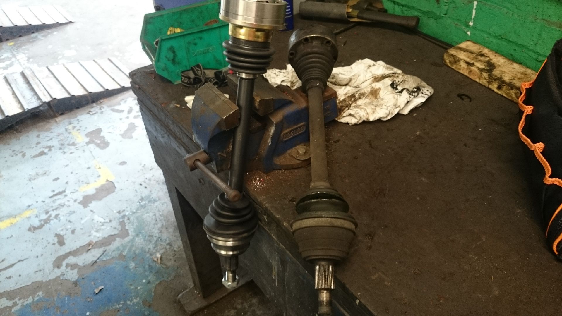

Macdaddy 10 Posted June 27, 2014 Ooooh shiney driveshafts! Where was that from? I'm just about to strip down the front end and replace all the track rod ends etc, May swell do the driveshafts too at that price! Quote Share this post Link to post Share on other sites
seanl82 23 Posted June 27, 2014 It was an eBay seller called vwolbay. Think he has a couple of cv joints still for sale at the moment. I'm not sure of the quality tbh, which is why I'll put the originals back on once refurbished. I'll get the shafts powdercoated and all new inner and outer joints and boots. These will do for now though. Quote Share this post Link to post Share on other sites

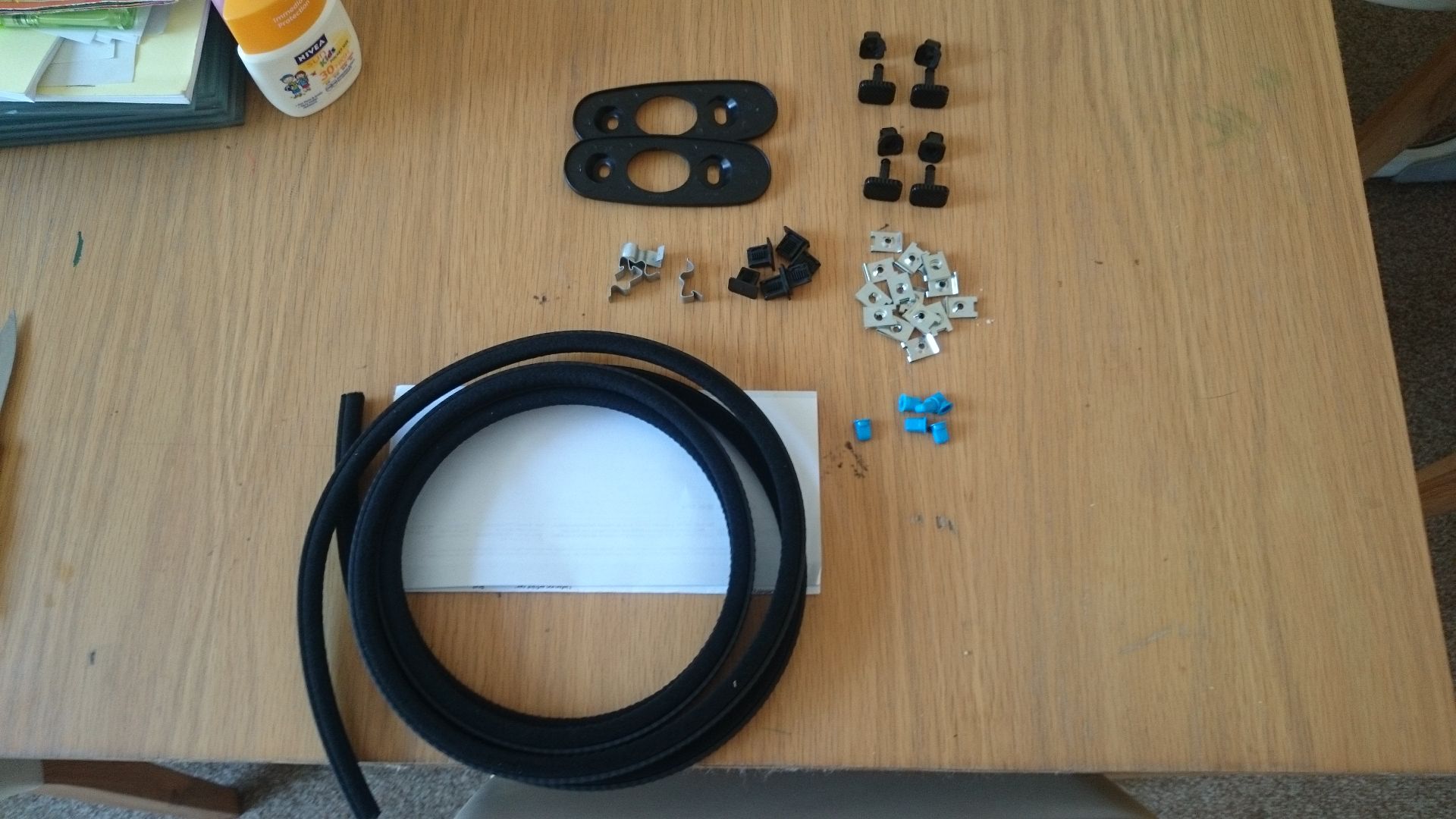

seanl82 23 Posted July 2, 2014 Received my order from ARZ tuning today. Only ordered it Sunday night so very impressed with the service!. Did cost a fair old whack postage though, and I know what I ordered, I just suppose you expect a bit more when it cost so much! :( In other news, wheels are now in with the refurbishers. Another shock at how much it cost me! :crazyeyes: Its the only place I could find in the county with a good reputation though, even if it is a major franchise. Quote Share this post Link to post Share on other sites
