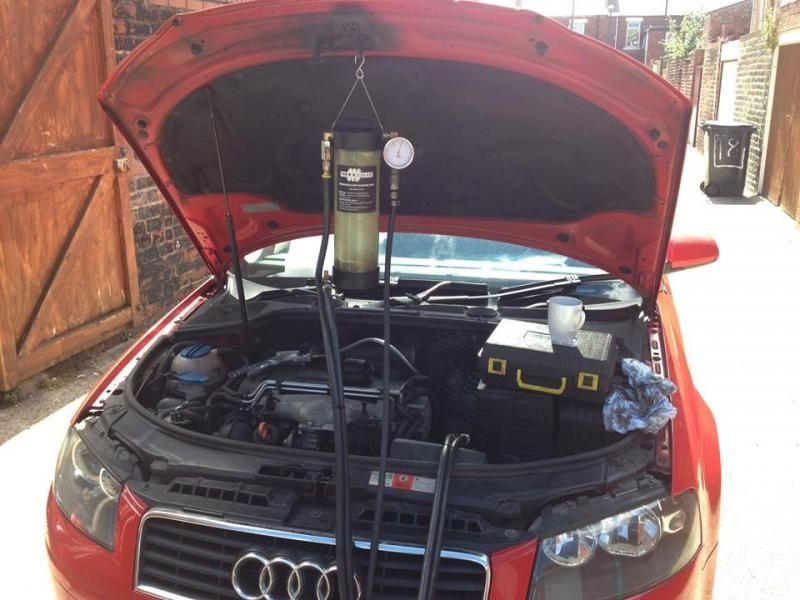

Banana Man 0 Posted August 12, 2013 (edited) How about pictures before and after of egr and cooler of a A3 tdi would that help (probably not) If anyone wants to do an independent test they are more than welcome to, if they want to go to the expense of stripping 2 engines down before and then replacing gaskets and running one engine through terraclean and the other same process without terraclean and then stripping both engines down and replacing gaskets again, it is an expensive route just to prove a point, but there is no one stopping them. Go speak to people that have actually had the service done and see what the response is!!! Anyway heres a few pics before and after terraclean of the EGR and Cooler from an A3 tdi Terraclean egr tool Before EGR After Before after Quote and I've yet to see an engine with soot build up on the intake side, has it been running in reverse??? Dave I don't know whether you have heard of it but EGR stands for exhaust gas recirculation, it is a method of further reducing NOx gases by re introducing them to the inlet manfold, that is how inlet valves also get introduced with carbon, especially on direct port injection vehicles as the tops of the inlet valves never see any direct fuel contact to wash any soot build up off unlike older conventional port injection systems, a certain amount of oil which seep past stem seals will also build up on the tops of the inlets as they get burnt onto the surface and with no direct contact with fuel this will carry on to build up causing loss of performance over a period of time.. If you don't believe in the process you don't believe it really is as simple as that I really don't care if you don't believe we don't expect to accept the product the response from many thousand of people that have actually tried has been very positive. By the way there are no detergents used in the petrol terraclean system, refined fuels and technology are the only things needed to get results that off the shelf products can't achieve!!! Edited August 12, 2013 by Banana Man Quote Share this post Link to post Share on other sites
