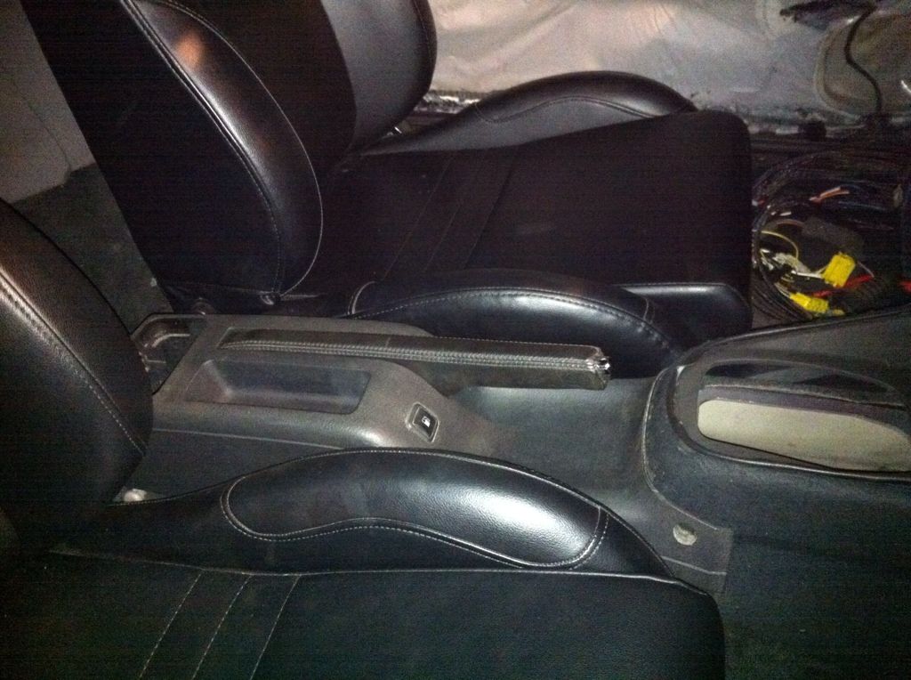

ray_vr6 1 Posted July 30, 2013 OK – fitted the golf 4 handbrake. As in previous post it is not a straight fit but a little “adjustment” to the mounting points has it fit over the original mounts and also straightened out the offset. The inside tunnel cover requires quite a bit of modifying to allow the golf part to fit but I did not have to cut the outer cover. The only other thing you need to do is to wire in the brake light switch – couple of mini female terminals to the new unit and that’s it. Quote Share this post Link to post Share on other sites

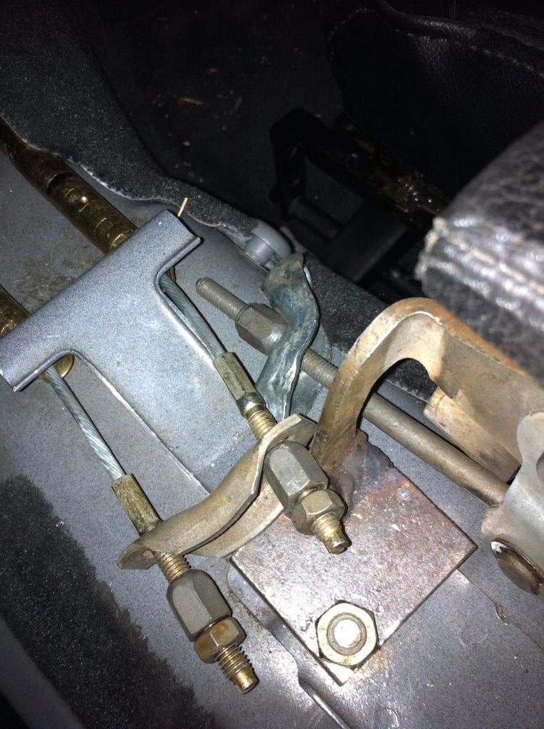

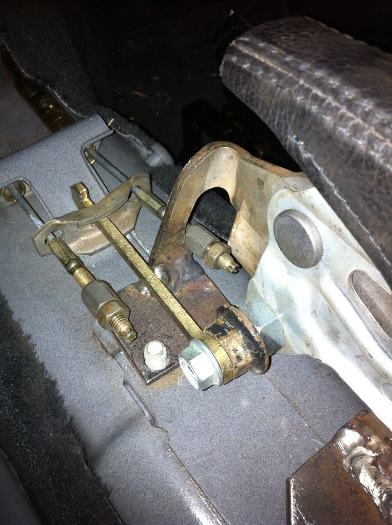

ray_vr6 1 Posted July 31, 2013 Ok here we go with some pics of the installation. There is a third mounting point on the Golf handbrake which you could utilise if you welded a bolt to the floor pan. I may do this later. I cut away most of the two pieces of plastic that will prevent the inside tunnel cover from going over the handbrake. I also cut away some of the top opening to ease the operation of the lever. You may notice two self tapping screws that I had installed before in order to solve the "loose tunnel rattle" that Corrado's are notorious for! This I think aides the installation. Hope this all makes sense! Quote Share this post Link to post Share on other sites

owen g60 10 Posted July 31, 2013 This looks like it could be a good move. With handbrake handles an plastic covers becoming harder to find. The mk4 item doesn't look out of place and are relatively cheap to get hold of. Quote Share this post Link to post Share on other sites
geoffersmaher 10 Posted August 1, 2013 Perfect. Big thanks. Ordered on of these for 10 quid delivered. Bargain mod. And I cant stand that bloody plastic Quote Share this post Link to post Share on other sites

GrahamU 6 Posted August 1, 2013 nice pictures, did you just slot the holes to make it fit? Quote Share this post Link to post Share on other sites
ray_vr6 1 Posted August 2, 2013 rado20vT said: nice pictures, did you just slot the holes to make it fit? No - I was slightly less subtle than that! - Just took a few taps with a hammer to allow the holes to fit to the bolts. I also slightly bent the lower bracket (same method) to allow the lever to sit more centrally Quote Share this post Link to post Share on other sites

fla 9 Posted July 5, 2016 Just finished this but the upper cover drags on the handbrake. How much and where did you remove plastic from there? Quote Share this post Link to post Share on other sites
eugopnosaj 0 Posted July 7, 2016 fla said: Just finished this but the upper cover drags on the handbrake. How much and where did you remove plastic from there? I still have this problem with mine, currently running it without the upper cover...have been for months :lol: Quote Share this post Link to post Share on other sites
fla 9 Posted July 7, 2016 Ok so i'm not the only one! Might make some leather boot to cover the exposed portion and blend it in to the handbrake Quote Share this post Link to post Share on other sites
fla 9 Posted October 25, 2016 Just another thing the rhs brake cable fouls against the mounting bracket. What have you guys done to get around this? I originally put some copper tube over the bolt but this pushes the out cover out too far. It also means that the handbrake doesnt pull evenly on the cables. Quote Share this post Link to post Share on other sites
