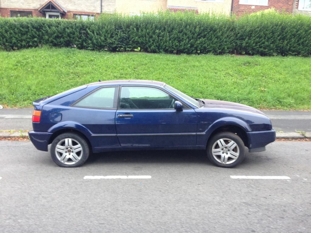

borachris 0 Posted July 25, 2014 Corrado number 3 has arrived.... Quote Share this post Link to post Share on other sites

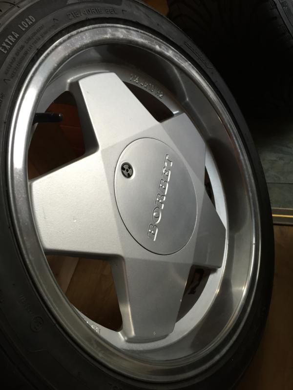

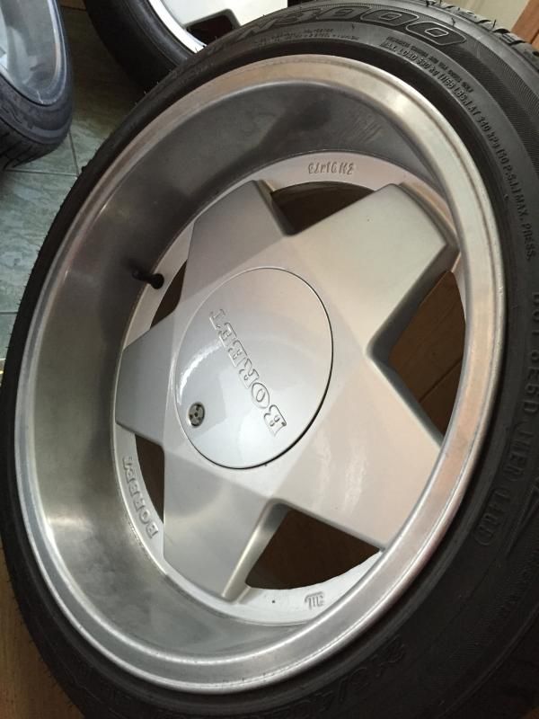

borachris 0 Posted September 22, 2014 Will do mate , no need to post , im under the impression you see fuzz quite often so you could pass them to him and ill be seeing him at some point to get them Theres a small cap and screw on the back of the door to get them off mate thats how i bent mine in the first place Forgot about these mate did you get some sorted? New hoops courtesy of Fuzz:8 More to come.... Quote Share this post Link to post Share on other sites

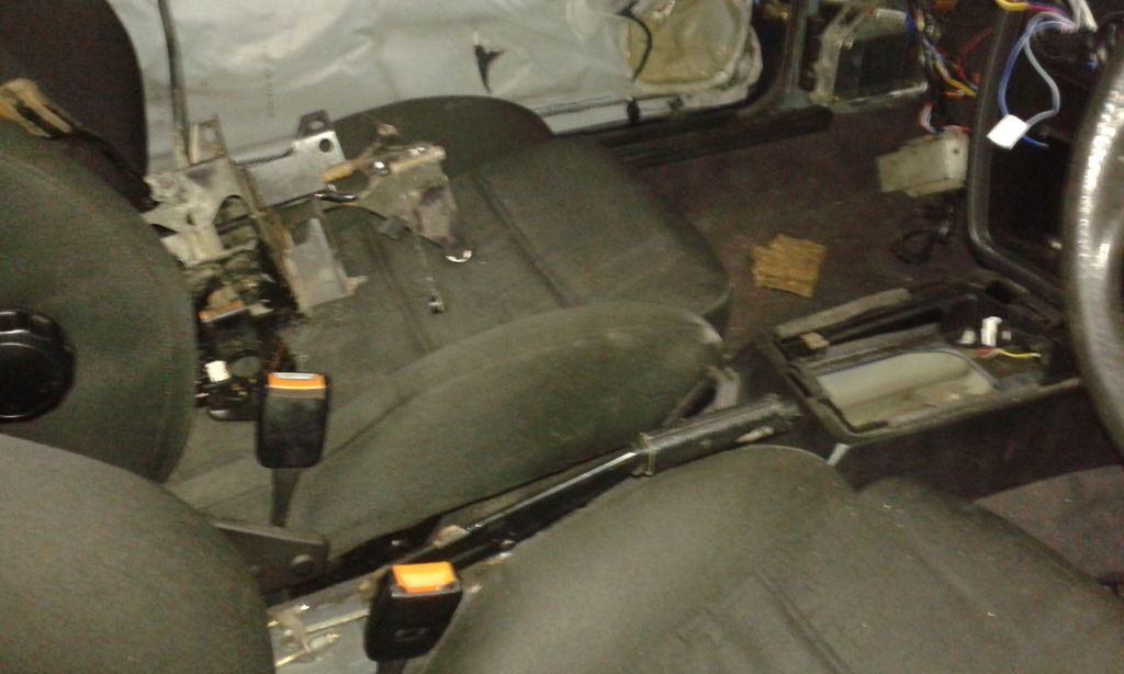

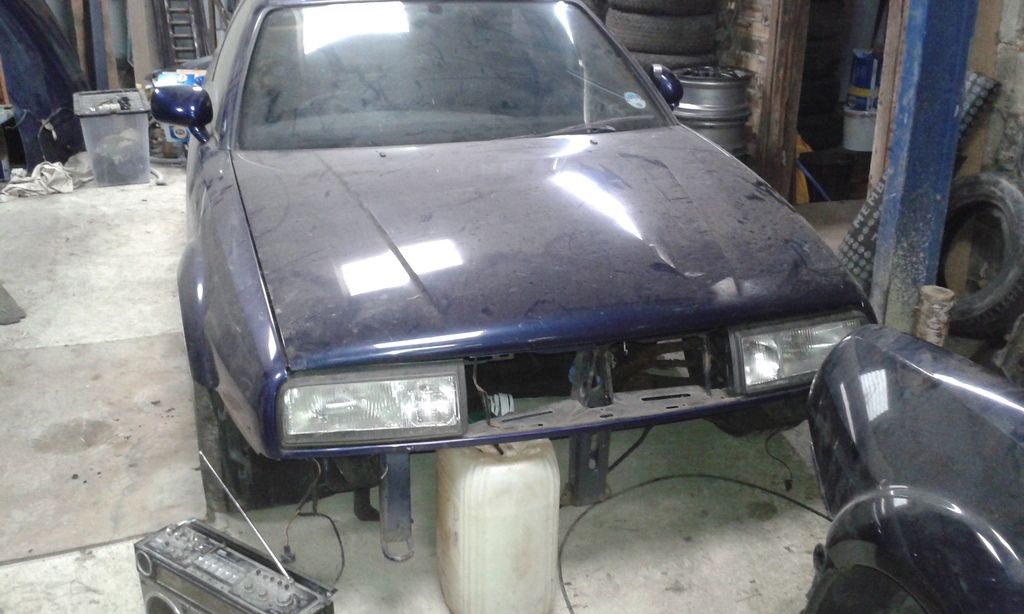

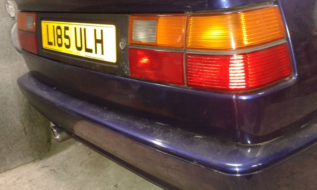

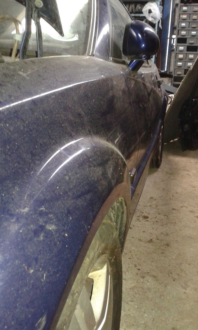

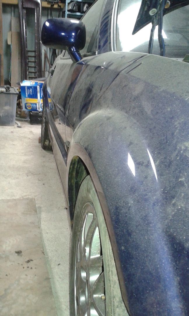

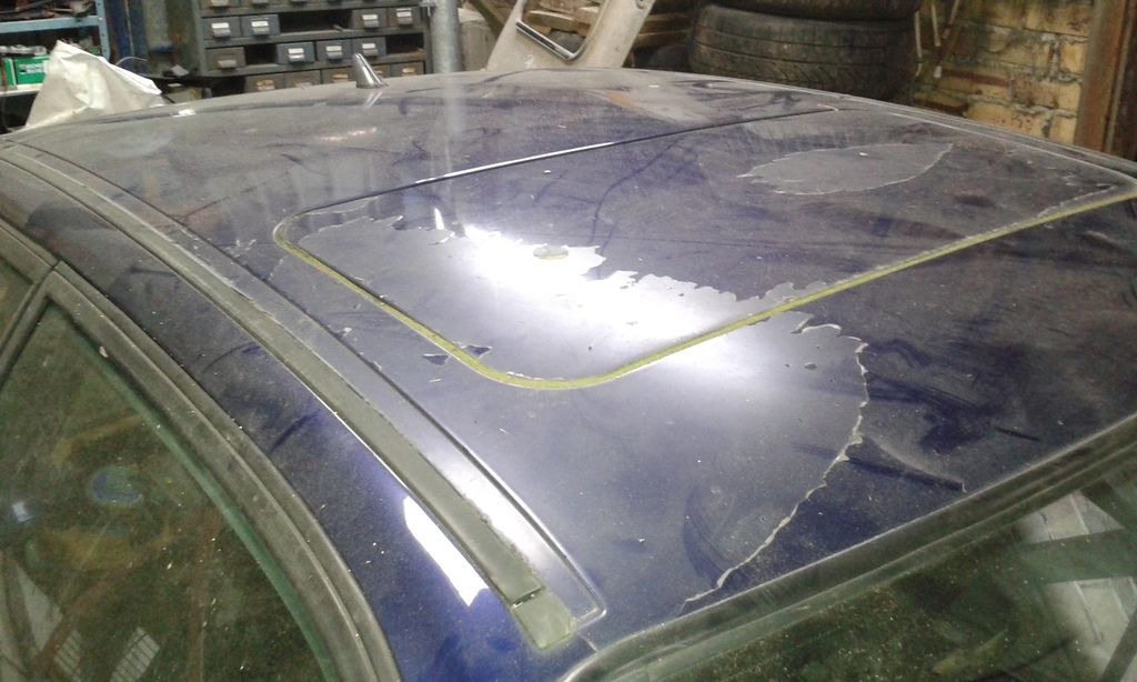

lilfuzzer 1 Posted May 8, 2016 Holy thread resurrection!!!! Hope you dont mind Chris a little update on the car. She is a little dusty at the moment but plans are afoot to bring her back to life pedal bo and fusebox back in the car with a brand new loom. A corrado shifter cables and box been installed. Quote Share this post Link to post Share on other sites
