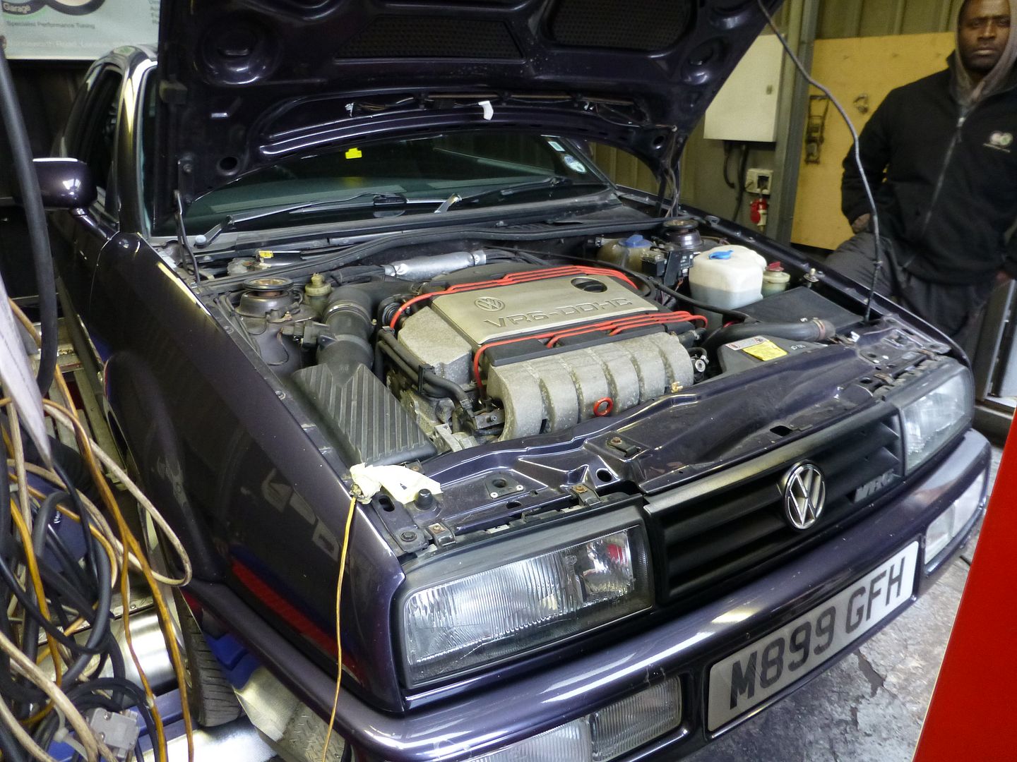

vw_singh 10 Posted November 7, 2013 Hi All, I am a new to Corrado.net but have been reading into topics since buying my 1st Corrado in Feb so though it was only polite to put up some pics of my car. It's a late model VR6 in Twilight Violet. I bought it from a friend as an almost completely standard car. The only addition being some 288mm brakes from a Golf VR6. Being used to driving Golfs etc, the Corrado driving experience was certainly a pleasant one. I like the low down feeling when sitting in it and the poise when changing direction. However, the 4x4 ride height lets it down. Here it is. Took the car into work and had the fuel pump fail on me! This was the 1st day I had started to use it. Oh well, pump replace and has been going well since. There are some other small issues that need rectifying such as the tilt 'n' slide that doesn't work, the one touch windows that can only be used separately and not together and the ABS system that doesn't work (ABS light permanently on). The bonnet had seen better days and was heavily scored so some time spent with the buffer and a little Menzerna soon fixed that. There are still some areas that need addressing but can wait for now. The paint on the car is in very good condition bar the lacquer peel on the front bumper only. Easily sort that in the future. So while trying to find a deal on suspension, I can across someone selling a Bilstein B12 (The later Eibach version) kit for very little money. The set was described as a little rough looking but in perfect health. I took a gamble and went with it. No leaks or damage present so on they went. Already sitting at a much more pleasing height. Good thing is the Wishbone angles and suspension geometry is all still at usable angles and haven't put the roll center through the floor. Should handle nicely. After settling down a bit, the height leveled out nicely. The old shocks were shot to pieces so now the chassis really woke up. The turn in is much better and on/off throttle and high speed corners are much better controlled. It really is true that the harder you drive, the better this suspension performs. Also, the ride isn't at all unconfortable as these kits seems to be described and I drive to work over speed bumps and residential roads. The car also sits level when it has a full tank of fuel but becomes higher at the rear when near empty. Next up, a friend of mine was running a rolling road day so I decided to take the car over for a power check. It was strapped to the Dyno Dynamics rollers know as the heart breaker for it's less than optimistic power readings compared to other places. Not bad results for a car with 125k miles on it. :thumbleft: And yes, it's not a Storm but a typo from the operator. So that's were I stand in almost a year of Corrado ownership. This weekend? Water pump replacement as it seems to have sprung a leak. Gurds Quote Share this post Link to post Share on other sites

axcel01uk 0 Posted November 7, 2013 Looks a really nice example and healthy engine, great to see another twilight violet car as well but then I am biased. Quote Share this post Link to post Share on other sites
