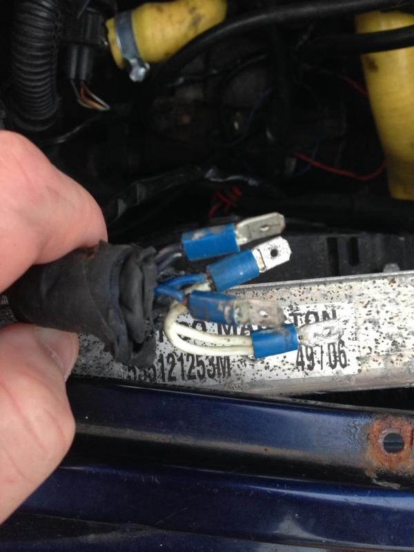

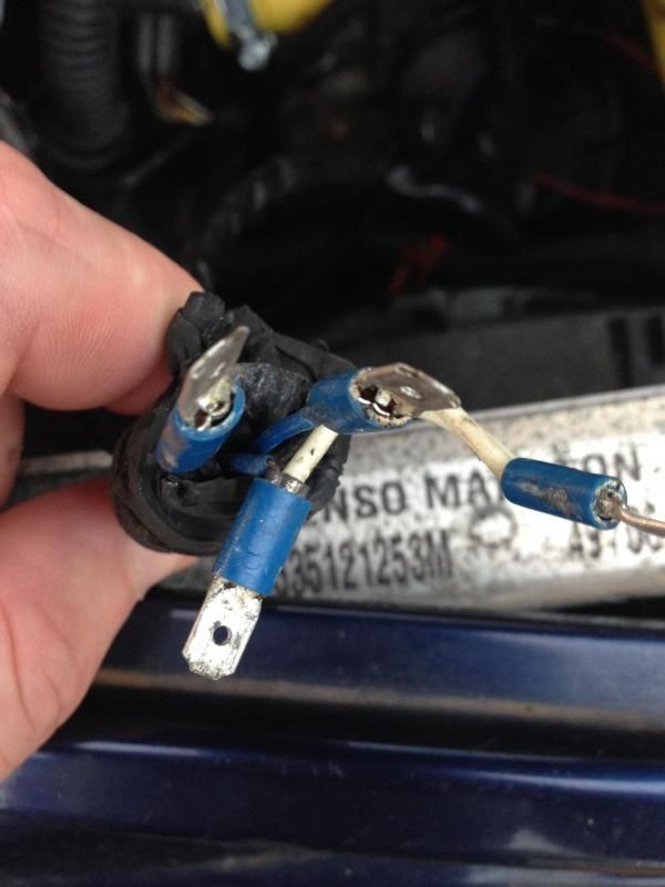

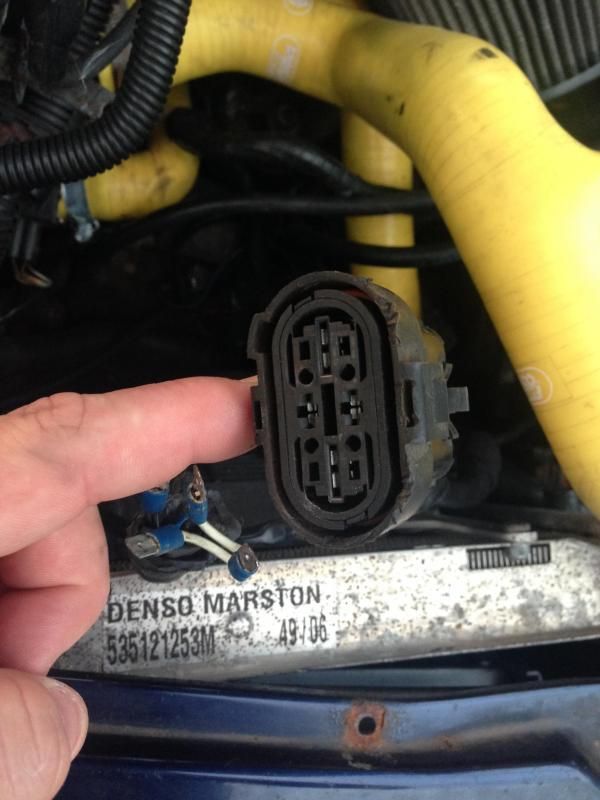

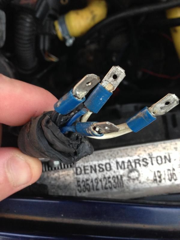

borachris 0 Posted September 10, 2014 As you can see in the pics below, the 2 blacks go into the same spade, the blue go into one each and then are bridged into the 4th spade. I've not looked into which pin each one needs to go into yet but I assumed it was the same as Hasan has explained above. Quote Share this post Link to post Share on other sites
sexybourbon 0 Posted September 10, 2014 I wonder if theree is a way we an order the fan plug and use that instead of the spades to make a standard looking plug that will be sealed from the elements Quote Share this post Link to post Share on other sites
borachris 0 Posted September 10, 2014 Not really, the plug on the fans is moulded into the casing of the motor. I was thinking about buying a conector but it would mean cutting the original off, not that I'm ever likely to want to fit standard fans again I suppose. Quote Share this post Link to post Share on other sites

fla 9 Posted September 10, 2014 i think you can de-pin the spades from the connector. My plan it to remove them and find two housings to use to connect them properly. As a temporary solution, after depinning you could just use some silicon boots on each spade and seal the smaller ends with sealant, or indeed use the rubber grommet on the base of the spade as a seal. Quote Share this post Link to post Share on other sites
VAG-hag 0 Posted September 11, 2014 You can hasan, thats what I did over the weekend. This way I can add spades then covers them in heat shrink. thanks for the pics chris Quote Share this post Link to post Share on other sites
