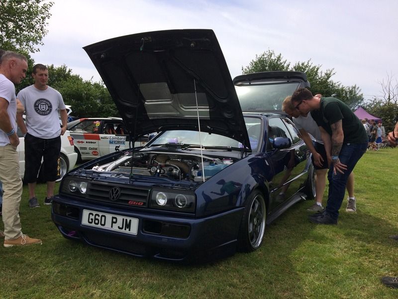

GrahamU 6 Posted May 28, 2017 Had the pleasure of seeing this in the metal today at the dublogic show. Was good to talk to you John, congrats on the prizes, well deserved, your car is inspiring Quote Share this post Link to post Share on other sites
Jim 2 Posted May 29, 2017 Proper weapon isn't it. One of my favourite Corrado's out there right now. The sheer amount of work that's gone into it is mind blowing. Quote Share this post Link to post Share on other sites
Jamie 1 Posted May 30, 2017 What. A. Car!! Stunning. Makes me think I should really do something with mine.... Quote Share this post Link to post Share on other sites

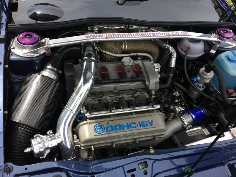

Goldie 2 Posted May 30, 2017 That engine bay is incredible... Brilliant... Quote Share this post Link to post Share on other sites
