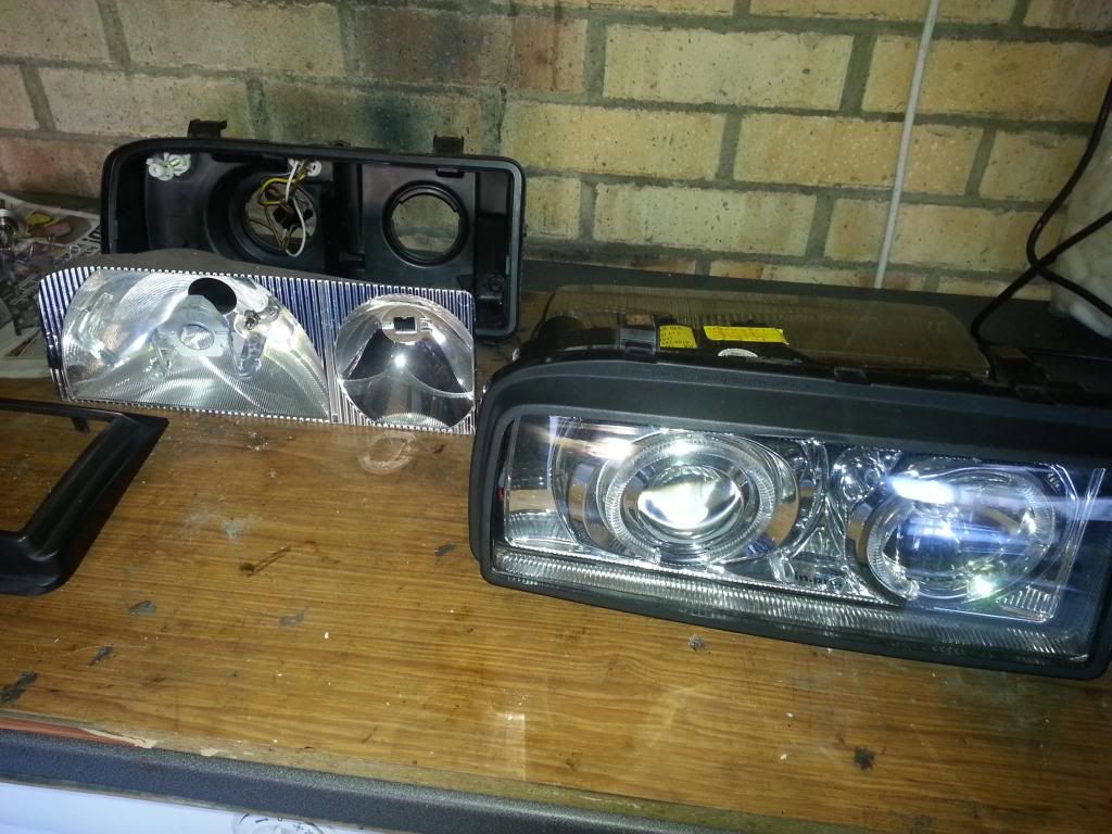

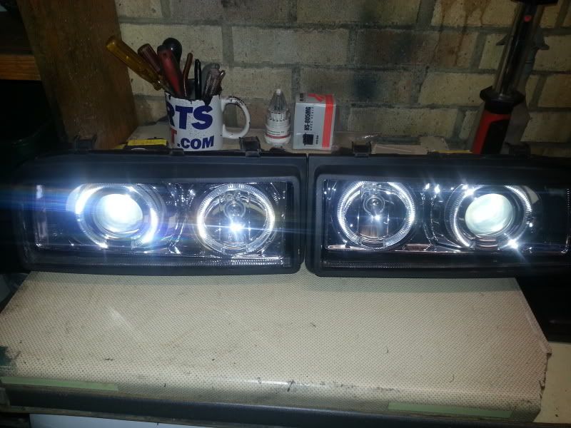

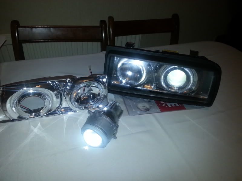

Jim Bowen 1 Posted October 22, 2014 I started to try and make a set from some standard lights and some of those angel eye halo type, but i didn't get very far. Just have a pile of lights i took apart :lol: The trouble is you need a clear lense on the headlight, which the angel eyes have, i planned to use a normal corrado light, mount an HID unit in it, and then fit the clear lense, i also thought i could maybe mark out a circle on the lense and then blast or etch the rest of it so it looked bit more standard. Quote Share this post Link to post Share on other sites
Jim Bowen 1 Posted October 22, 2014 Some pics i took, not much help really :lol: Quote Share this post Link to post Share on other sites

Jim Bowen 1 Posted October 22, 2014 Its the glass that cocks up HIDs, if you have all the reflector lines like the standard corrado lamps it mucks up the beam pattern of the HIDs, you need clear glass. Would like to see what Wendy has. Quote Share this post Link to post Share on other sites

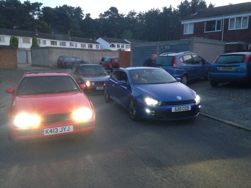

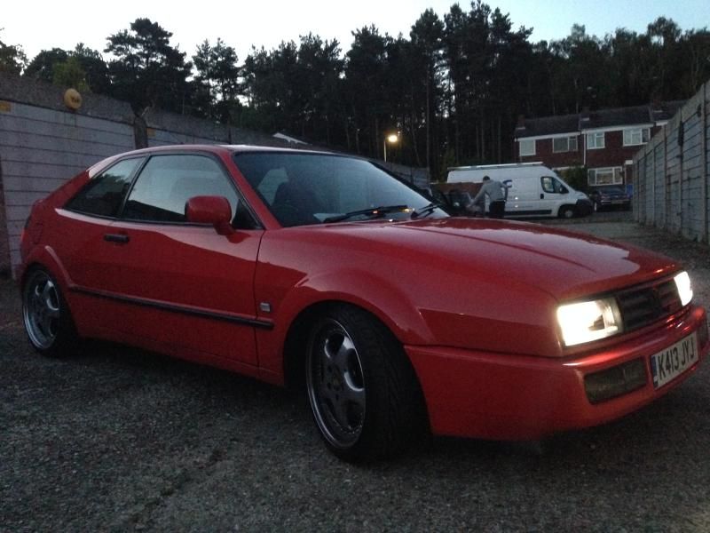

Jamie 1 Posted October 22, 2014 I'm not normally a fan of pikey aftermarket HIDs but the ones in my C are awesome. Look great, light up the road great and from what I've been told they look factory to the car in front. Not great pics but kind of gives you the idea... (this bottom pic was around 5:00am when we were setting off to Worthersee so not pitch dark but not as bright as it looks in the picture) Quote Share this post Link to post Share on other sites

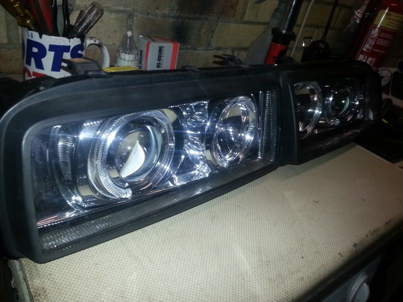

KipVR 1 Posted October 24, 2014 The fluting on the glass is vertical so it doesn't mess things up that much, and it's still a much better cut off than a reflector housing can offer. I've been experimenting on an old set of headlights, I'm trying to make an oem looking pair of projector headlights like the Rallye had. I'm amazed at the quality of the Projectors for the amount of money they cost, you can get them for £28 on eBay now! Chinese hid projector in Corrado housing Projector pattern on wall in messy garage With fluted glass in front Quote Share this post Link to post Share on other sites
science 0 Posted October 24, 2014 KipVR said: The fluting on the glass is vertical so it doesn't mess things up that much, and it's still a much better cut off than a reflector housing can offer. I've been experimenting on an old set of headlights, I'm trying to make an oem looking pair of projector headlights like the Rallye had. I'm amazed at the quality of the Projectors for the amount of money they cost, you can get them for £28 on eBay now! Chinese hid projector in Corrado housing Projector pattern on wall in messy garage With fluted glass in front Looks great! Do you have any details of how you did this? Quote Share this post Link to post Share on other sites

KipVR 1 Posted October 24, 2014 (edited) Well I'm still getting there, I'll do a write up if the results are good enough, the initial tests seem promising, and the projectors are not that noticeable in the headlight. Shown below is the beam pattern hid on the right and the halogen on the left. The projected HID light is still way better (for cut off and spread) than the reflected halogen, even through the flutes. Need to get 4300 bulbs instead of the 5k in there! Edited October 24, 2014 by KipVR Quote Share this post Link to post Share on other sites
Jim Bowen 1 Posted October 24, 2014 impressive results, might start tinkering with mine again. Quote Share this post Link to post Share on other sites
Roger Chatfield 0 Posted October 24, 2014 Kip, what do you mean by 'beam pattern hid'. That looks very good, I'd be happy with that. Rog. Quote Share this post Link to post Share on other sites
