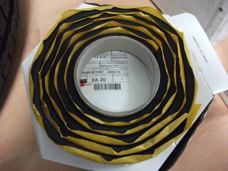

GrahamU 6 Posted November 23, 2014 Ray1965 said: Rob what seal did you use . i did mine and used silicon first and it was a big fail. I got some of this and has done the job spot on, the flexi stuff and can be pulled off and re-stuck its what the manufacture uses when new i believe. http://www.ebay.co.uk/itm/221224948406?_trksid=p2060778.m1438.l2649&ssPageName=STRK%3AMEBIDX%3AIT That looks quite close to the proper VW stuff This is what I'll be using for alot of the sealing on mine, its amazing stuff for sealing and for holding bits in place and stopping squeaks and rattles VW part number is AKD-497-010-04-R10 Quote Share this post Link to post Share on other sites
robrado974 1 Posted December 21, 2014 Yep thats virtualy the same stuff i use at work and what i used to do mine . I returned to the car on saterday to find a round shaped mist on the passenger side of the windscreen . Sure enough its leaking again !! . I will have a look over the xmas period . I sealed this nice n tight , i cant understand why ive got water coming in again . Quote Share this post Link to post Share on other sites
