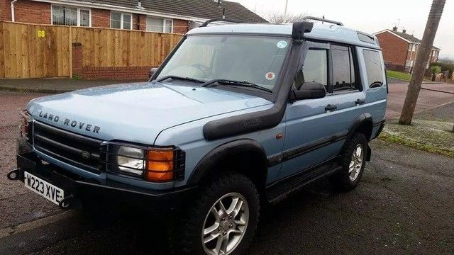

I had been after a BB VR for sometime and when I seen a member on here advertising that he wanted to swap one for a 4x4 via facebook, I offered him my Discovery in a deal, no doubt I could have sold the TD5 and bought a VR but this took all the hassle of timewasters out the frame:

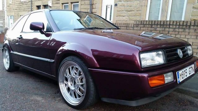

So my current crop as it stands:

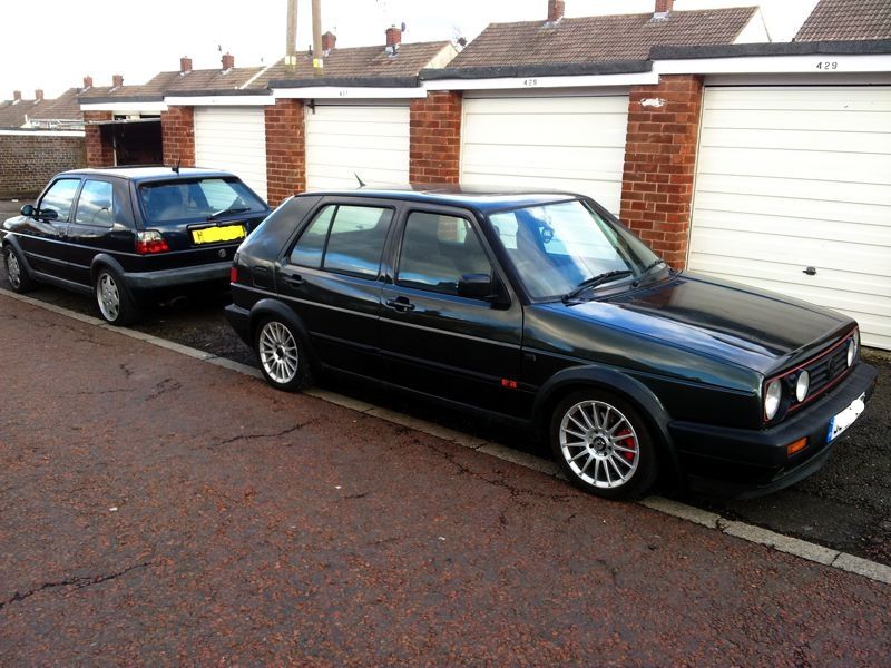

The daily

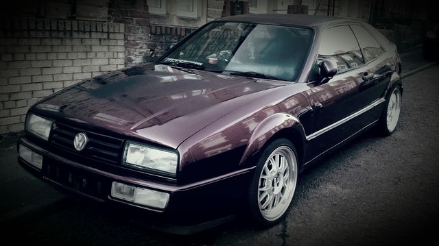

VR

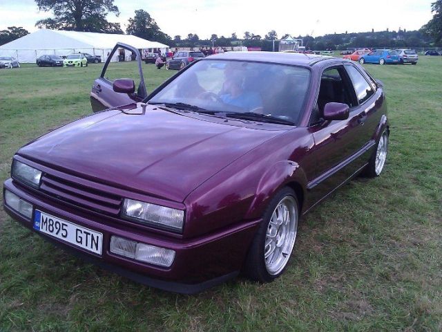

The C I ended up with had very little in the way of documented history (in fact it had none) the car was a raffle prize at Ed38:
On Display at Ed38:
SamC the lucky winner pictured with the car:

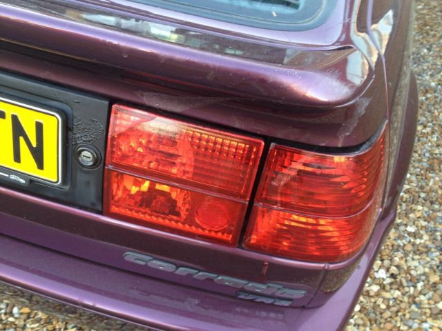

He didn't have it long before someone decided to nock the shine off his new car (literally):

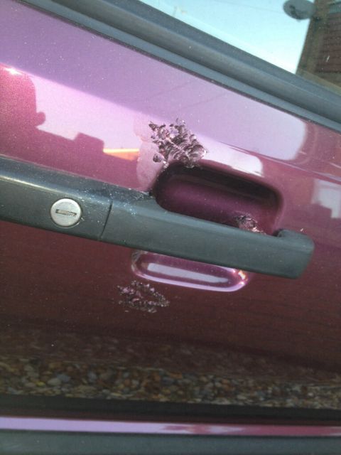

I don't know if it was jealousy or if it was personal but someone seen fit to drown the car in Nitromours, all I can assume is that Sam sold it not long after.
The VR was purchased by a member on here though he never really progressed to fixing the issues it had and basically I acquired it in much the same state as Sam sold it albeit a few more miles.

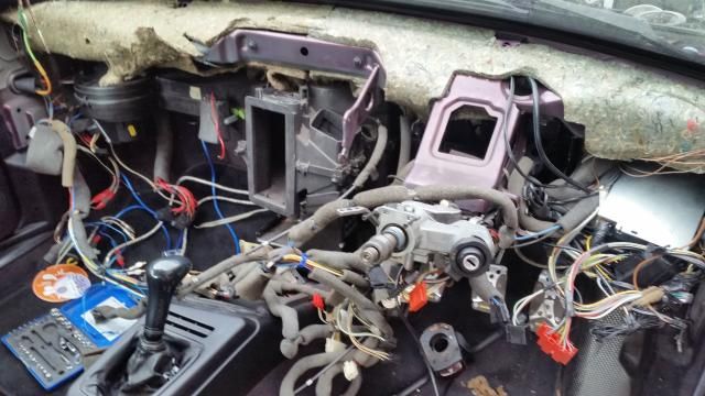

So after taking ownership of the car it was pretty apparent that it had been driven and pretty much un cherished, the heater didn't function due to a trapped cable resulting in a damaged control panel, the paint is in a bad way which is a real shame as it was painted by Stylehause for ed38 and he done a fantastic job.
The Recaro trim was minging at best, headlight surrounds damaged by an eye brow spoiler being glued to them, grill badly painted gloss black, wing mirrors not working, old ICE inop, same for the bonnet release, various trim bits broken or missing and engine bay in dire need of renovation, basically just unloved.

Credit to Chris on here for hooking me up with a heater box...
I managed to strip two control panels and make 1 good one... Happy days.

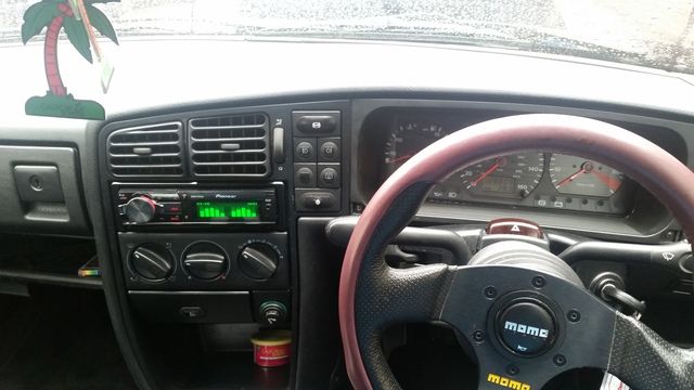

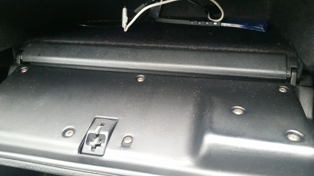

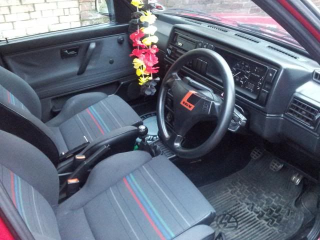

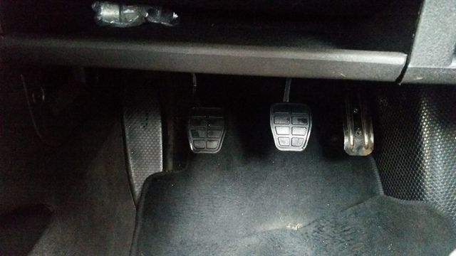

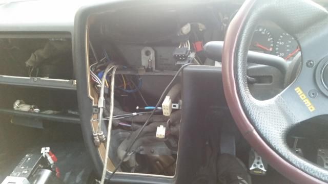

Dash back in, new instrument surround, centre dash surround, heater control panel, New stereo, Glovebox hinge cover, drivers kick plate panel and pedal rubbers, Momo ones binned (need accelerator rubber),

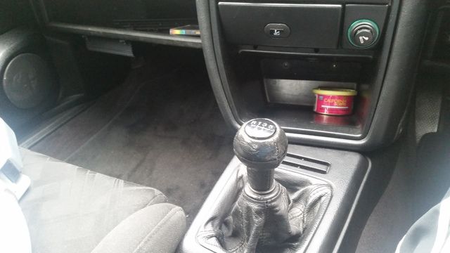

Carbon Italvolanti gear knob binned in favour of a standard one.
280mm Momo to go once I decide what will replace it.

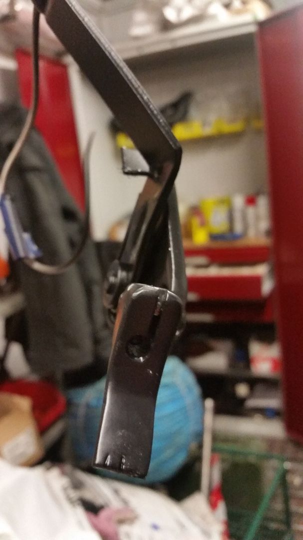

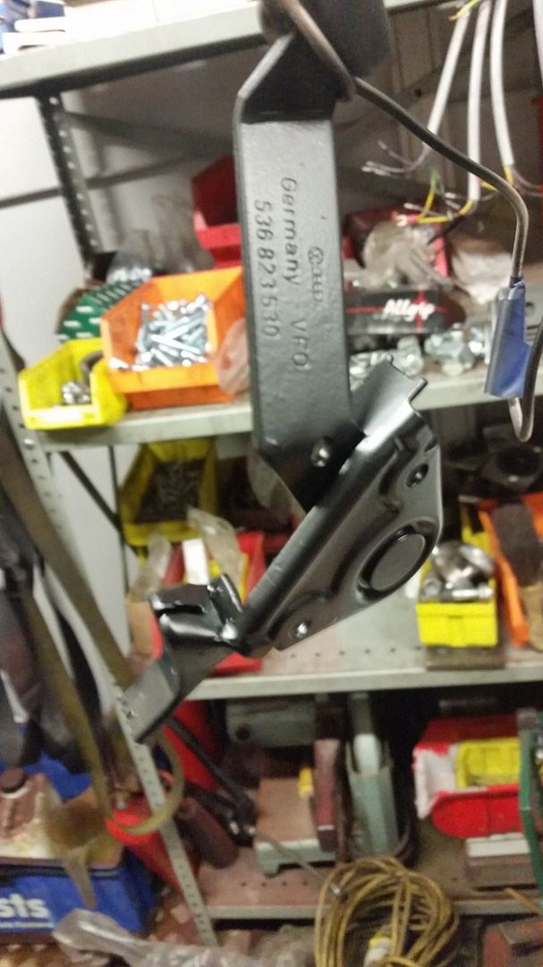

Bonnet release modified so I'm no longer worrying about a broken clip:

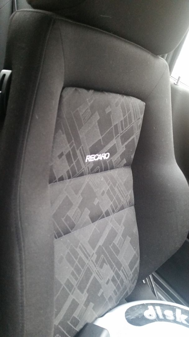

Recaros Steam cleaned to remove Stains and white mould residue.

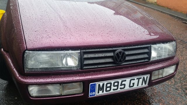

New number plate plinth as original was damaged by nitromours, new wiper motor cover, headlight covers, nos grille with black badge, and de tangoed indicators:
Don't think I'm keen on the covers but we'll see although the front end looks better than it did:

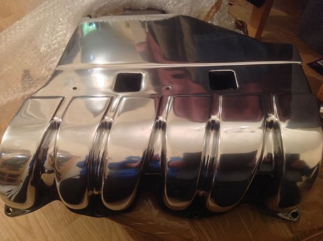

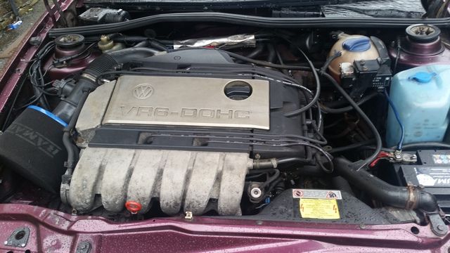

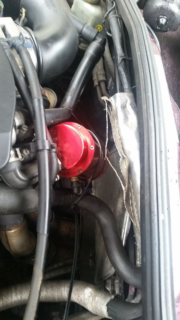

I've got the bits to replace this unsightly catch can, don't understand the benefit of it being there:

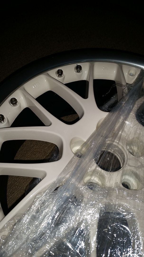

17" BBS RX-504 Splits just had them refurbed in ivory ready to polish the lips.
The accelerator pedal never had a rubber as standard, however a MK1 Golf one will fit. If you do end up replacing the Starter Motor, a V5 MK4 Golf one is worth fitting instead.
Ian.
  seanl82 said:
The gear knob doesn't look correct, should be leather......
Just the camera, it is leather. I think the the VR one should have had silver gear decal though, this one is off my old sportline cabby.

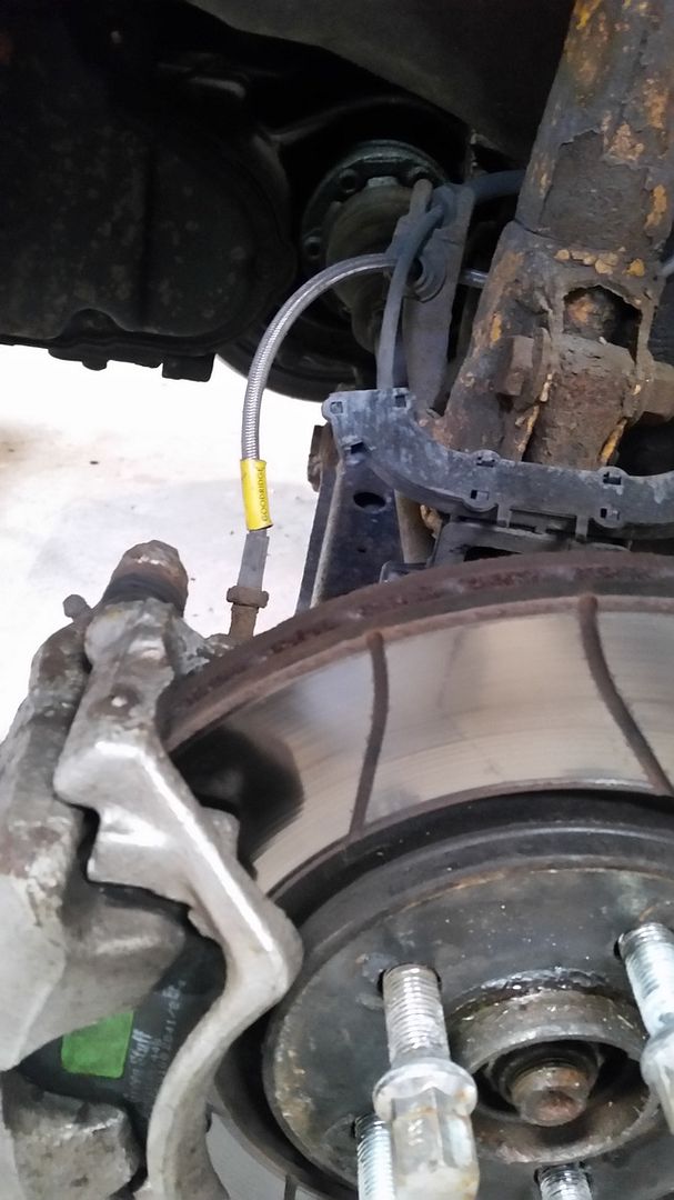

Bonus.... Goodridge braided hoses all round, EBC green stuff pads and grooved discs:

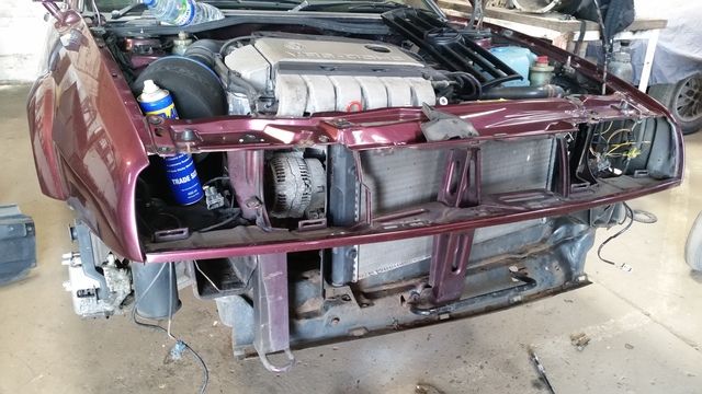

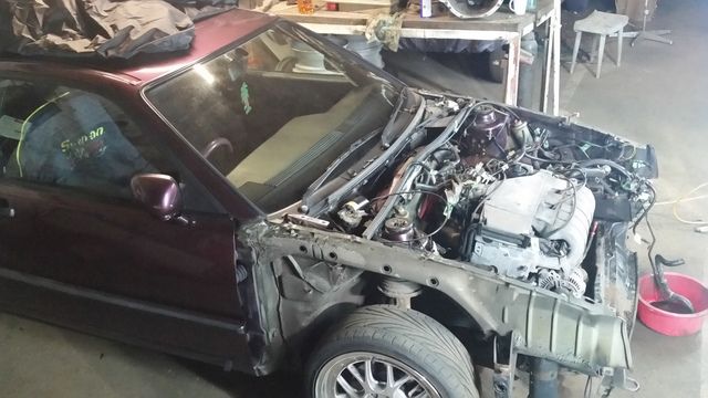

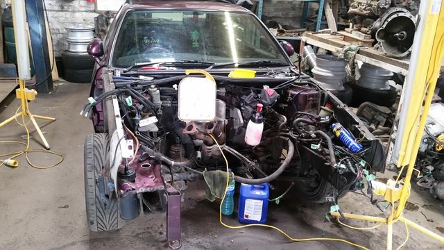

Stripped front end off today in preparation for engine removal and engine bay paint, bit the bullet and sorned it today for the next 16 weeks or so... Gonna replace all brake lines, get some stuff powder coated whilst it's solid, cut out any corrosion (though it seems there is very little) and finally paint it for summer..
Enjoying getting my hands dirty on this little beaut.
Back down tomorrow to get the engine out, all going well.
Sorry about the constant update but kinda keeps me motivated if that makes sense..
Few more hours put in today, drive shafts to loosen tomorrow then out it comes...

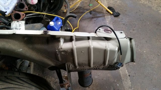

Inner wings look fantastic though the N/S does need a little fettling under the seam sealer (was well hidden but I really don't want to miss any.
Looks like a solid car mate. Will be watching this thread as it looks like you are going for it :)

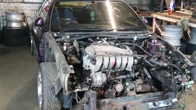

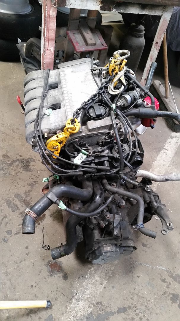

It's out, now to start moving the wiring out the way, brake lines to replace, all the running gear (subframe etc.) to go and get blasted and powder coated.
How much old Waxoyl.... Heat gun, solvent cleaner and a cloth is making light work of it:
Looking very sorry for itself:

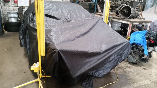

Wrapped up for tonight:

Battery tray requires work
Small hole in inner wing behind washer bottle.
