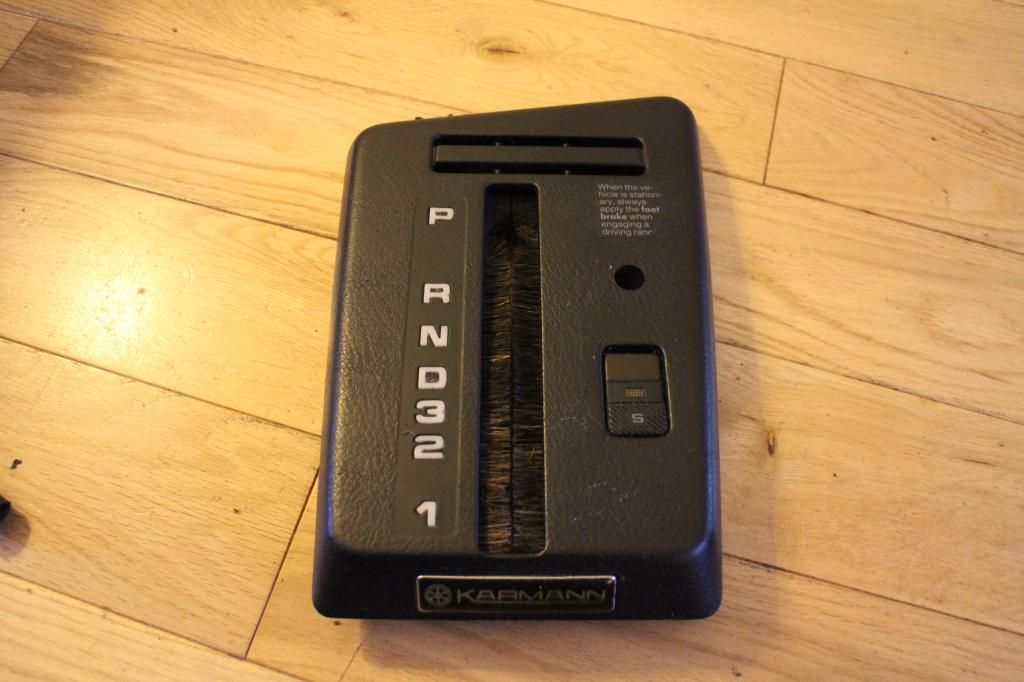

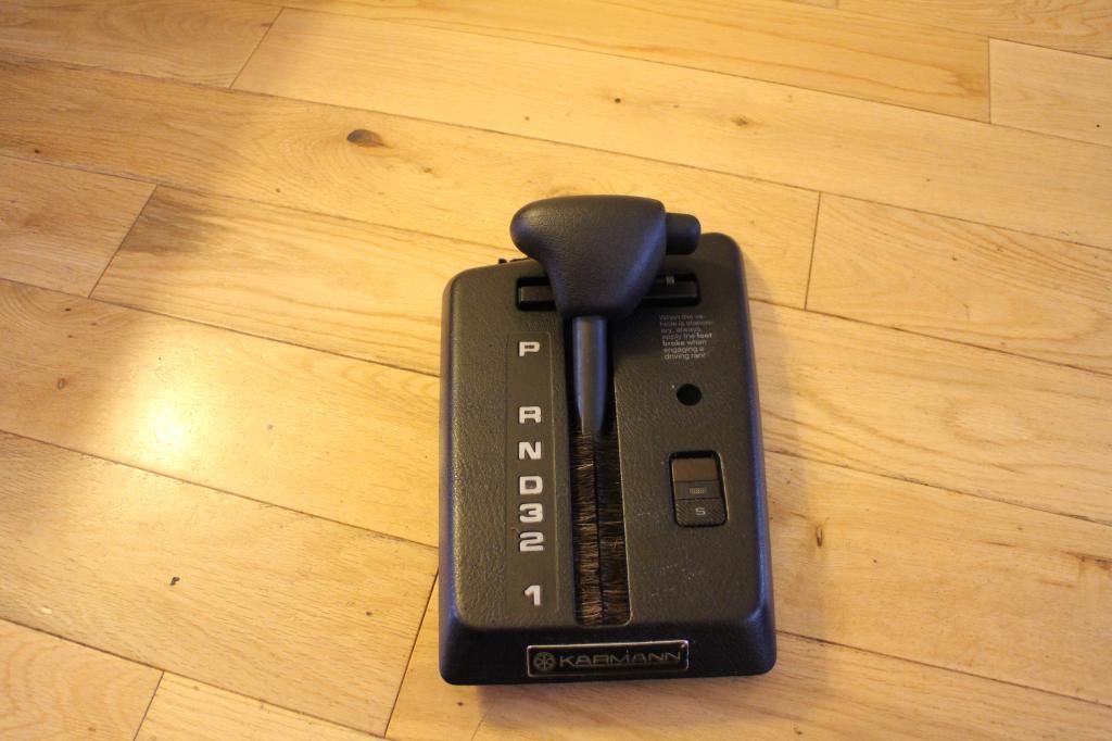

graham1971 10 Posted May 11, 2016 Been trying for nearly 2 years to find a tidy gear shift surround trim panel for a '93 VR6 auto. Any ideas? Quote Share this post Link to post Share on other sites
easypops 6 Posted May 11, 2016 I have one here , it's in good condition but it has a hole where an alarm led was fitted Quote Share this post Link to post Share on other sites
graham1971 10 Posted May 12, 2016 Thanks for that but it's a late model VR6 Auto, its a different shape to that one and has no sport/eco switch. Looks like the one in a MK3 Golf but it's a slightly different size. Quote Share this post Link to post Share on other sites

Jim 1 Posted May 12, 2016 Annoyingly VW Classic Parts list these, but seemingly only for the style with the switch as well - the same as what easypops has. Quote Share this post Link to post Share on other sites
