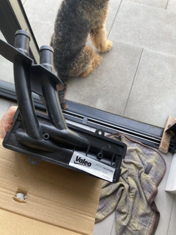

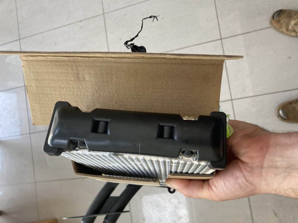

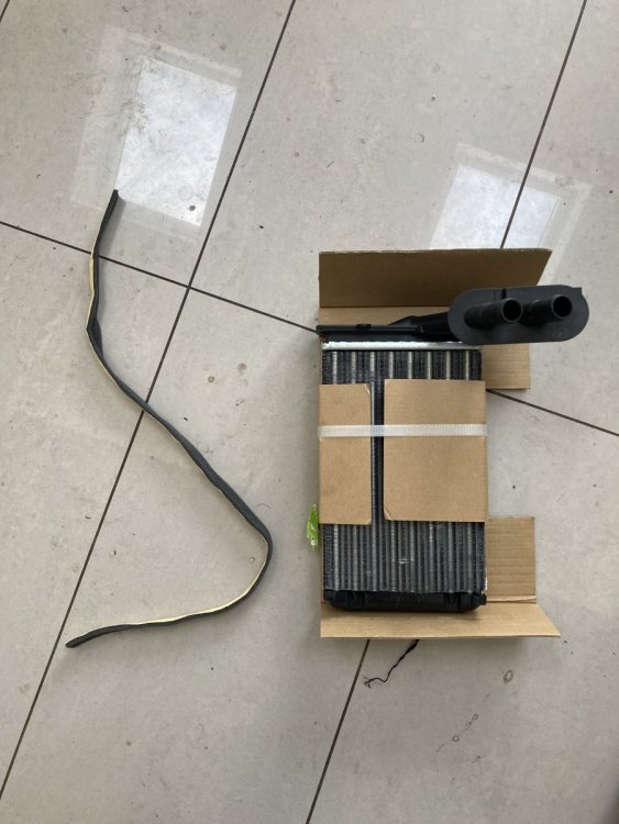

Keyo 47 Posted September 8, 2021 (edited) These are obsolete now or there is none in stock anywhere. I think NRF would be my next choice over Hella (now Mahle) . I got a Valeo one delivered today off an ebay seller but I believe it be fake so sent it back as had no stamps on the casings .and looked nothing like the pictures above. The box had been opened up before as well . In picture just one seal . Edited September 8, 2021 by Keyo Quote Share this post Link to post Share on other sites
