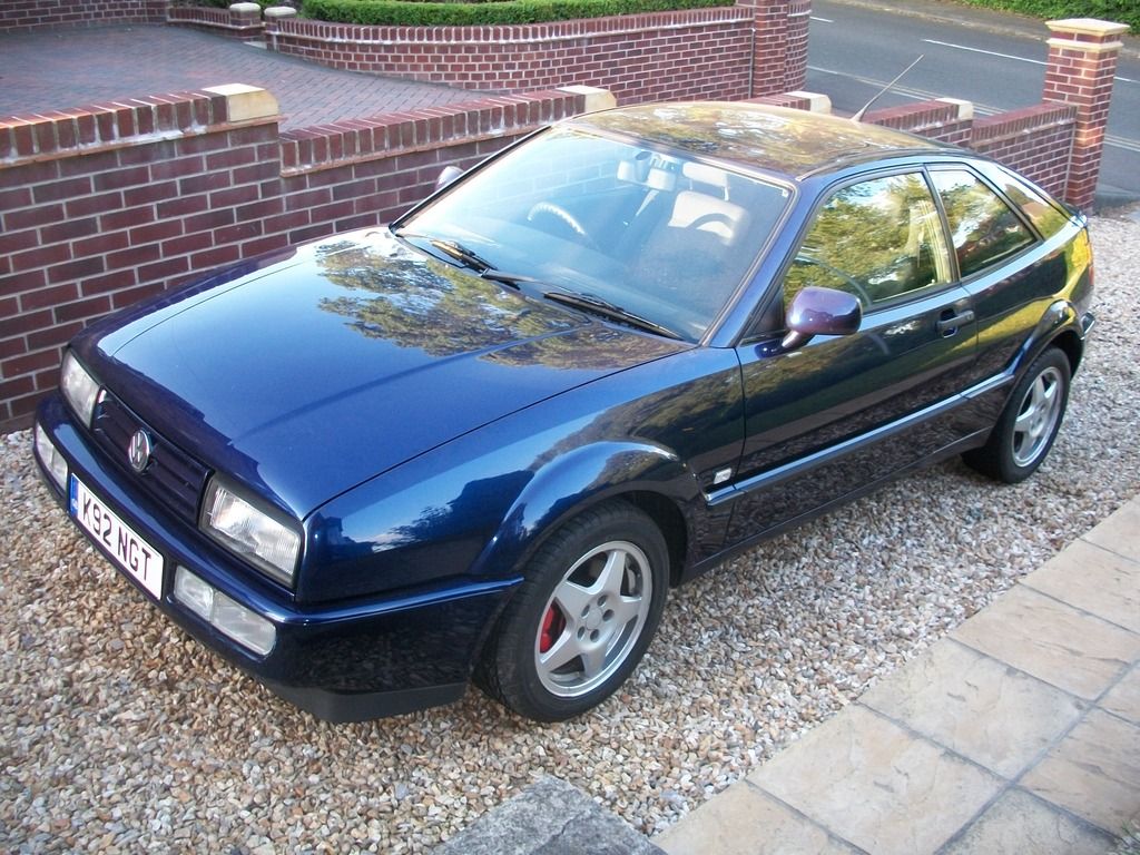

Cluffstarr 0 Posted June 13, 2017 Evening All, So, I've sold two cars in the last month so now feel I can splash a bit of cash on the Corrado over the coming couple of months as well as getting out and enjoying the car. First stop - MOT booked for tomorrow! FIngers crossed and then the decisions about what to spend on first (assuming I don't get a huge bill - think it will need some work to the exhaust..!) Waiting to be driven down tomorrow am: All the best to all - wish me luck ! Cluffy Quote Share this post Link to post Share on other sites
VR-Sixy 0 Posted June 14, 2017 Evening All, So, I've sold two cars in the last month so now feel I can splash a bit of cash on the Corrado over the coming couple of months as well as getting out and enjoying the car. First stop - MOT booked for tomorrow! FIngers crossed and then the decisions about what to spend on first (assuming I don't get a huge bill - think it will need some work to the exhaust..!) Waiting to be driven down tomorrow am: All the best to all - wish me luck ! Cluffy Looks lovely. You must be very pleased with it. Quote Share this post Link to post Share on other sites
Billzeebub 1 Posted June 14, 2017 Car looks really nice. Good luck for the MOT Quote Share this post Link to post Share on other sites
Cluffstarr 0 Posted June 14, 2017 Thanks guys. The Car's not without its faults and the paint isn't great close up but having a good hunt around there's very little rust I can see. I'm hoping that I have no issue bar a leaky exhaust that they may weld up. Should know in the next couple of hours... Quote Share this post Link to post Share on other sites
VR-Sixy 0 Posted June 14, 2017 Thanks guys. The Car's not without its faults and the paint isn't great close up but having a good hunt around there's very little rust I can see. I'm hoping that I have no issue bar a leaky exhaust that they may weld up. Should know in the next couple of hours... Mine doesn't stand up to really close scrutiny...... but i'd wager that's probably the case with most Corrado's that's left. Hope to MOT goes OK. Quote Share this post Link to post Share on other sites
