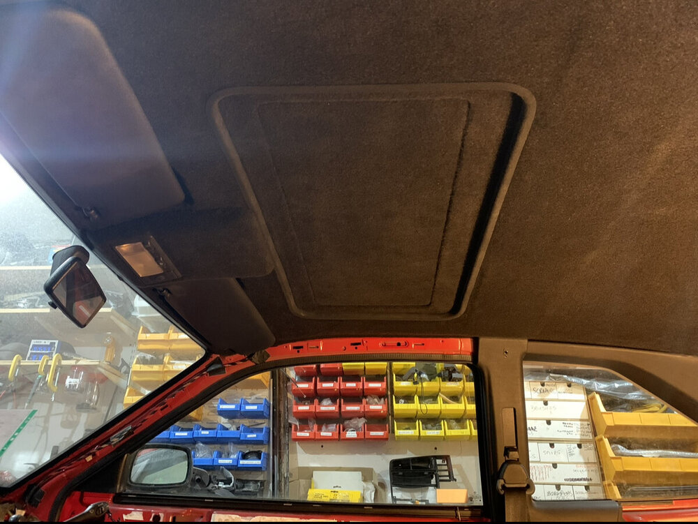

dragon green 6 Posted July 27, 2017 No C's came with black visors,mine have been dyed,and have lasted well. There was a thread on VWvortex years ago,which told you what vw's came with black visors,and how to fit them(not a straight swap) IIRC it was a few cabriolet's Pic of mine sent to show how good they look with black headliner Quote Share this post Link to post Share on other sites
GrahamU 6 Posted July 27, 2017 Nice I wasn't sure they would take dye but they look good I have seen some mk3's have them but they are a different fit and not cheap with the illuminating mirror Like the center visor aswell, I have one of those aswell but also in grey Quote Share this post Link to post Share on other sites

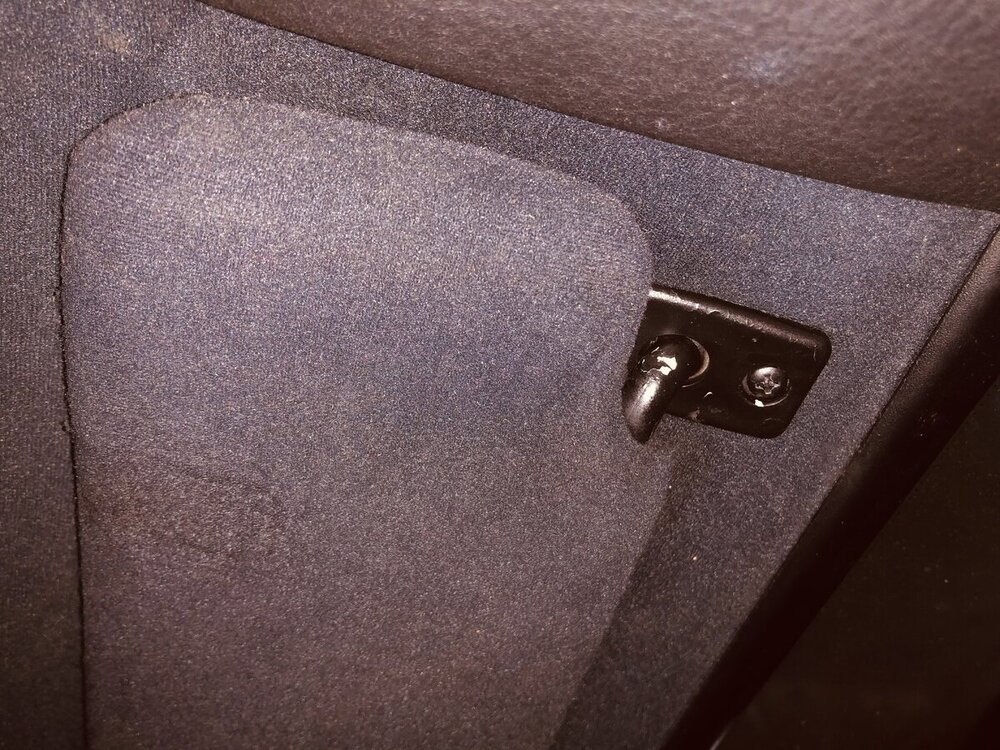

James. 9 Posted December 6, 2022 Here’s the visors on mine. Looks like they’ve been sewn as a pocket and slip stitched along the upper edge. One of the hinges is a bit stiff and holds itself off the roof liner, which is frustrating. It’ll have to stay that way though, as I’m not likely to find one in a breakers yard 🙂. Quote Share this post Link to post Share on other sites

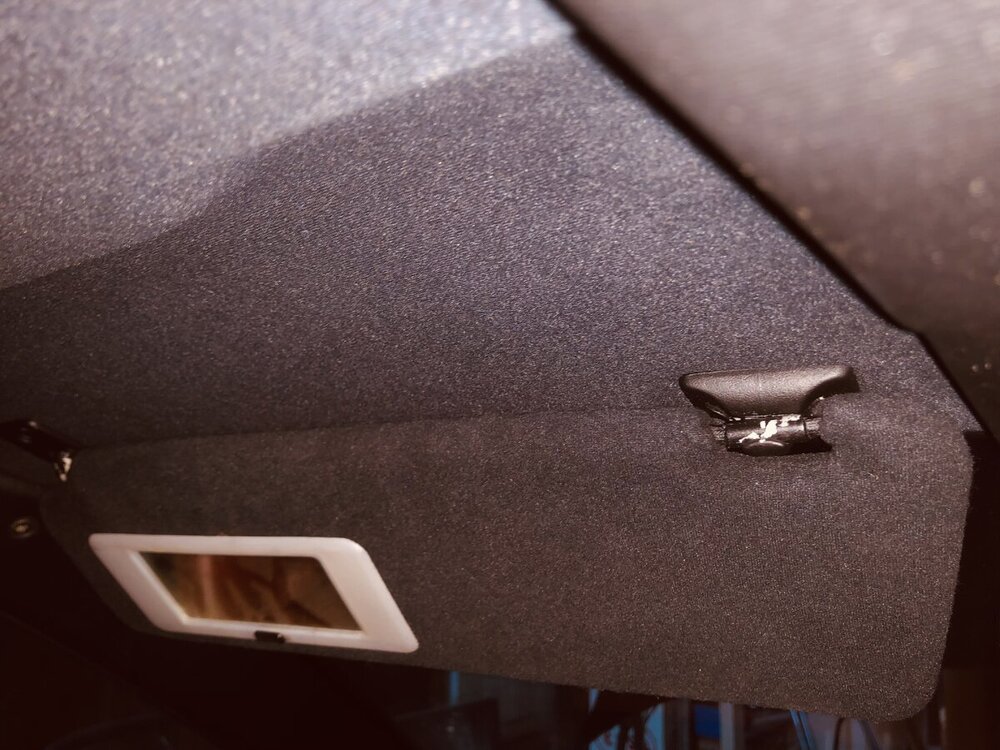

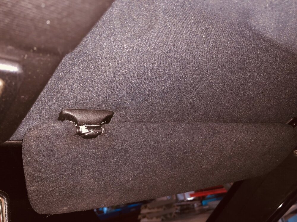

GrahamU 6 Posted December 10, 2022 (edited) Just for info, TT visors are bigger so the hole positions need to be moved but I did fit them Even the light works when the visor is down 🙂 Edited December 10, 2022 by GrahamU Quote Share this post Link to post Share on other sites
ABV-VR6 12 Posted December 10, 2022 On 12/6/2022 at 3:21 PM, James. said: Here’s the visors on mine. Looks like they’ve been sewn as a pocket and slip stitched along the upper edge. One of the hinges is a bit stiff and holds itself off the roof liner, which is frustrating. It’ll have to stay that way though, as I’m not likely to find one in a breakers yard 🙂. Thank you, they look great and that means it is possible to make a "pocket" and make it happen. I'm thinking of maybe doing them in leather to match the shift & e-brake boots if I end up going this way. Quote Share this post Link to post Share on other sites
ABV-VR6 12 Posted December 10, 2022 17 minutes ago, GrahamU said: Just for info, TT visors are bigger so the hole positions need to be moved but I did fit them Even the light works when the visor is down 🙂 Thank you, that clears things up for the TT ones and I appreciate you taking the time to show. It's not that hard to drill & tap holes; the only "downside" I see is the headliner needs to be redone which is probably in the plans anyway! Quote Share this post Link to post Share on other sites
