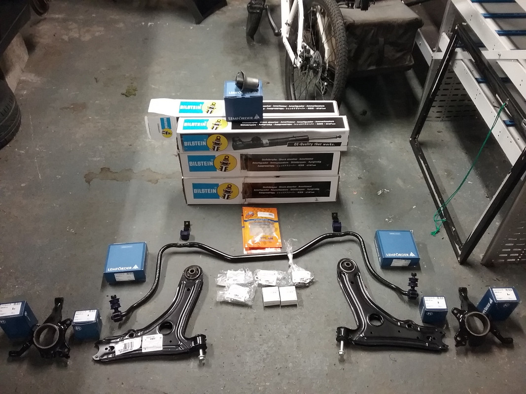

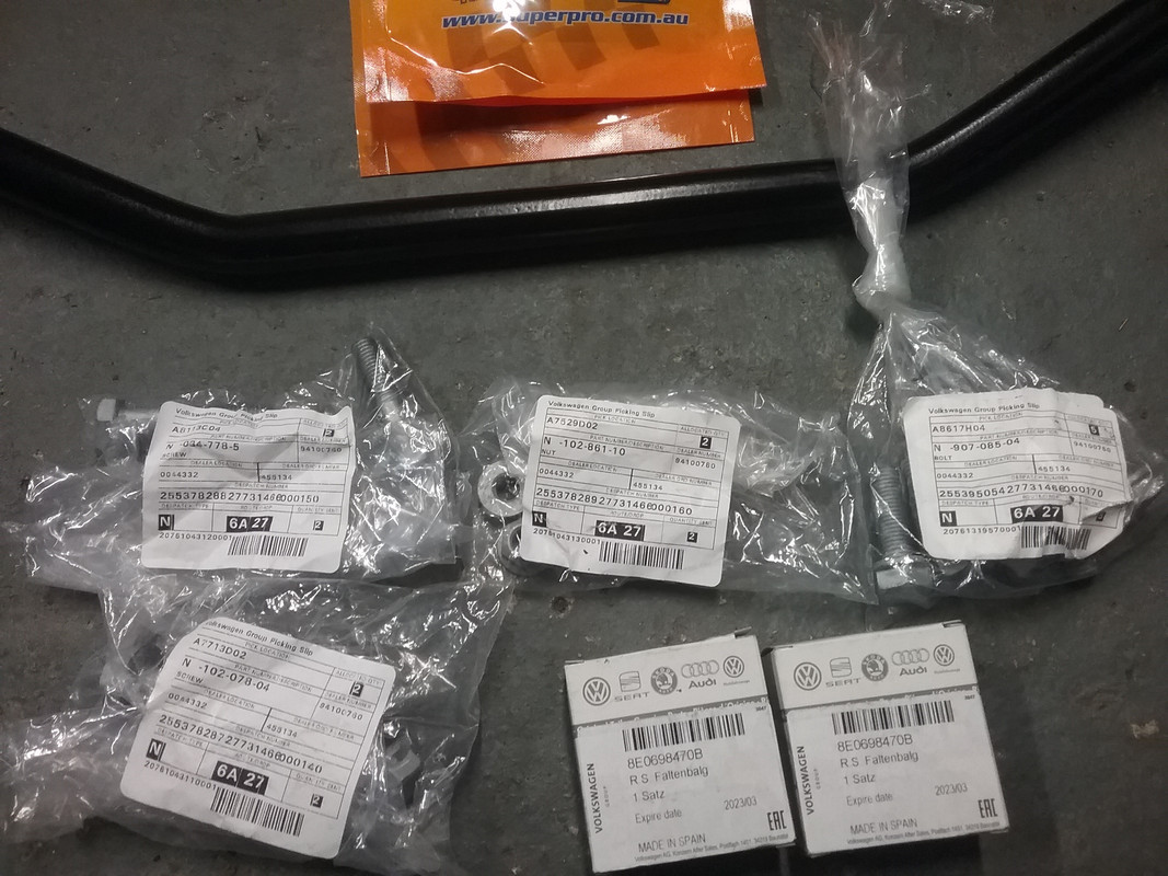

Brian1975 14 Posted September 20, 2018 Been gathering more parts for the suspension rebuild . Hubs stripped , blasted and powdercoated . Antiroll bar, rear clamps and front droplinks as above. Superpro antiroll bar bushing kit. New genuine wishbones. New top mounts , lower wishbone joints, track rod ends ,rear axle bushes. Bilstein B4 dampers. Selection of genuine bolts and fasteners. Still have a few parts on order so as soon as I have everything I need I'll start to strip the front end down . Quote Share this post Link to post Share on other sites
