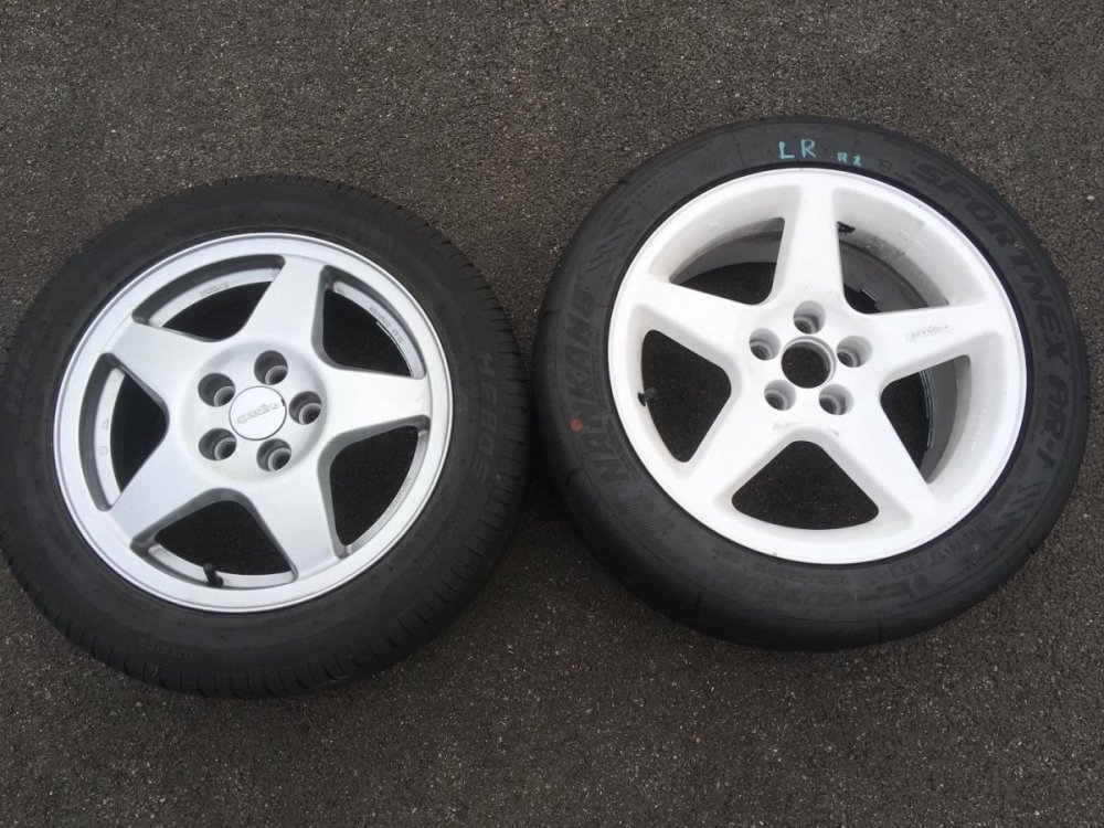

Keyo 47 Posted March 31, 2020 (edited) Comparing stock speedline 15 to the VW Motorsport Vento cups. The vento is a completely different alloy. The stock speedline the spokes go outwards from the rim to join the centre bore and have a central inner concave dome whereas the Vento the spokes are inverted from the rim to the centre of the alloy- completely different design these should not be described as speedline 16 . Vento does not have an inner rim like the 15 speedline either. Picture to illustrate differences. Edited March 31, 2020 by Keyo Quote Share this post Link to post Share on other sites

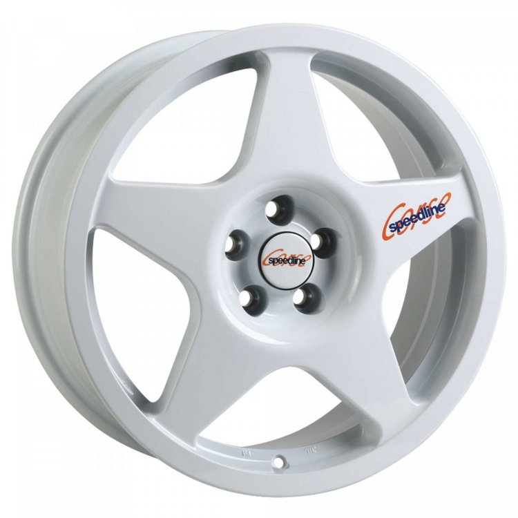

Keyo 47 Posted March 31, 2020 (edited) 21 minutes ago, tonedef said: If they’re not what you’re looking for, I’ve been after a set for years 😉 Nice try but no chance I luv them and they are rarer then a VSR manifold 😍 They truely are a unique alloy. Here are some Speedline Corse 2110 challenge, they come in a 17 5x100 - as you can see these are a larger corrado alloy but in white. https://www.demon-tweeks.com/speedline-corse-2110-challenge-alloy-wheels-in-white-set-of-4-2000798/?sku=S/LSL1430/X03/W1-KIT&istCompanyId=a2904180-3a7d-4e56-b876-cf81c9512180&istFeedId=0f6db192-3a9a-4369-b1f8-79615c622f96&istItemId=itlrrtiax&istBid=t&awaid=6538&utm_source=redbrain&utm_medium=shopping&utm_campaign=css&gclid=EAIaIQobChMInLaO56nF6AIVF5zVCh3mUAZcEAQYCCABEgJ22_D_BwE&source=aw&awc=6538_1585678801_4d9960af4136edc8ddf4868f932d48da Edited March 31, 2020 by Keyo Quote Share this post Link to post Share on other sites
tonedef 9 Posted March 31, 2020 2 hours ago, Keyo said: Nice try but no chance I luv them and they are rarer then a VSR manifold 😍 They truely are a unique alloy. Here are some Speedline Corse 2110 challenge, they come in a 17 5x100 - as you can see these are a larger corrado alloy but in white. https://www.demon-tweeks.com/speedline-corse-2110-challenge-alloy-wheels-in-white-set-of-4-2000798/?sku=S/LSL1430/X03/W1-KIT&istCompanyId=a2904180-3a7d-4e56-b876-cf81c9512180&istFeedId=0f6db192-3a9a-4369-b1f8-79615c622f96&istItemId=itlrrtiax&istBid=t&awaid=6538&utm_source=redbrain&utm_medium=shopping&utm_campaign=css&gclid=EAIaIQobChMInLaO56nF6AIVF5zVCh3mUAZcEAQYCCABEgJ22_D_BwE&source=aw&awc=6538_1585678801_4d9960af4136edc8ddf4868f932d48da Too right with the Ventos, they’re the perfect wheel for the Corrado. Shame the 16” 2110 doesn’t come in 5 x 100, I’ve had 17s in the past but would prefer 16s, better compromise for me. Quote Share this post Link to post Share on other sites
Keyo 47 Posted March 31, 2020 1 minute ago, tonedef said: Too right with the Ventos, they’re the perfect wheel for the Corrado. Shame the 16” 2110 doesn’t come in 5 x 100, I’ve had 17s in the past but would prefer 16s, better compromise for me. That would be my issue with them as well, also would want them silver and would be harsh to get a new set of alloys powder coated. Maybe its worth considering another group buy of 16 speedlines when all this turmoil passes. Quote Share this post Link to post Share on other sites

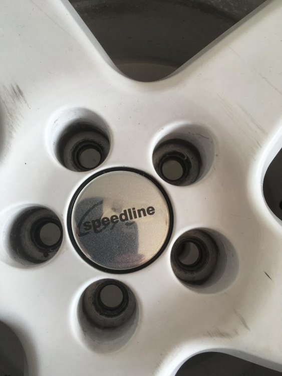

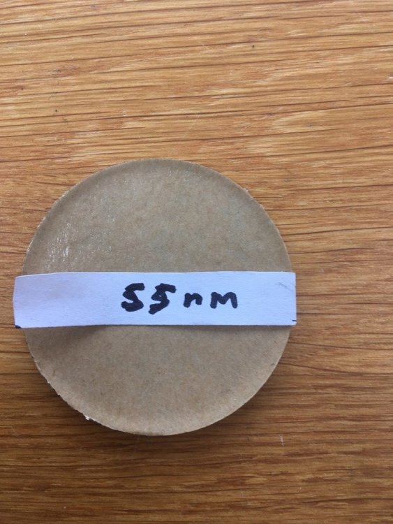

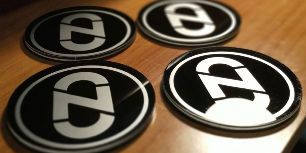

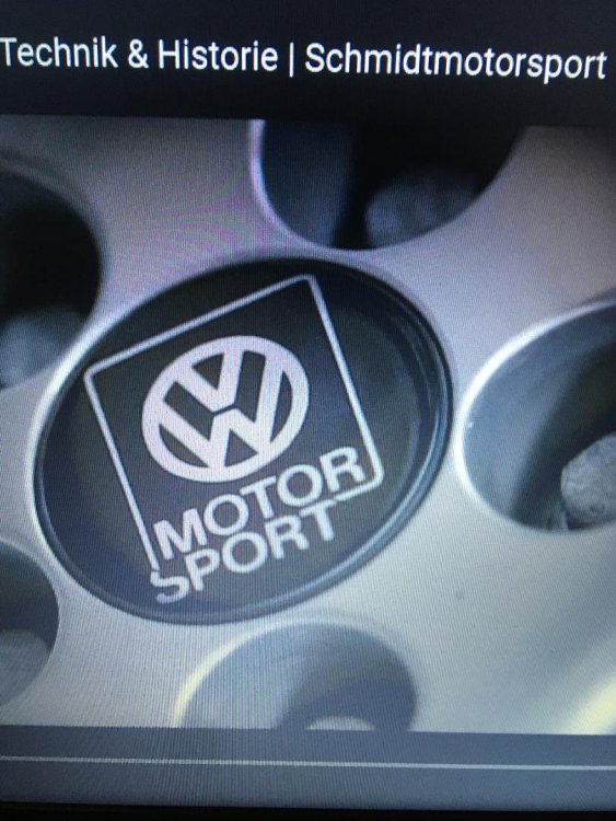

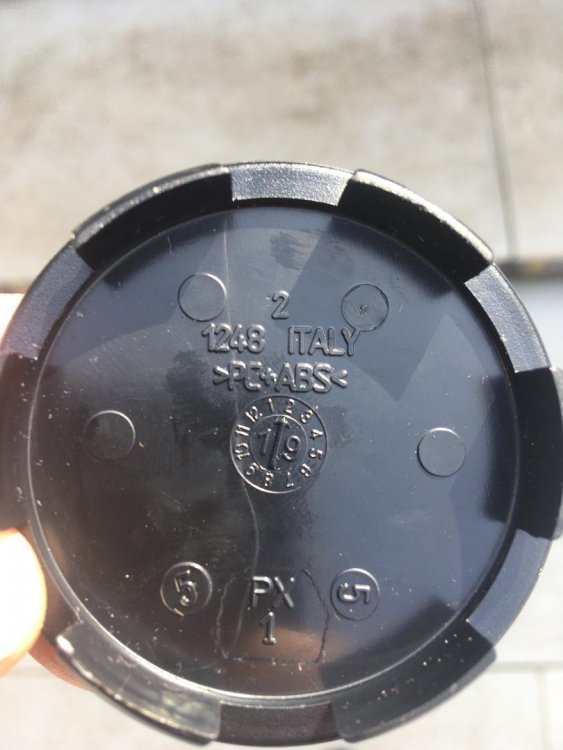

Keyo 47 Posted April 7, 2020 (edited) Been measuring the Vento cups up today for some centre caps. The stock speedlines are 58mm I believe and the Vento cups centre caps are 1-2mm wider diameter. I believe the centre caps from a Speedline Corse will fit and advertised as 59mm-60mm. Im going to test fit one. Link below https://www.ebay.co.uk/itm/SPEEDLINE-CORSE-ALLOY-WHEEL-SILVER-CENTRE-CAP-1-with-Plastic-Back-60mm/231871831681?epid=713262142&hash=item35fca35e81:g:JVMAAOSwu1VW4DwC Renwart will is making me some VW Motor Sport 3d printed Motor caps in black and light grey same a stock MK3 Rallye prototype that i will adhesive on to the corse speedline cap after testing fit. He has estimated between 30- 40 euro. Example of his work below and also a diagram of the Speedline corse centre cap.. Have asked Ren to make the decal 3d print in 55mm. to compensate for the diameter border. Also attached below picture of Motor Sport cap. Once made not sure whether to preserve them and only put them on for shows. Can be seen on video if freeze at 0.50/1 https://l.facebook.com/l.php?u=https%3A%2F%2Fyoutu.be%2FDzDaHAqAmSM%3Ffbclid%3DIwAR2aDUm_8-S8ik9dgrPu-W8U8C4TWINWFaB04t-U3La15ZfJAyezY2jk7l0&h=AT0UkukGhSPoBMhd-KyQIKzahLi8Md1U3x5LFJtqVINMz2kNnpY8I6FRk3Q7BS0_K3rcW1Jt9Y522d4av5Op756xDKZB-xDcKApG8iXRZ7Qr_YXrBEwRdBcAlXoxCgjesFLA Edited April 9, 2020 by Keyo Quote Share this post Link to post Share on other sites
fendervg 32 Posted April 7, 2020 Very nice. His badges are great quality. Quote Share this post Link to post Share on other sites
Keyo 47 Posted April 7, 2020 2 minutes ago, fendervg said: Very nice. His badges are great quality. He is a great source thank god he exists ha ! Quote Share this post Link to post Share on other sites

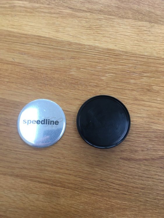

Keyo 47 Posted April 9, 2020 (edited) Ok test fitted the Speedline corse cap today and it is a 100 percent correct OE fit. The Motor sport decal will be made to 55mm and handy enough the caps come without the decal glued on so can save the original decals or sell them. Edited April 9, 2020 by Keyo Quote Share this post Link to post Share on other sites
