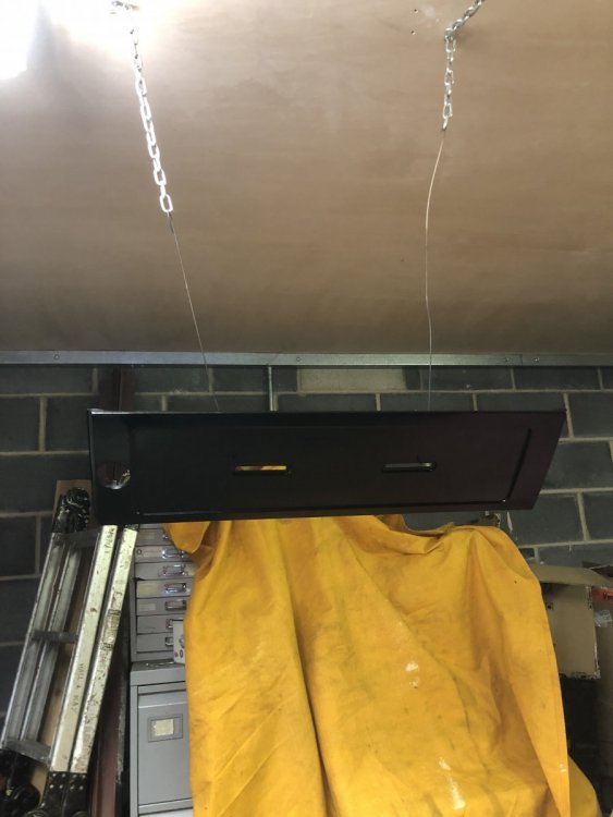

sorted the wiring and most stuff on the hatch just the lights, glass and plinth to go on. I had an old plinth in good condition I managed to get off one of many a hatch I’ve took home. Thought I’d give it a spray upside down, it came out really well with nothing able to use it as a landing pad, it’s now ready ready to go on but I’ll wait until I’ve stopped going in the back so much.

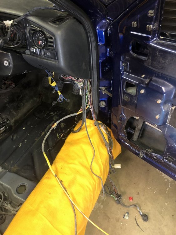

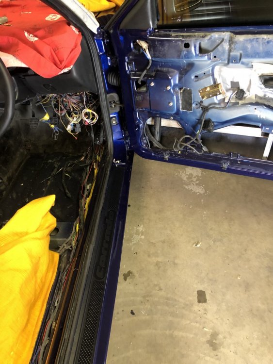

I put the wiring back in the drivers door after a bit or wrappIng repair.
It is possible to do this without taking any plugs off and pull the wires into the car and back the way they came out, either way it takes a while. Next up buff the roof and sunroof. Then put the sunroof back and so on.

Plinth looks good. Has it still got all the lugs on the back?!
Was that a special plastic paint you used? Was thinking of doing the front grill.
It’s got 3 of the 4 left, think I’m going to give each one a bit of glue anyway so they don’t brake off and it starts flapping about.
Body shop sprayed it first, don’t know what with, It looked a bit naf so I lightly sanded it with 1000 and sprayed it with Upol satin black. Nothing reacted, time will tell how long it stays on.
Front grill is a bit dodgey cause of all the bugs and crap hitting it.

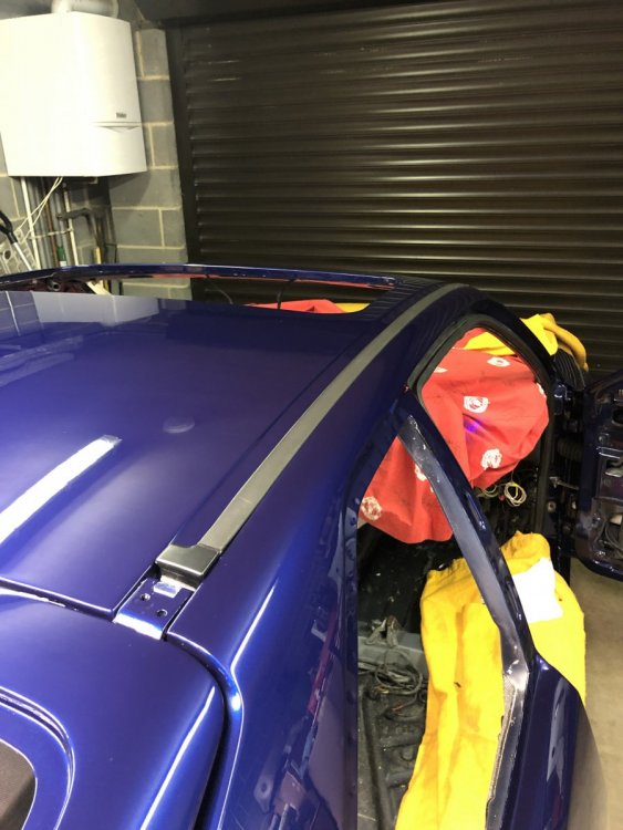

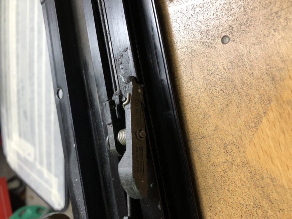

Put this gutter strip on yesterday as the first bit of rubber to go on. Bit of a faf and nerve racking. 0E471515-5D0B-4172-A27B-5796BDB4192F.thumb.jpeg.33fb41c97243fea3c17a8d821890383b.jpeg
Next up. Put some brood together. OMG.

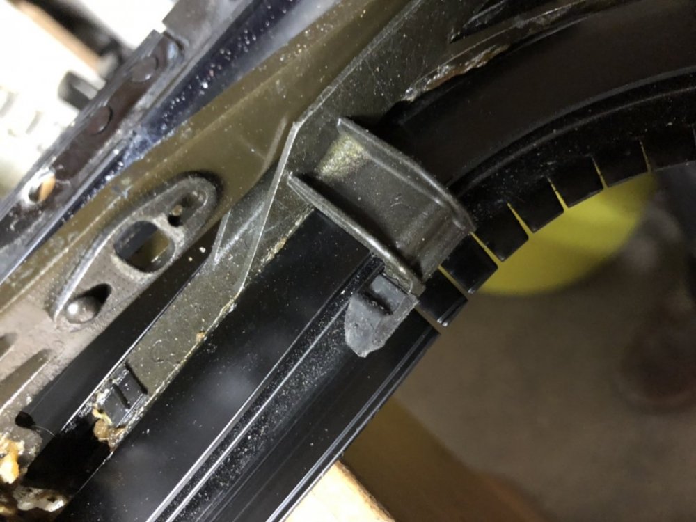

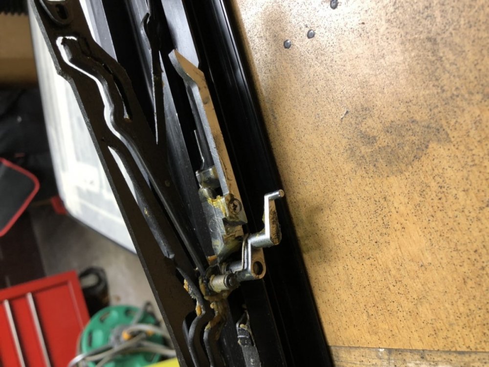

Decided for the best to have the cassette in the closed position and drop the lid onto that and then put the screws into that. Open it on full tilt, then replace the interior sunroof cover from the back. Make sure the interior panel goes over the hooks on the cassette or it won’t close fully with the roof panel and the rain gutter won’t line up properly. It need a good push from the back in the closed position.
What a lot of messing about. The sense of achievement when I got that set up and working was unrivalled, definitely deserves a beer going through that.

below the hooks the interior panel must go over to secure or brake loose567D622F-75E9-4527-A4F5-961DA3519215.thumb.jpeg.3d54aa3e15d868dbe14ee426fe5e87a3.jpeg

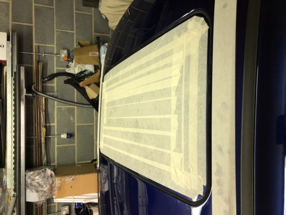

I’d advise anybody who’s fitting a new sunroof seal to get an old sunroof panel and run it around that first and then fit it to your sunroof panel.
You have to pull and push that hard to get it to fit properly that there is very large chance of damaging your sunroof panel. It fits a lot easier once it’s shaped.

Yes at it today,  been doing the drivers door and come in for a bit as I’ve lost a bolt and was going mad looking where I’ve put it. Just that bolt to put back and the kick plate and I can turn it around and start the other side.

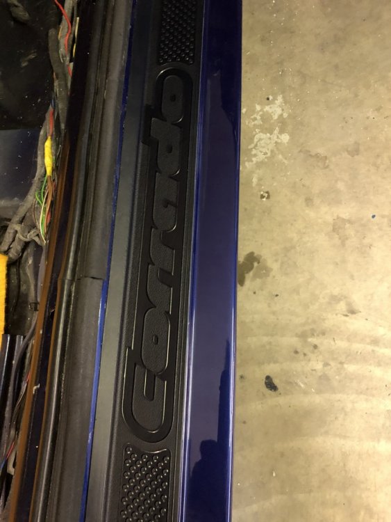

Can someone please post a pic of the rubber strip on the underside of the door just to make sure I fit it the right way round. Get that done and I can move on.
Fitted the kick plate off of Sprinter, very nice. 496A9573-4B7E-4636-AB86-9A75584D4168.thumb.jpeg.f88f6d078c93630736e85fc77ec20c1c.jpegE90576E5-5180-433B-A08D-3035B86ED577.thumb.jpeg.84d5763fa8fa09384c574d0fc18cdbd2.jpeg
6 minutes ago, Cressa said:
This do?
Thanks Cressa that’s it. I was right then but didn’t want to risk it. It looks like it should go that way because of how the flappy bit curves, but I’ve learnt to take nothing for granted with Corrado design 😂😂
