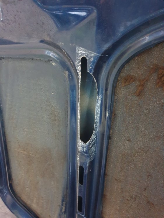

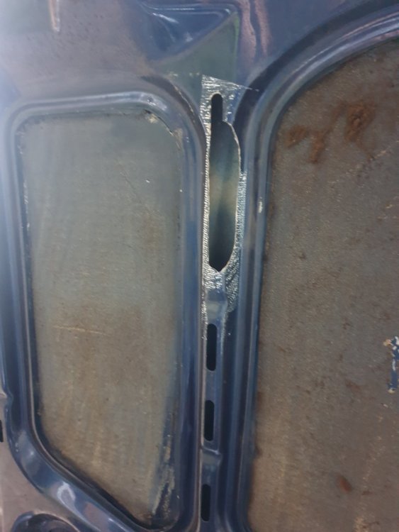

fla 9 Posted January 8, 2021 Sorry for the delay in sending pics of the bonnet rib cutout. The white is adhesive from the tape i used to cover it. I covered the area with masking tape, and cut through that as opposed to using the dremel directly. The bottom of the pics are towards the engine Quote Share this post Link to post Share on other sites
Cressa 45 Posted January 9, 2021 On 1/8/2021 at 2:31 PM, Dox said: If 118kw is at the wheels the above indicates a 32bhp loss over standard due to transmission losses which is about right I did those calcs and gained comfort from them, especially as the car does not feel sluggish or under powered. Thanks Dox for putting this stuff up. Fla great pictures, thank you. Quote Share this post Link to post Share on other sites

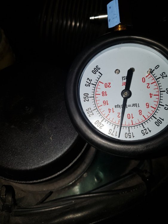

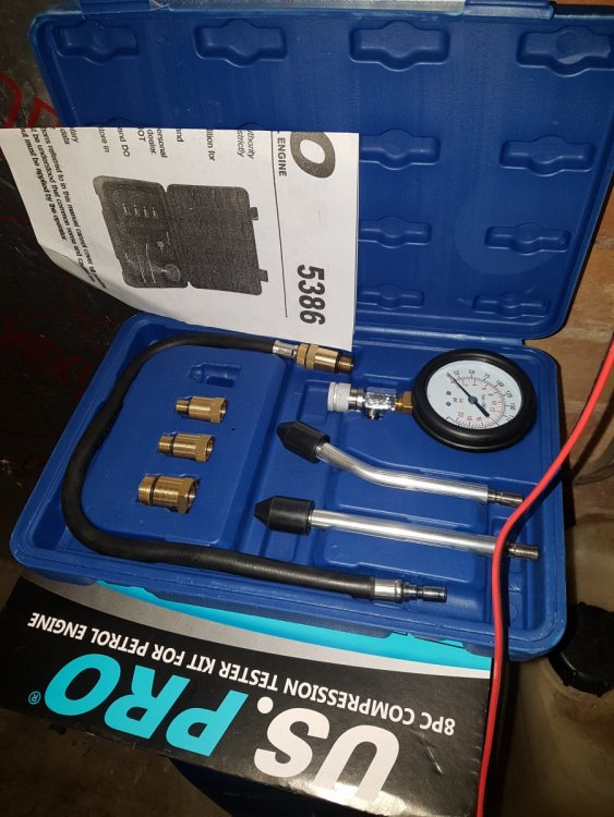

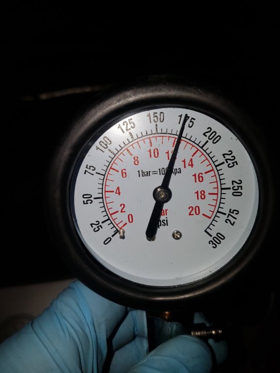

Cressa 45 Posted January 31, 2021 Took her out for a warm up today to enjoy the last day of her road tax 😊, then it was time for the compression test. I had purchased a cheap US pro kit which has lots of bits that I certainly did not need. The biggest worry was that the thread adaptor that goes on the end of the hose would get left behind in the cylinder head, damn that would be trouble, but all went surprisingly well. I had never this before, but removing all ignition leads, plugs and the fuel relay 167 was quick and easy enough. (Didnt do the crank sensor Dox, I totally forgot) Bloody immobiliser needs resetting everytime I switched the ignition off 😠 and first attempt I got Zero on the gauge !! Thankfully just a loose joint at the gauge. . Cylinder 1- 148 Cylinder 2 - 177 Cylinder 3 - 165 Cylinder 4 - 180 Cylinder 5 - 162 Cylinder 6 - 175 Quote Share this post Link to post Share on other sites

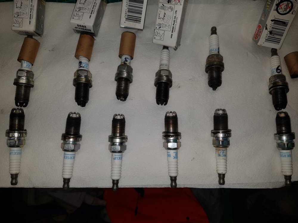

Cressa 45 Posted January 31, 2021 (edited) Now I'm not for 1 minute thinking those readings are accurate and the engine is mint, but she does pull well and does not smoke. The car is on 122,922 miles I think I have done towards 1k miles on the new plugs so I compared them to the old ones I removed And this is the tester I used Edited January 31, 2021 by Cressa Mileage addition Quote Share this post Link to post Share on other sites
seanl82 23 Posted January 31, 2021 Hope it is the gauge misreading, cylinder 1 is pretty low. Iirc, anything between 160-180 is within tolerance. Quote Share this post Link to post Share on other sites
Cressa 45 Posted January 31, 2021 On 1/31/2021 at 9:03 PM, seanl82 said: Hope it is the gauge misreading, cylinder 1 is pretty low. Iirc, anything between 160-180 is within tolerance. And I thought about 120 would have been good for an old engine 😄. Sean, i certainly am no expert at this and it was my 1st time. I had read that if within 20% then not to worry..... I was expecting 1 and 6 to be lower surprisingly.. Quote Share this post Link to post Share on other sites

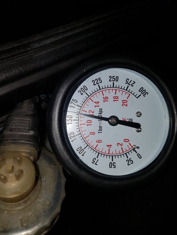

Cressa 45 Posted January 31, 2021 BOLLO#, just realised I didnt do it with the throttle open..... for ease I was turning the key through the open window. I may have to redo this now. I suppose it may be interesting to see if it differs. I may also have a Carbon clean, just to see if that makes a difference too..just a thought Quote Share this post Link to post Share on other sites
Dox 28 Posted January 31, 2021 How long was the car off the road for? How many miles since? I’d plan a road trip before I checked again and if I had those figures quoted I’d be more than happy with 25 year old engine? Quote Share this post Link to post Share on other sites
Cressa 45 Posted February 1, 2021 On 1/31/2021 at 11:13 PM, Dox said: How long was the car off the road for? How many miles since? I’d plan a road trip before I checked again and if I had those figures quoted I’d be more than happy with 25 year old engine? Was off the road for 5 years and has done just 800 miles since roadworthy. I will give it a roadtrip first . I dont know how well calibrated the gauge is , but I am happy with the results. Atleast it isnt on its arse thankfully Quote Share this post Link to post Share on other sites

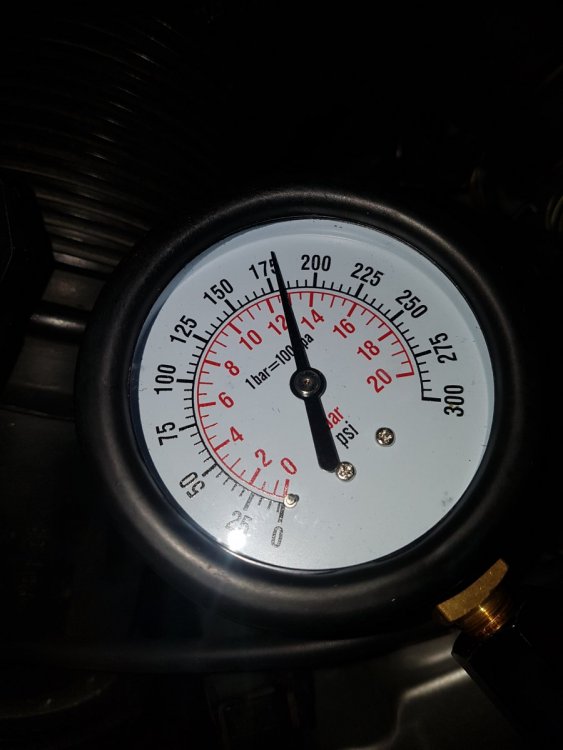

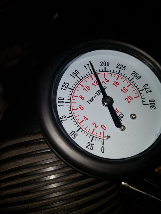

Cressa 45 Posted February 8, 2021 COMPRESSION UPDATE So I did the compression test again today, with the throttle fully open 1-175, 2- 177, 3 -175, 4-180, 5-173, 6-173 Zero miles since the last test. Latest figures in blue. Now I'm happy Quote Share this post Link to post Share on other sites
