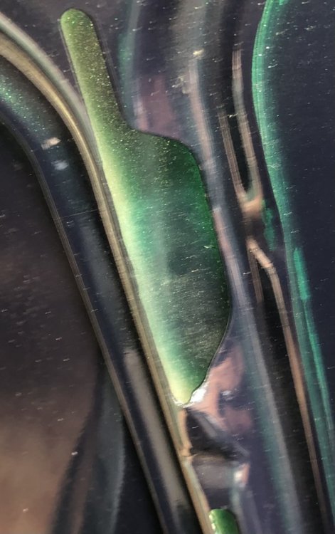

Cressa 45 Posted May 27, 2021 So I fitted a little sticker on the slam panel where the bonnet support hits and was marking my paintwork... no end to my skills today 🙄😁 Quote Share this post Link to post Share on other sites

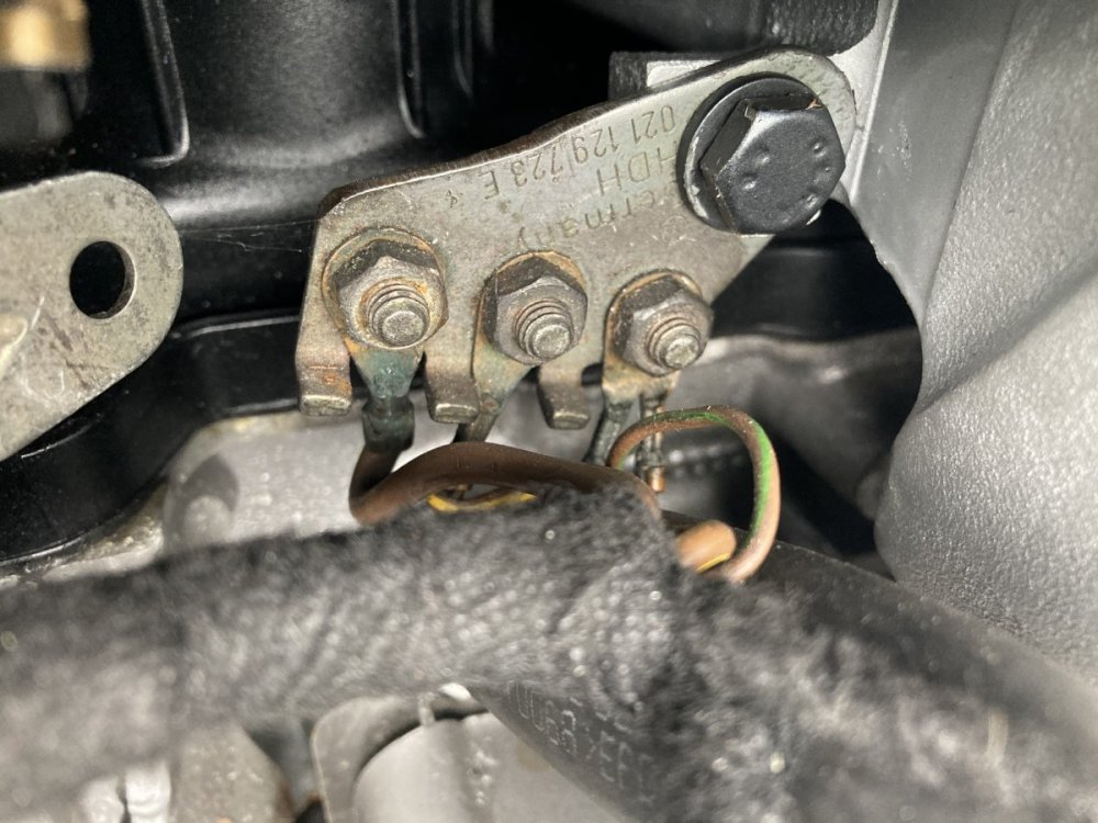

Cressa 45 Posted May 28, 2021 So I had a go at fitting the Schrick manifold that I have had for 2 years.... Maybe I should have done it when the front of the car was off as it would have been sooooo much easier. But not impossible with the slam panel in the way !! I had read that the RH rear bracket has to be removed and this has 3 wires grounded on it. I decided to add a bracket to enable this to be kept around that area, but it does leave the RH rear without a bracket. Maybe I will fabricate something up for that later The dipstick really needs standing 10mm off of the block to clear the manifold. Yet to do... It also just touches the top radiator plastic trim panel, so I will cut a clearance around this I did fit the recommended rubber air hose from the MAF sensor and that sits nicely. I also have the small vacuum elbow for the top of the manifold. Just waiting for the RH plastic lead trim cover to dry as I gave it a coat of paint earlier. A couple of things that bother me are that the accelerator cable wants to naturally run over the oil cap, so looks daft. And... the actual manifold really does sit HIGH in the front LH corner. I know this bonnet area needs cutting, but crikey it looks like I need a hole in the bonnet. It had better be worth all of this effort, as I actually prefer how the original manifold looks. Mind you, keyo,'s VSR really is how they all should have been Quote Share this post Link to post Share on other sites

Keyo 47 Posted May 28, 2021 1 hour ago, Cressa said: So I had a go at fitting the Schrick manifold that I have had for 2 years.... Maybe I should have done it when the front of the car was off as it would have been sooooo much easier. But not impossible with the slam panel in the way !! I had read that the RH rear bracket has to be removed and this has 3 wires grounded on it. I decided to add a bracket to enable this to be kept around that area, but it does leave the RH rear without a bracket. Maybe I will fabricate something up for that later The dipstick really needs standing 10mm off of the block to clear the manifold. Yet to do... It also just touches the top radiator plastic trim panel, so I will cut a clearance around this I did fit the recommended rubber air hose from the MAF sensor and that sits nicely. I also have the small vacuum elbow for the top of the manifold. Just waiting for the RH plastic lead trim cover to dry as I gave it a coat of paint earlier. A couple of things that bother me are that the accelerator cable wants to naturally run over the oil cap, so looks daft. And... the actual manifold really does sit HIGH in the front LH corner. I know this bonnet area needs cutting, but crikey it looks like I need a hole in the bonnet. It had better be worth all of this effort, as I actually prefer how the original manifold looks. Mind you, keyo,'s VSR really is how they all should have been Cool mate looks damn good in there . Have you got a picture of the rhd bracket . thanks Quote Share this post Link to post Share on other sites
Keyo 47 Posted May 29, 2021 (edited) Is this the rhd bracket your on about - the other end has a clip on it for fuel hoses . I didn’t have one on the Schrick but the vsr has a housing thread for the bracket . Jacking the engine up can make life easy mate for fitting. The late plastic intake boot fits fine with a schrick mate - you only need the early flexi with a VSR, The VSR also looks slants downwards- this is fro the block oil lubrication though I have been told. Wondered why my rad trim had a piece cut out . Edited May 29, 2021 by Keyo Quote Share this post Link to post Share on other sites

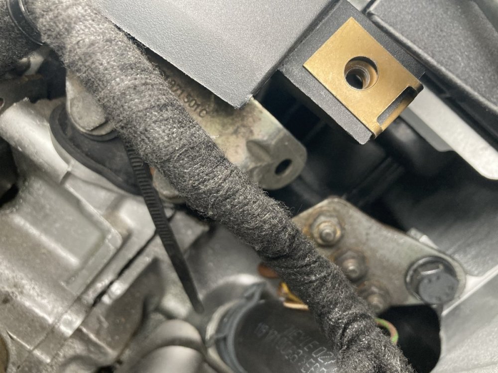

Cressa 45 Posted May 29, 2021 This bracket. Part number on it for you 👍 Quote Share this post Link to post Share on other sites

Keyo 47 Posted May 29, 2021 (edited) 1 hour ago, Cressa said: This bracket. Part number on it for you 👍 Thanks - does the bracket come apart - I think I just have the cable earthing plate part bolted to my block . Will check later but I reckon the bracket was cut when the schrick was fitted. thanks Edited May 29, 2021 by Keyo Quote Share this post Link to post Share on other sites
Keyo 47 Posted May 29, 2021 (edited) 1 hour ago, Cressa said: This bracket. Part number on it for you 👍 Looks like mine was cut up when Schrick fitted Cressa ? I would say the bracket would fit a vsr mate by the looks of it ? Edited May 29, 2021 by Keyo Quote Share this post Link to post Share on other sites
Cressa 45 Posted May 29, 2021 If VW went to all the trouble making the VSR, I am pretty sure they would have a bracket on that right hand side. Be worth getting hold of one to see Quote Share this post Link to post Share on other sites

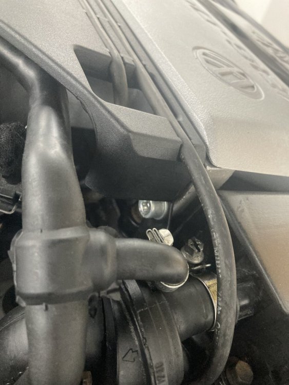

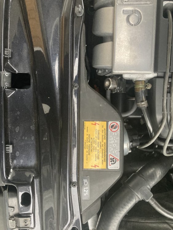

Cressa 45 Posted May 29, 2021 (edited) Finished the main install. Cut the radiator trim, fitted the dipstick to stand further off the block and connected in the hoses which I had previously done. Just need to tighten one bolt when I do the front engine mount. Fla, hopefully thanks to a tyrap the acc accelerator cable looks slightly better now. Started fine but I could hear a faint hissing and thought it was the reservoir. Eventually found it was just the main vac line connection that I had not put on!!! Pillock. Better pic of the RH bracket that I fitted to an elbow bracket to keep it all together And it works, well moves the flap, but maybe at 4100 revs, not the 4k. So perhaps need to adjust that bit. Next up one day..... swap over the front engine mount to the Vibra- technica fast road one, Then Bonnet cut 😟 Watch this space... Edited May 29, 2021 by Cressa Spellcheck Quote Share this post Link to post Share on other sites
tonedef 9 Posted May 29, 2021 31 minutes ago, Cressa said: Finished the main install. Cut the radiator trim, fitted the dipstick to stand further off the block and connected in the hoses which I had previously done. Just need to tighten one bolt when I do the front engine mount. Fla, hopefully thanks to a tyrap the acc accelerator cable looks slightly better now. Started fine but I could hear a faint hissing and thought it was the reservoir. Eventually found it was just the main vac line connection that I had not put on!!! Pillock. Better pack of the RH bracket that I fitted to an elbow bracket to keep it all together And it works, well moves the flap, but maybe at 4100 revs, not the 4k. So perhaps need to adjust that bit. Next up one day..... swap over the front engine mount to the Vibra- technica fast road one, Then Bonnet cut 😟 Watch this space... I love the look of the Schrick in there, wish I’d held out for an OBD2 elbow at the time instead of flogging mine! Mine also sat quite high on the left, I always thought it was the length of the Jay Renshaw rear mount but maybe it’s normal. My cutout looks like this: Quote Share this post Link to post Share on other sites
Cressa 45 Posted May 29, 2021 Thanks for the pic Tonedef, seems quite straight forward. I'm still trying to decide on what is best to cut it with too. Hopefully I will get a proper look at the bonnet Shaun has taken off his money pit which also has the cut in. Lockdown seems less restrictive, so we need a car chat and coffee. Well when mine is back roadworthy and my leg is better Quote Share this post Link to post Share on other sites
tonedef 9 Posted May 29, 2021 53 minutes ago, Cressa said: Thanks for the pic Tonedef, seems quite straight forward. I'm still trying to decide on what is best to cut it with too. Hopefully I will get a proper look at the bonnet Shaun has taken off his money pit which also has the cut in. Lockdown seems less restrictive, so we need a car chat and coffee. Well when mine is back roadworthy and my leg is better I cut mine with the die grinder...I’ve got the grinder but the compressor croaked and I haven’t replaced it yet or I’d offer that. I’m promising to tax mine 1st June so I’ll be commuting in it if there are any good days, could probably shoot over to yours from the office if you’re around. Quote Share this post Link to post Share on other sites
