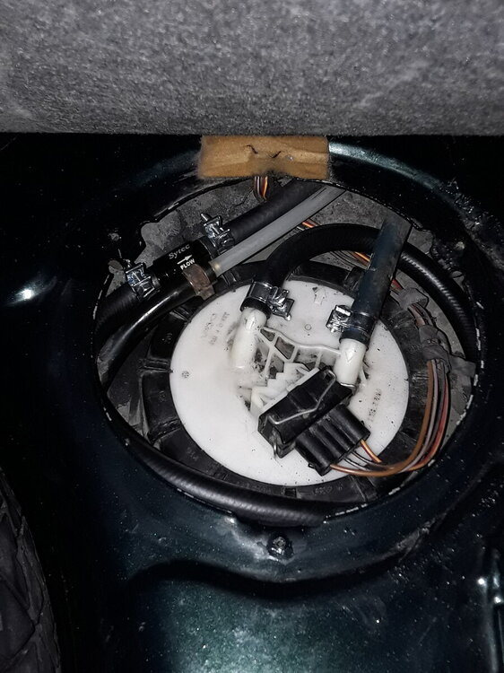

Cressa 46 Posted August 21, 2022 Bad running update. I have changed the camshaft sensor for a genuine item, but couldn't try it until today due to the fuel pump debacle. Well as I had an hour, I swapped the level sender onto the new Lucas item and fitted it back in the tank and connected in the inline one way valve to. Started her up, and she is still running badly.... Hopefully as mentioned it will be the Crankshaft sensor that I shall change tomorrow. From Classic parts and was delivered in la week, happy with that But if that doesn't cure it..... I will be annoyed 🤬😁 Quote Share this post Link to post Share on other sites
Dox 30 Posted August 21, 2022 Confused with the NRV, can you post a wider angle pic? Quote Share this post Link to post Share on other sites

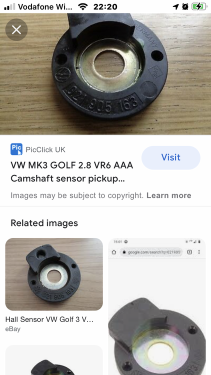

Keyo 49 Posted August 21, 2022 (edited) There is also a circular sensor actually attached to the camshaft - it’s obsolete - it’s circular and working in tandem with the sensor I believe . like this Edited August 21, 2022 by Keyo Quote Share this post Link to post Share on other sites

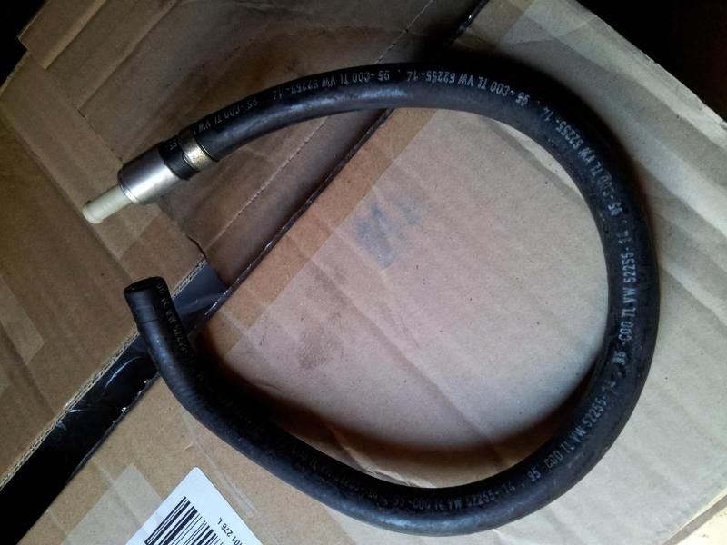

fendervg 33 Posted August 22, 2022 On 8/21/2022 at 9:14 PM, Dox said: Confused with the NRV, can you post a wider angle pic? It goes on the fuel feed line to the engine to stop the loss of residual pressure down the line back into the pump. It can be a bit hard to make out from the photos, I'll see if I can fine a picture from when I did it. Quote Share this post Link to post Share on other sites
fendervg 33 Posted August 22, 2022 (edited) Not great resolution, but black is to the engine and blue is the return - the valve is fitted with an extra bith of hose that curves around the lid and then connects to the OUT. This picture was the now discontinued official VW "fix" for fuel pump leakdown: unfortunately that's all I seem to have on it - the original thread with the dealer bulletin seems to be long gone, but the NRV part definitely looks more OEM. Edited August 22, 2022 by fendervg Quote Share this post Link to post Share on other sites
Dox 30 Posted August 22, 2022 (edited) On 8/22/2022 at 9:36 AM, fendervg said: Not great resolution, but black is to the engine and blue is the return - the valve is fitted with an extra bith of hose that curves around the lid and then connects to the OUT. This picture was the now discontinued official VW "fix" for fuel pump leakdown: unfortunately that's all I seem to have on it - the original thread with the dealer bulletin seems to be long gone, but the NRV part definitely looks more OEM. Cressas appears to be backwards, the arrow on the NRV is pointing against the flow? If the pipe wraps around the tank like yours it's is correct, I imagined it looped anti clock and the arrow on the NRV would then be the wrong direction. Edited August 22, 2022 by Dox Quote Share this post Link to post Share on other sites
fendervg 33 Posted August 22, 2022 (edited) Possible - hard to tell, I think it is right provided the upper black hose on the right goes to the fuel filter and then the black feed pipe, but depends on how the extra length of hose has been looped and routed. With it the wrong way around I would think you would have a no start situation and no fuel flowing past where the valve is. A bigger picture would help. Some better pictures in this thread: https://the-corrado.net/topic/86717-one-way-valve-on-fuel-pumppipes/ Thing is in this one, a faulty CPS was the culprit - not necessarily broken, but an intermittent or weak signal, and this can play havoc with the fueling as the CPS tells the fuel pump relay when to run the pump once it detects the engine turning. My guess here is that replacing the CPS will solve it, and cold starts after sitting for a while will be improved by the non return valve - fingers crossed! Edited August 22, 2022 by fendervg Quote Share this post Link to post Share on other sites

Cressa 46 Posted August 22, 2022 Update time.... been a busy day Hopefully this shows it better Dox. I can assure you it is on the pressure side. I disconnected the black pipe, put the NRV on and got some Keyo recommended fuel pipe to link the tank connection looped round the the valve ( would have been a good shout if it didn't start ) As it was still poor running I managed to fit the Crankshaft sensor. Damn the electrical plug is a swine to get to... Started her up and she still wasnt brilliant so I also did a bit of a stationary ecu result holding the revs 1k high each time then back down again and now she is happy. I've ran her up to 120° on the oil temp and she starts warm, the best ever I will try again later and post up the starting. What I can not do is specifically say that one item has solved this. Okay the crankshaft sensor made it better, but was that because of my attempted ecu reset too. Is the warm start better because of the non return valve, as fendervg has said about the VW fix Is it the new 4 bar swirlpot that i fitted.... only a Lucas item 1H0906091Q cheap but quality and a perfect fit too. Maybe one day I will get the VDO item but I will see how this behaves. It's nice to know that the Q version fits our tanks identically. I Still have something else to look at in the engine, but for now I am having a deserved cuppa to celebrate her running with thanks to all of us forum members Quote Share this post Link to post Share on other sites
