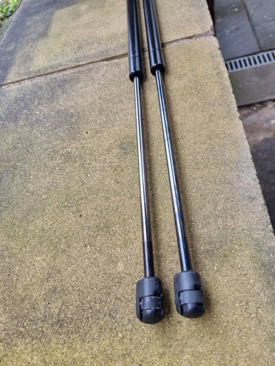

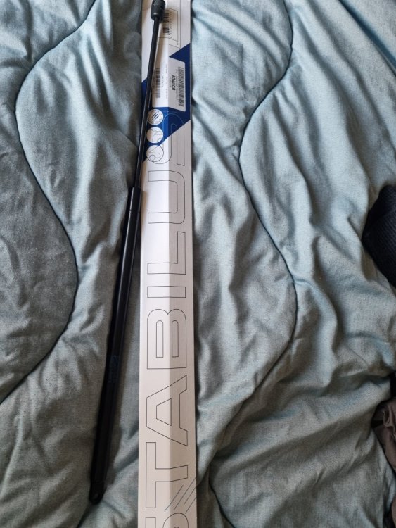

Cressa 45 Posted December 25, 2024 Santa brought me some tailgate struts. I read somewhere these are possibly the oe supplier. They look the part anyway. Next job is to fit then, so I shall post up when done. I may still get the originals refurbished, which was my original plan Quote Share this post Link to post Share on other sites
Cressa 45 Posted December 26, 2024 (edited) Boxing day, but let's not waste time. I swapped over the tailgate struts and I am happy with their power. A quick job that only left me with a missing circlip as it pinged off th the back of the garage into a pile of junk. I'd rather get a replacement than spend 3hrs looking through that mess. And I also found my tailgate popper was broken 😢 Very disappointed with that. The search begins..... so if anyone can help, please shout up 👍 Edited December 26, 2024 by Cressa Quote Share this post Link to post Share on other sites
