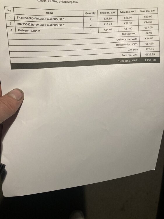

peterpp 11 Posted May 8, 2022 (edited) A couple of other things I could use some advice on. I have purchased 2 pairs of Audi TT Wiper Arms as I believe I need to fit 2 x drivers side arms - what blades should I buy? Also the MOT had an advisory for the bonnet insulation which is starting to flake quite badly. I have read some poor reviews for the kit supplied by heritage, what is the current recommendation? Edited May 8, 2022 by peterpp Quote Share this post Link to post Share on other sites
seanl82 23 Posted May 8, 2022 Those reflectors look great, good to see they've stood the test of time. As far as blades go, I can't remember I've got a feeling it's 19" & 17" blades that you need. If you offer up your originals, you'll see how the sweep is and you should be able to tell what you need. As long as they don't foul the seal when vertical you'll be good. Quote Share this post Link to post Share on other sites
1xshaunx1 27 Posted May 8, 2022 The bonnet foam from sprinter on the this forum is as Oe as you will get Quote Share this post Link to post Share on other sites
Keyo 49 Posted May 8, 2022 (edited) Heritage stuff is an abomination does not represent the stock foam at all - its like a gimps mask. Sprinter stuff is the best quality and the most expensive and shipped from Germany. Dreadnought Im very happy with and good price - does late and early options. https://dreadnoughtcustoms.co.uk/products/vw-corrado-bonnet-lining-2 Attached picture of what i got from audi . Edited May 8, 2022 by Keyo Quote Share this post Link to post Share on other sites
