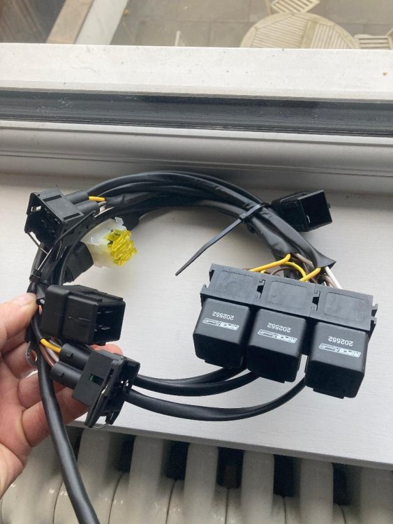

Keyo 47 Posted December 11, 2020 (edited) Lovely Bubbly for those that cant wait. Sure the horror stories and photos that I have seen from the Mk2 of fires been caused by the DDR Im not risking it- in the Mk2 though where it is located it is liable for the cable of the dim to rub on the chassis leg. Edited December 11, 2020 by Keyo Quote Share this post Link to post Share on other sites

fendervg 33 Posted December 11, 2020 They look great and well made - waiting on delivery with excitement! Pretty much any uprated loom needs to have the dim dip resistor disconnected, otherwise the full low beam will come on with the switch on sidelights only, as there will be enough current to trip the relays. Quote Share this post Link to post Share on other sites
Dox 23 Posted December 11, 2020 If you plug in dim dip resistor you’ll only get side lights with ignition off, once you turn the key dipped beam will illuminate, so a possible mot failure Quote Share this post Link to post Share on other sites

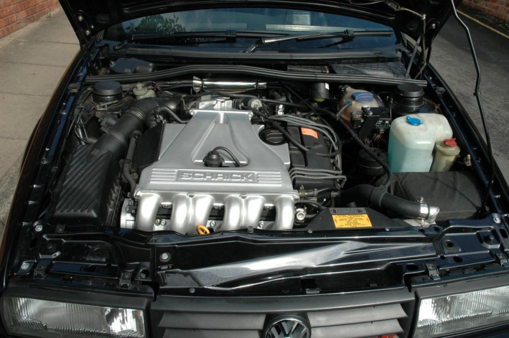

fendervg 33 Posted December 12, 2020 Any electronics/electric supply store (try Radionics, Maplins now gone) will have something suitable. Some even have an opening for the wiring to go through, with a bushed screw type fitting to hold them in place and sealed. I'll take a picture of the one I have on my car the next time the bonnet is open - this is the best pic I have of it before fitting, years old - this was a "hybrid" loom made using OEM connectors, waterproof box and extra insulation, with an eBay bought loom as a starting point: I guess there's lots of ways to do it - some of those marine relay enclosures look very suitable, or there is plenty of heavy duty mil spec vehicle electrics stuff around. I think this is one of the reasons why the quality looms with decent gauge wiring, proper wrapping and insulation, OE connectors and weatherproof enclosures are much more expensive - then there is number of relays. Quote Share this post Link to post Share on other sites
