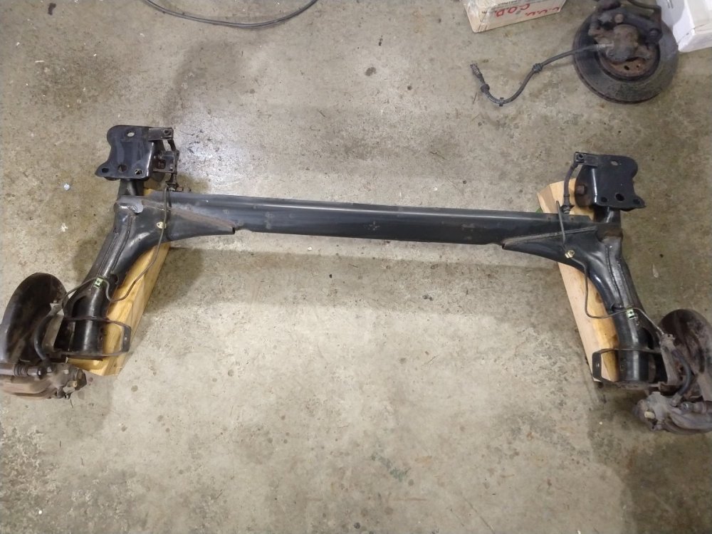

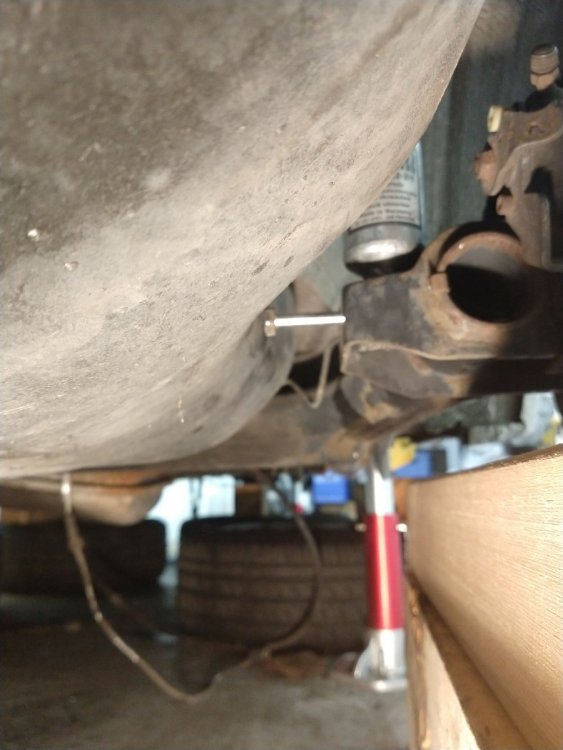

ABV-VR6 12 Posted December 28, 2020 Well, I got it out thanks mates. I did has suggested, jack under the beam, a few 4x4 where the brakes are to minimize the drop. I attached the proportioning valve to the frame to make sure it was out of the way when the beam was going down. Only surprise is the rear shock bolt. The one by the exhaust, I could move the exhaust and get the bolt out but the one by the gas tank is a different story. So the other for the bolts order it's best to do the 4 at the front, one shock muffler side, then remaining 2 at the front (make sure the jack is touching with no pressure) then you can move the beam sideways to get the remaining gas tank side shock bolt. Cheers! Quote Share this post Link to post Share on other sites
ABV-VR6 12 Posted December 28, 2020 This is the only part that shows rust on the car, I'm stripping it all out fir powder coating. Quote Share this post Link to post Share on other sites
